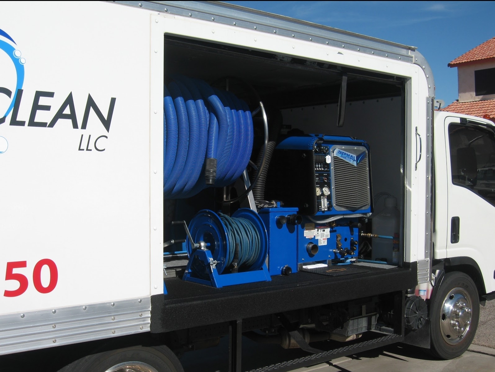

Everyone kept saying how complacated the machine was.... My 570 was way more complacated to work on... And we had pretty much just gave up on that therm valve...........We ran a A. P. O. on all the jobs so we just let it go... Everytime we replaced it.. That water box would just burn it out... It was always blowing fuses on the automatic hose reel or A. P. O.. and shorting out a float valve now and then.. ... That Thermalwave... It didn't matter how hard you ran it... It just kept going....very easy to service.. Lots of space to get to anything and work on it... Shame they stopped making them...

I got the sapphire thermal valve the goes at the top relieve pressure in the water box, and last way longer just replace oring when it starts to leak.
4900 hours still works great had to replace a Mac valve but thats it.
Sounds like minor issues so far. Switches can fail or clog. Loose nuts and bolts need to be addressed but sounds like a decent machine.
exactly what I thought
I’d be far less concerned about a float switch and a finicky power reel button than the LOOSE installation hardware
if these guys can’t ratchet down the bolts, what else is not double checked before delivery?
