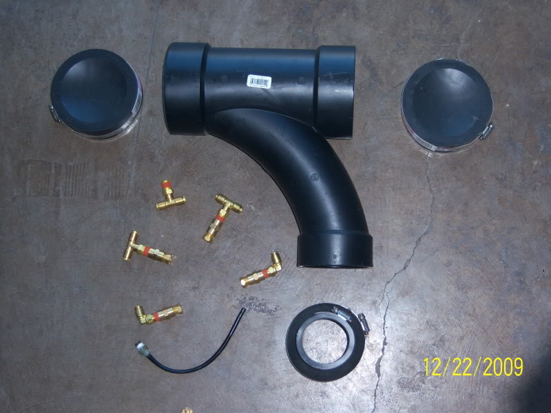

I made my own with some scrap pvc years ago. i used to clean a bar monthly and the hose was to trashed to take into a home after. it works great.

Thanks Gene. I think I'm over thinking it with using 4jets. I was going to use this.

I got ya. Thanks for the pics again. I also wanted to try and make mines friendly to 2.5" hose even though I don't have any yet. Jus cuz though..... :lol:

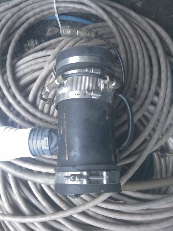

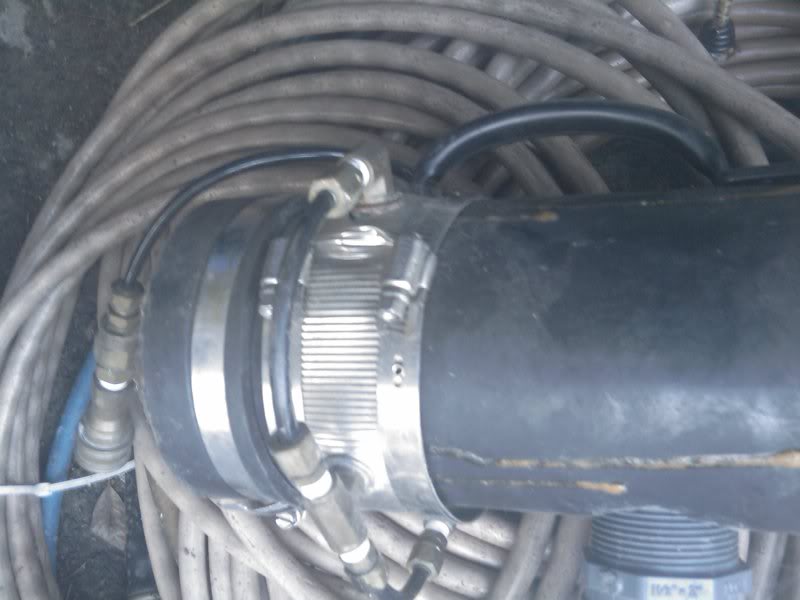

I sent a sketch to Hydramaster a few years back about an idea I had, thought they could build it. They didn't want to. Odd thing, the Hoser turned up about 6mths later almost identical, except that the guy didn't know how to place the jets. He put them on the inside. I bought one and modified it so the jets are flush with the pipe. Also, I would have used a natural 4" ABS fitting with a 2" elbow into which the 2" barb could have been easily fit without drilling.
Here's the mods.
All I need to do with this is open up the end holes and 2.5 will easily fit in. If I took the end caps off I could run 3" through it.
