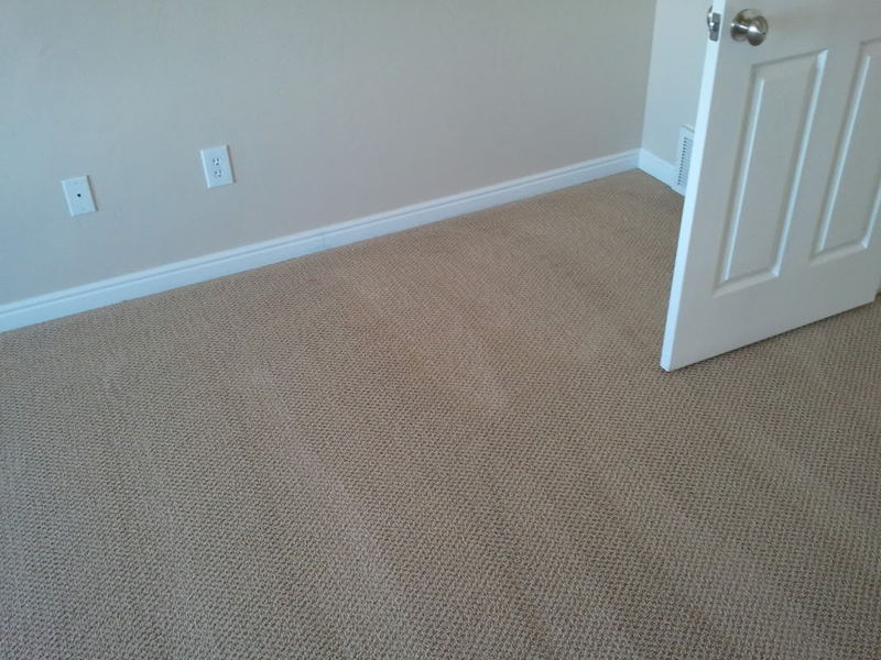

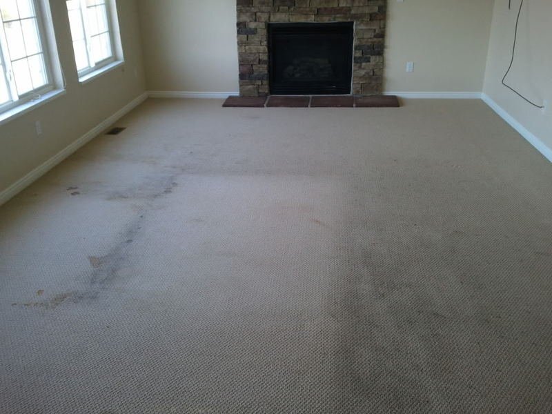

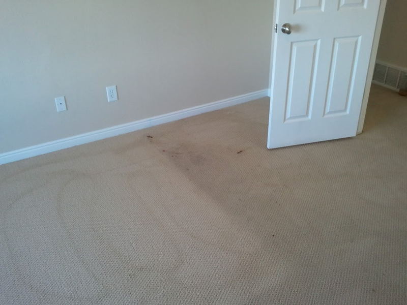

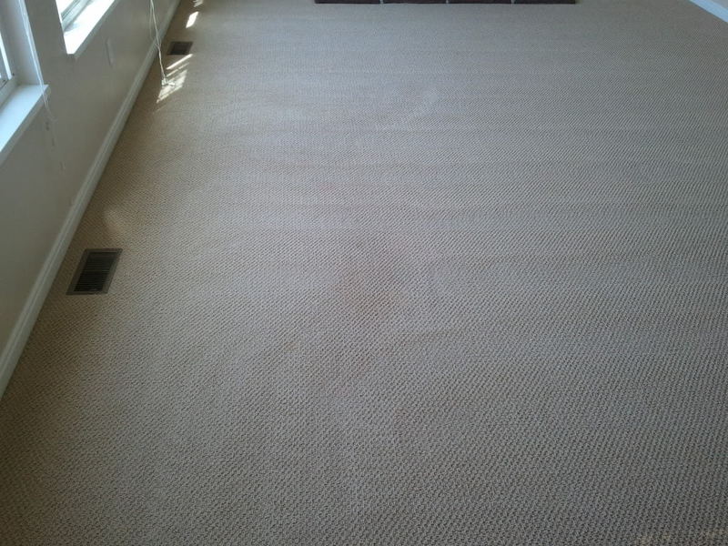

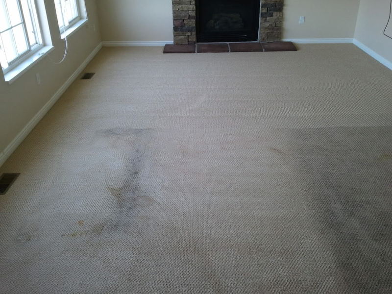

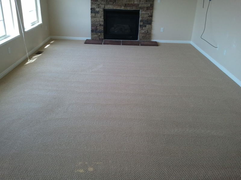

holy chit... I agree with John :shock: :shock: :shock: :shock: :shock: :lol: :lol: :lol: :lol: :lol:
Now that i can enjoy both....i see the HUGE benefits of both....here is a house i just did...Saved them 1000s.....4 yr old carpet (2.5 really because its been vacant. but TRASHED)
6 oz a gallon of Cobbs Power max.....95% of the spots/stains came out...with just Cobbs....And no i still dont fart around with the reds and yellows...besides they lightened like crazy
Family Room.....she thought for sure it was going to need replaced.....they showed up just as i was starting this....and their eyes all but popped out
pretty swirly's why take them out????
oh Freshy water rinse to 8) 8) 8) 8) 8)

hummmm fixing the size issues on my photobucket acct
why is that before pic not coming in at the bigger size????

Doug, top quality work.
You're a credit to the industry, includin' the Nebraskee Neddies and the 'Bama Boys. shiteatinggrin
