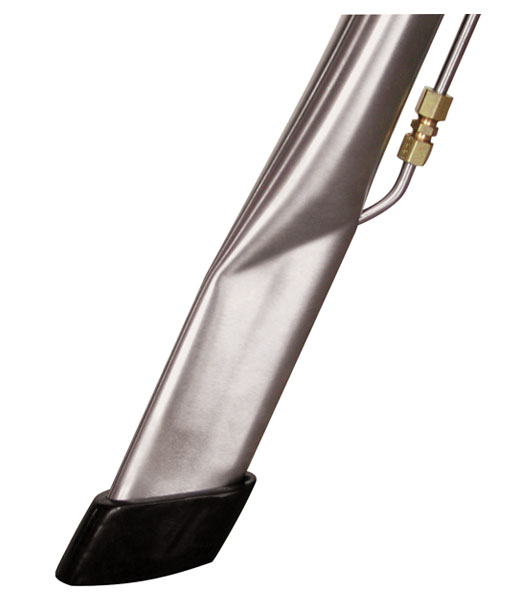

-Don't get me started on this POS:
91602
Seems like the answer to all of your problems for tile & grout and filtration soil edging but spray pattern is SUPER uneven leading to issues, and yeah, maybe the valve can handle 1250 psi, but the dang thing won't physically trigger if you're over 500, so have fun running back and forth to the van 14 times every tile job.
Phew... again, I don't want to disparage anybody. I know we're mostly just good people trying to do our jobs. I hope they get this hard surface wand right. I will be first in line to buy one.
