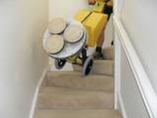

Get or make a ramp.
Some people just have to Do it the hard way.
Get yourself a pair of telescopic aluminum ramps.
I have had a pair for several years with no problem putting the Cimex in or out of my van & I weigh in at about 235lb.
Photo down below taken over five years ago.

Some people won't learn -Learn how to take the Cimex up & down stairs easily, even those with a 9- degree bend at the bottom or top or both. Crikey, if I can do it..................................... GET RAMPS. Check out the 12 year old photo below.

Once more I disagree, one should learn how to maneuver up & down stairs
