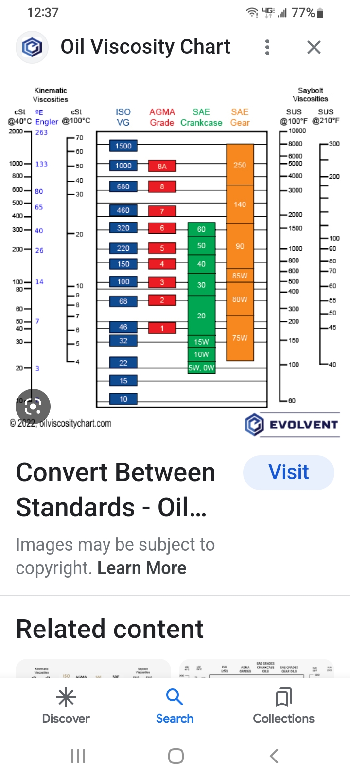

When giving advice i try to lose as much techno mombo jumbo as possible to get the information across and sometimes i dilute it too far. For those techmo geeks this one's for you

According to Dwain's chart, Amsoil Severe Gear SAE250 is too heavy. I would just order some Aeon, but it appears my distributor is closed for the holidays, as is PD Blowers.
I have some Amsoil Severe Gear 75W-90, which is too light.
Will try mixing 250 with 75W-90 for now. Or pick up some quality SAE 90 gear oil.
Thanks, Dwain!

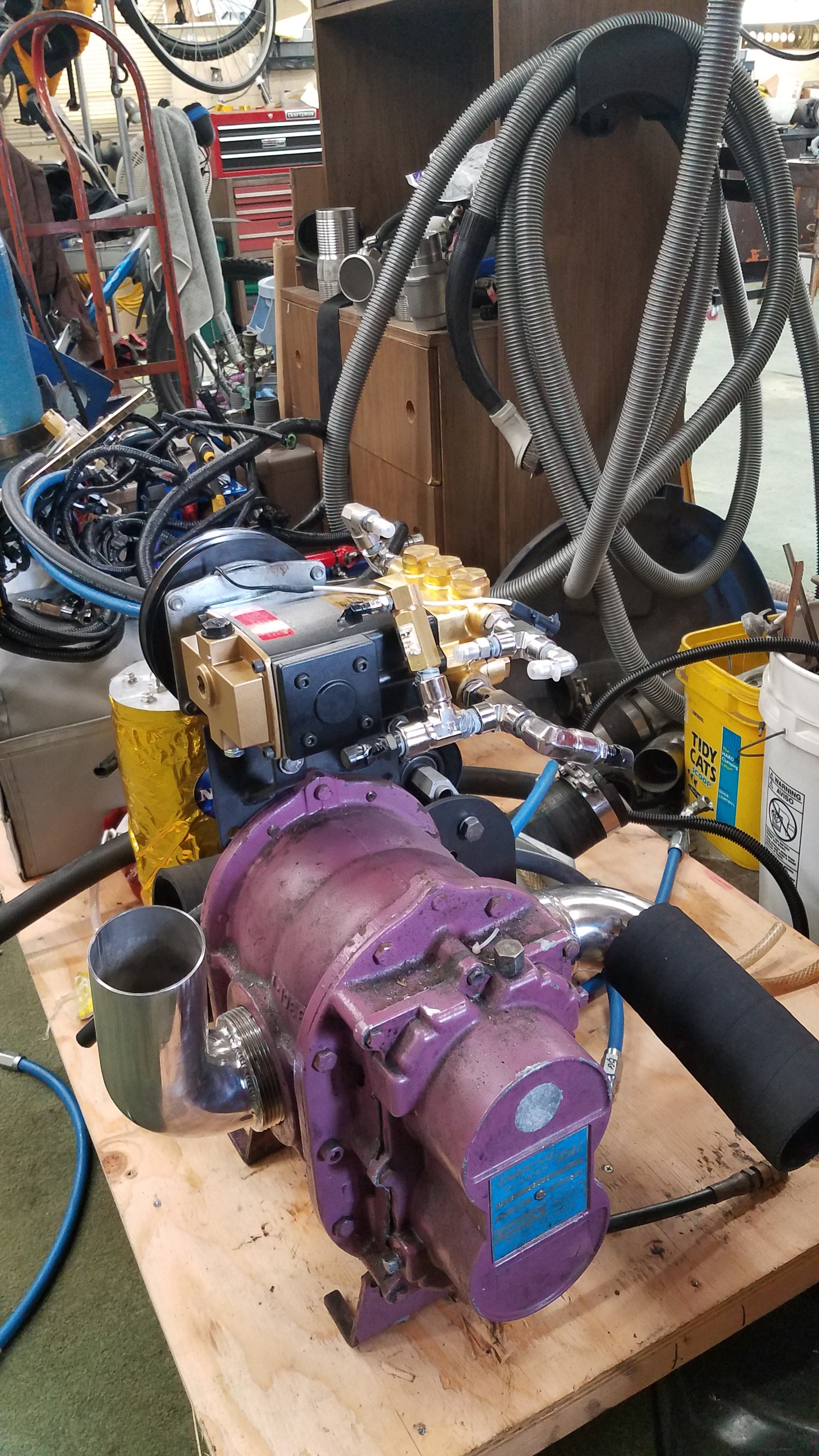

why did the cool purple need to retire? Couldn’t it be rebuilt? Cracked housing?

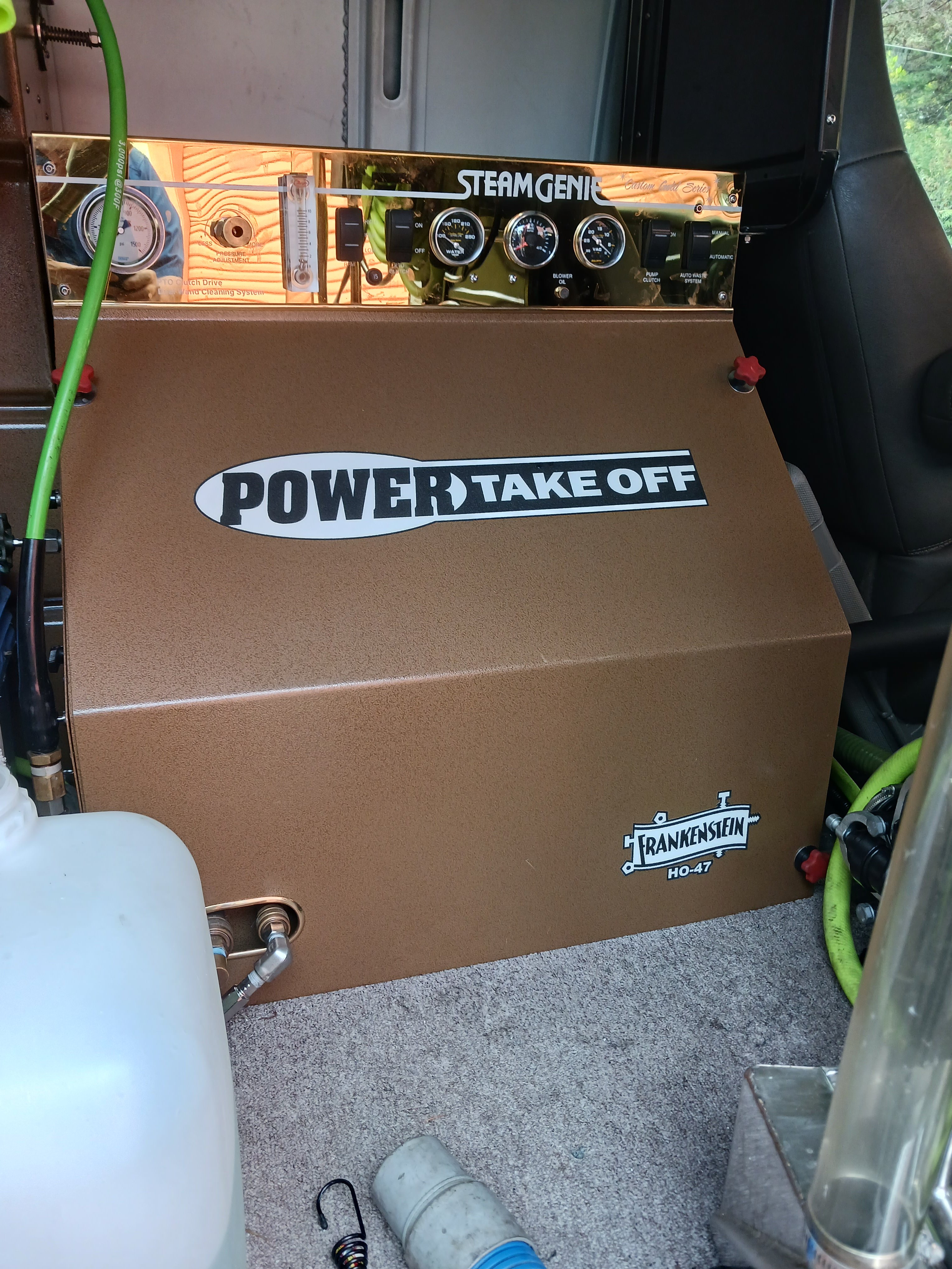

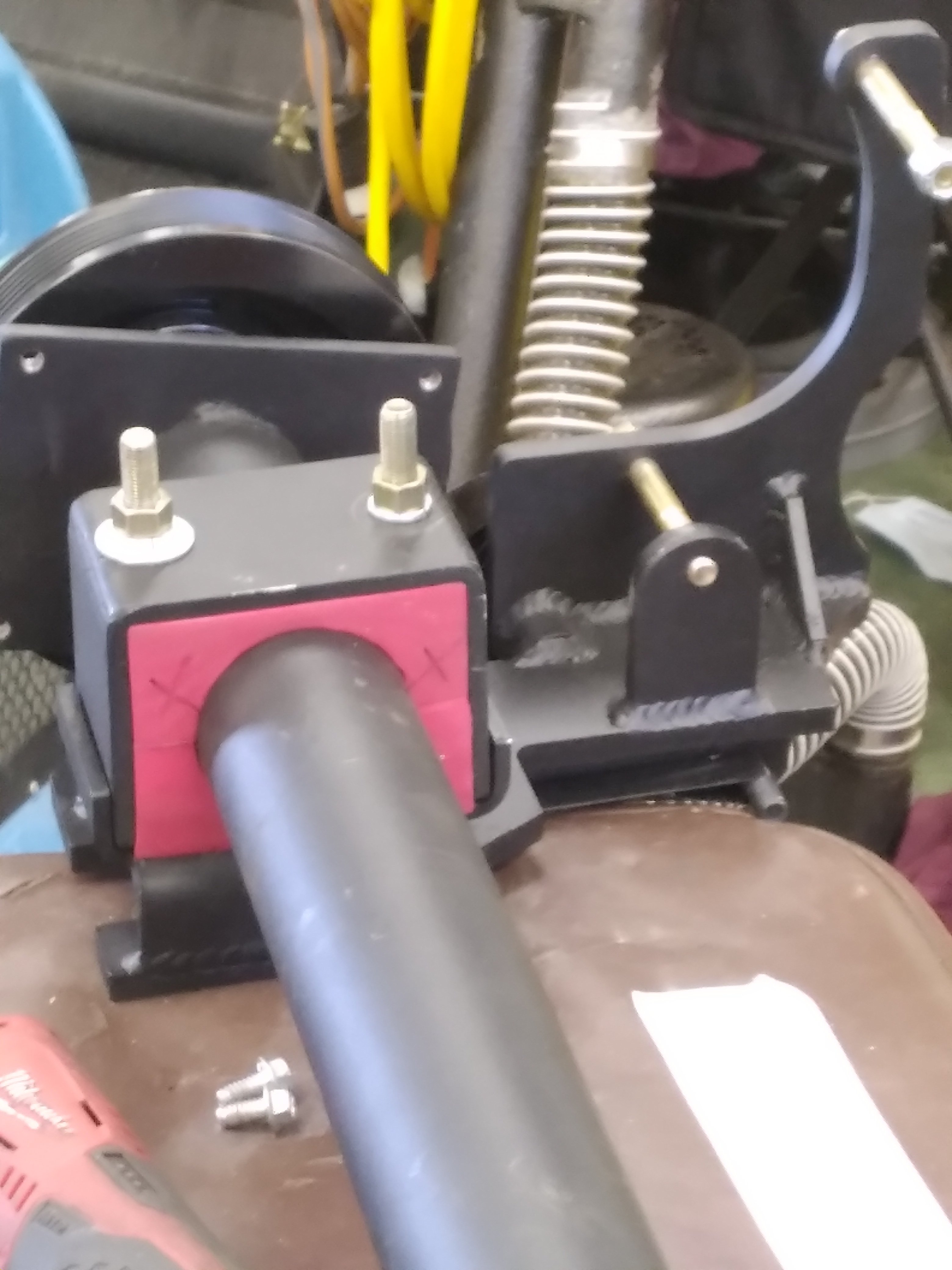

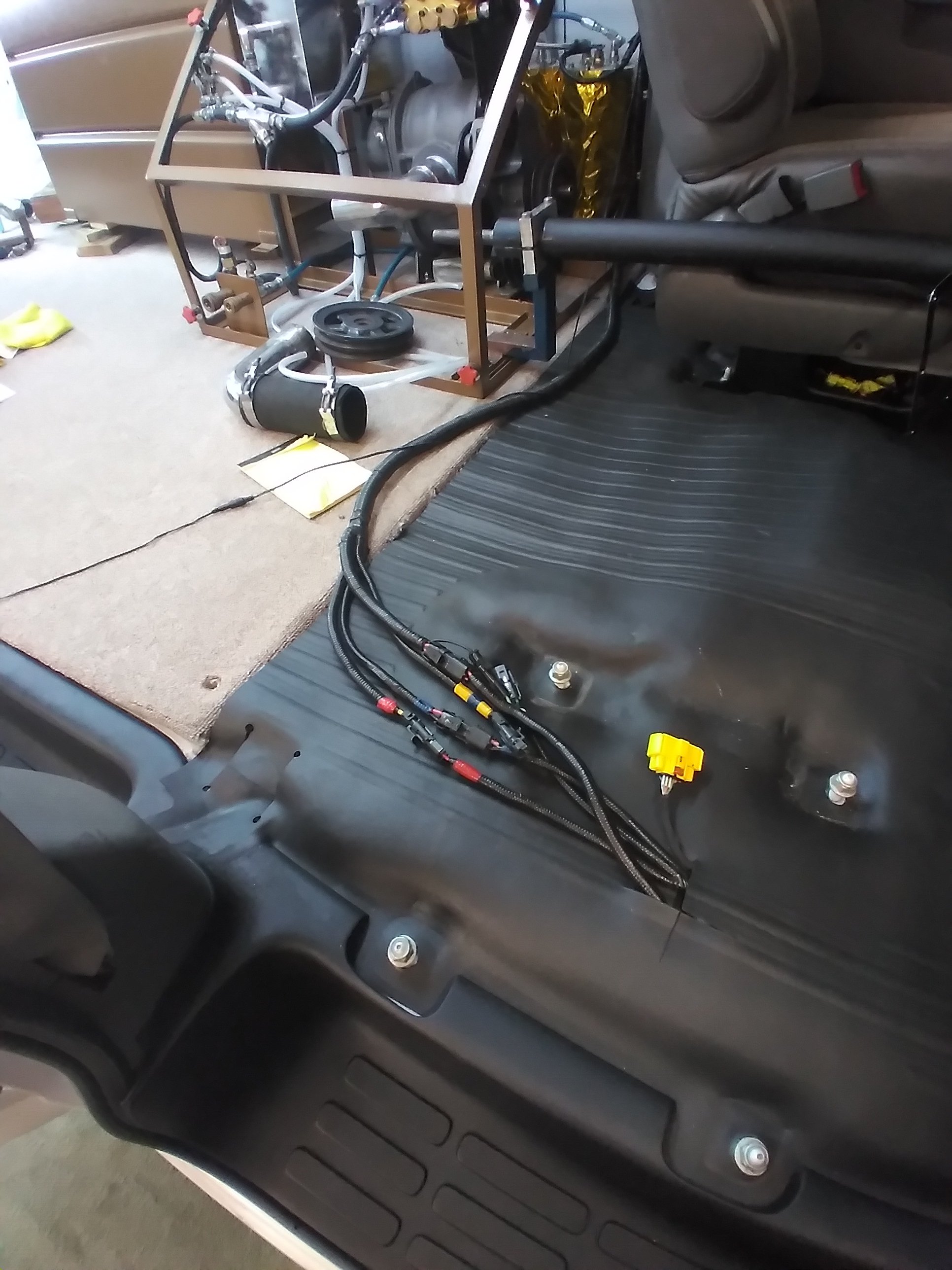

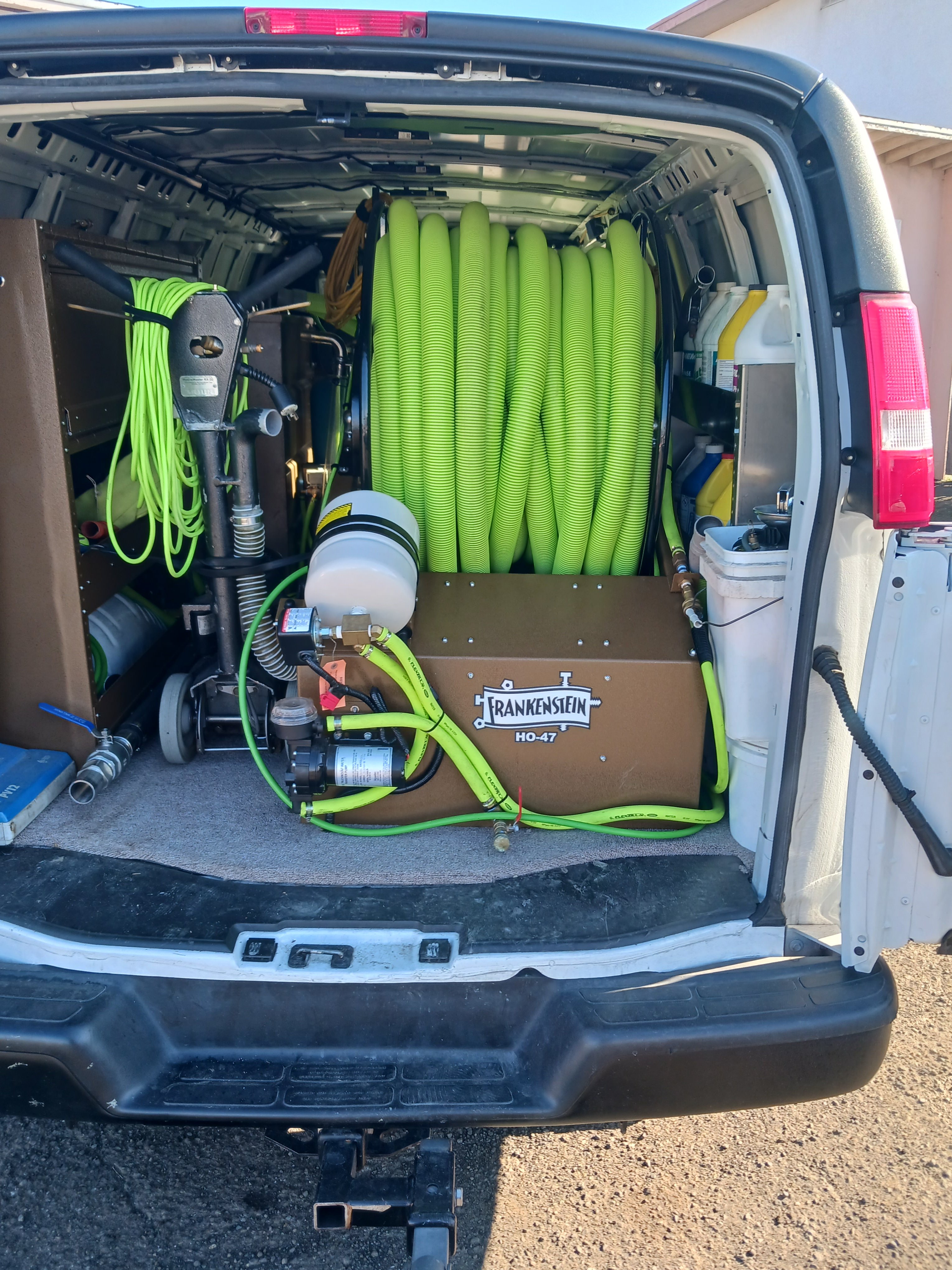

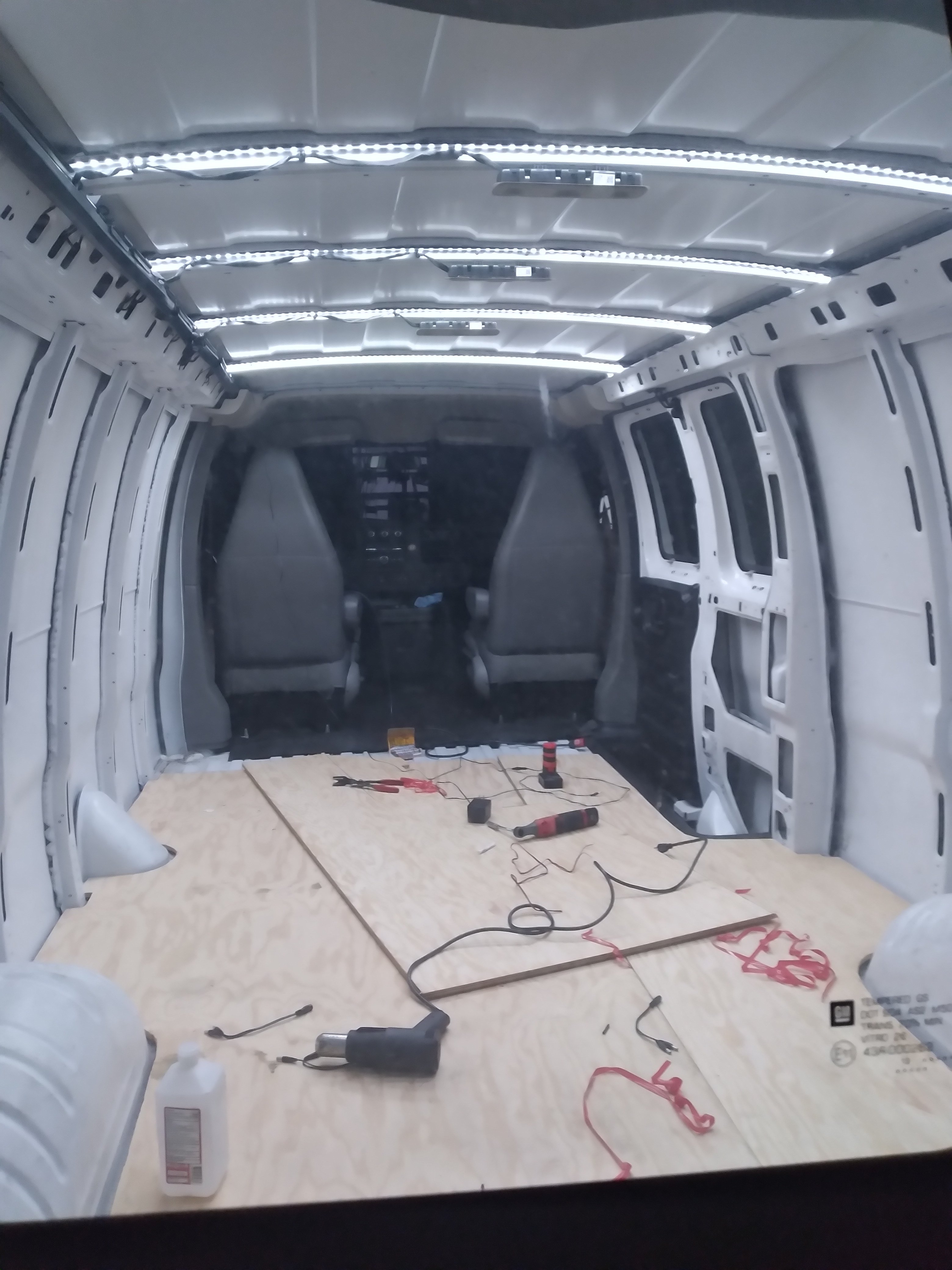

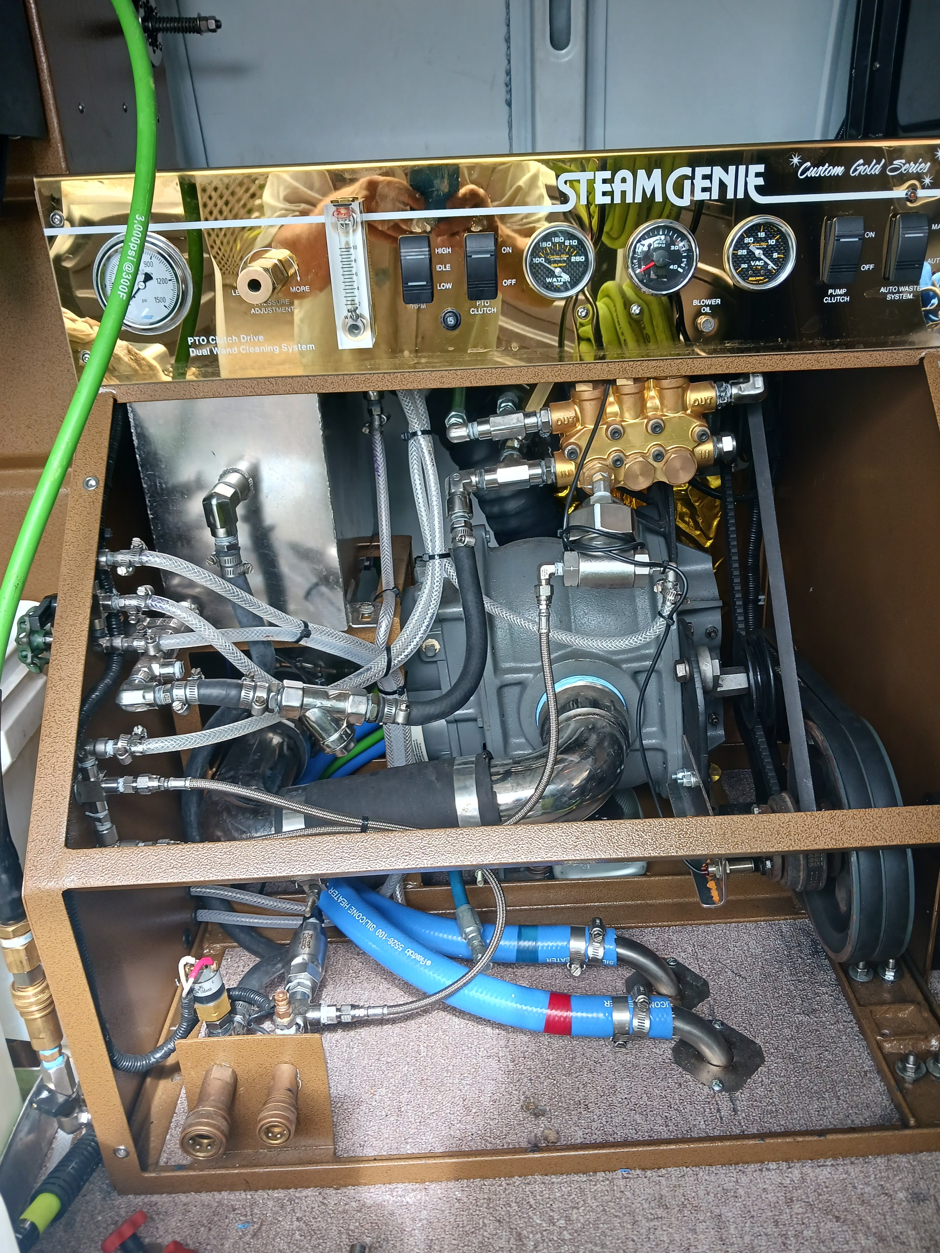

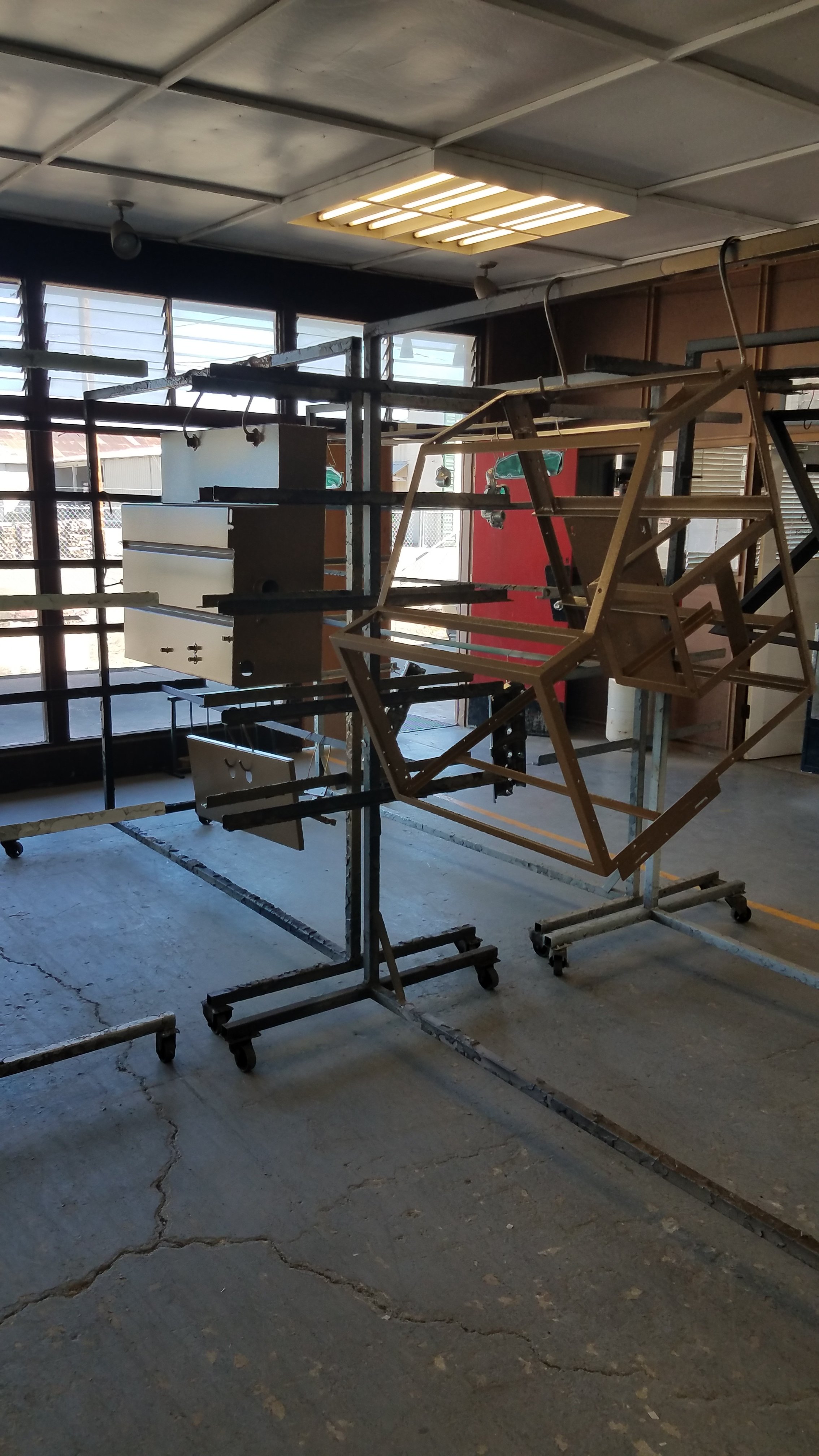

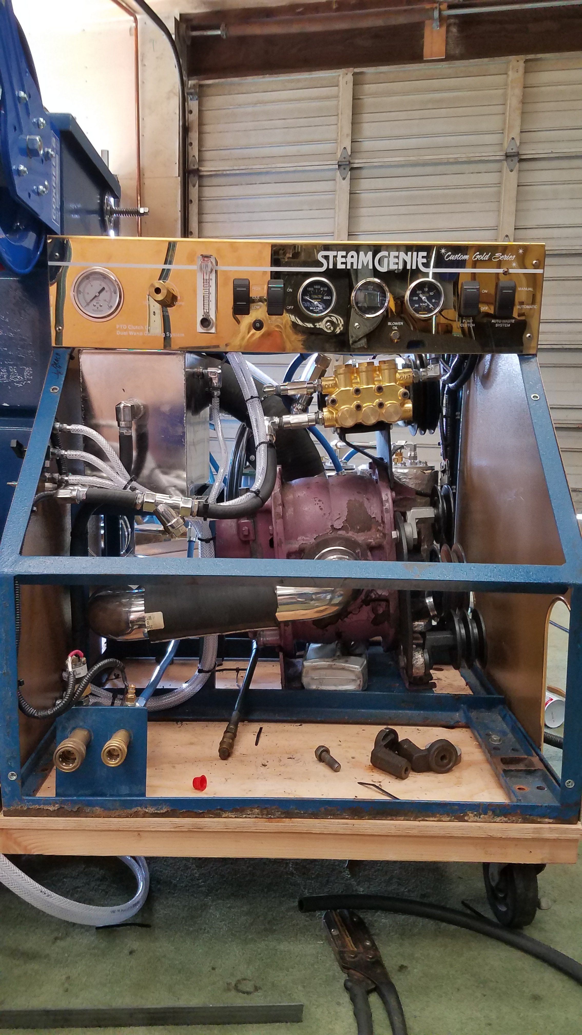

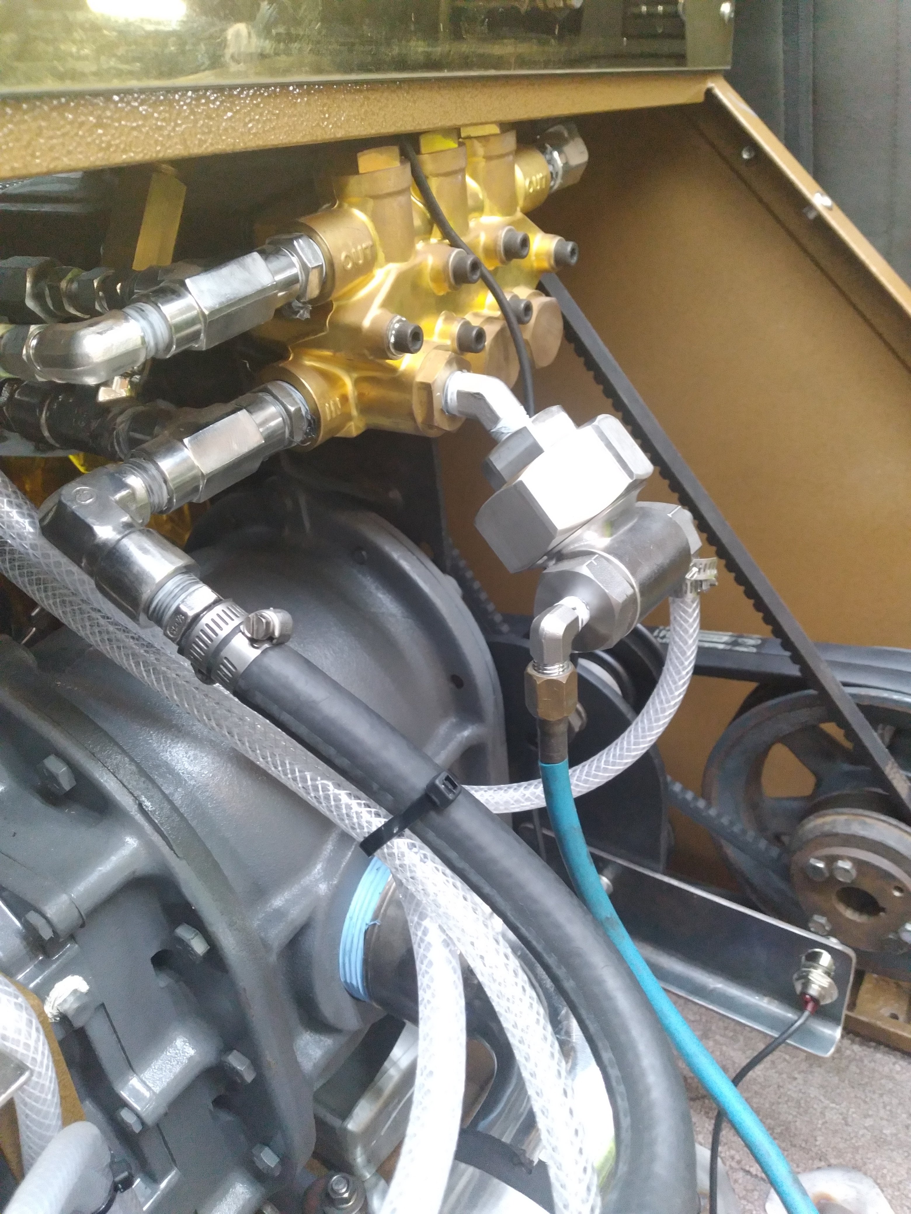

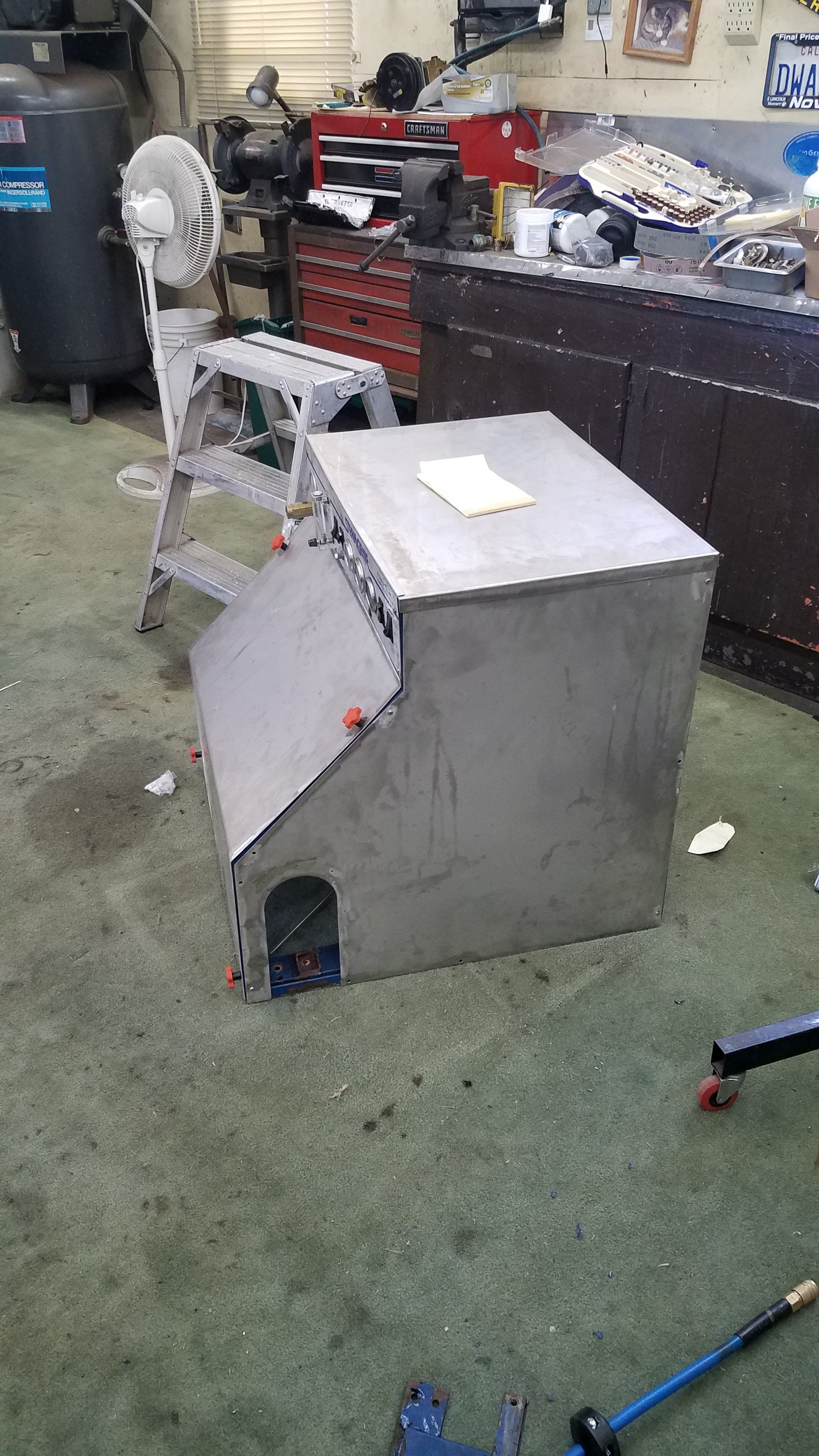

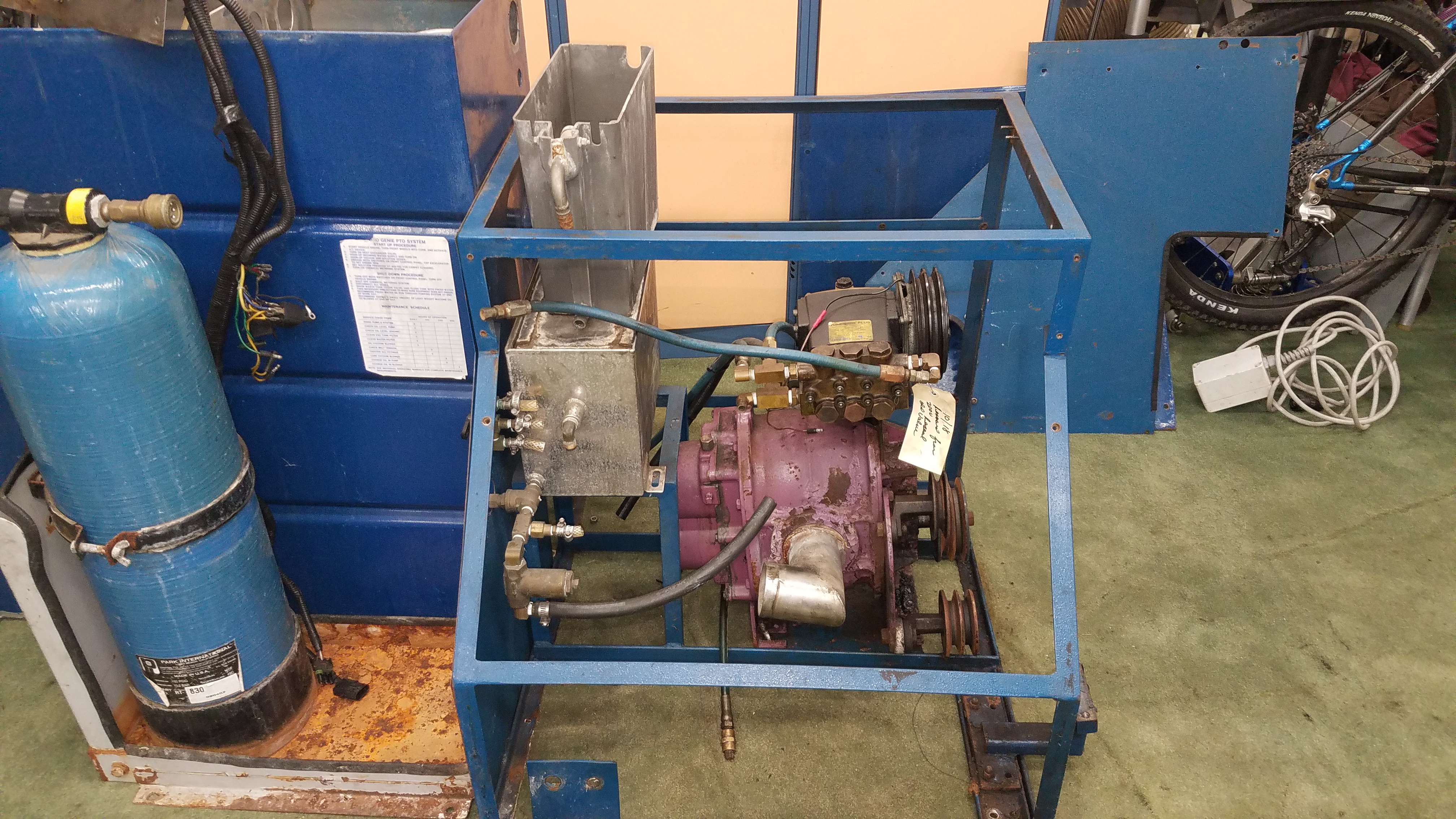

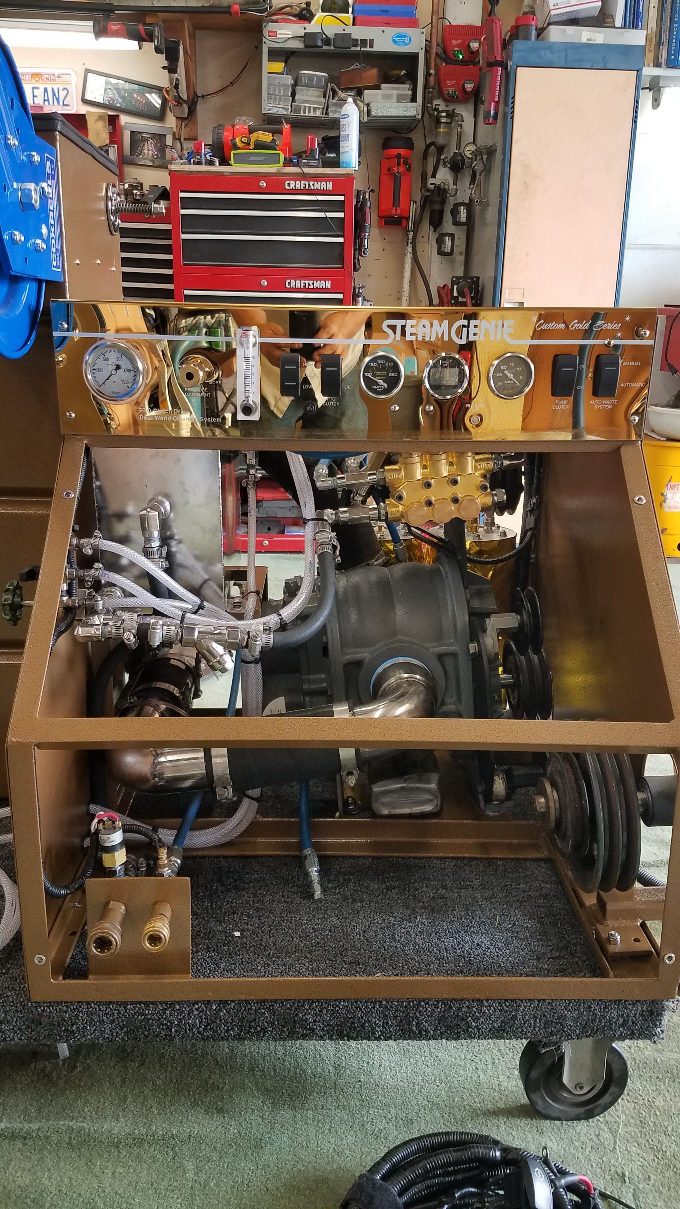

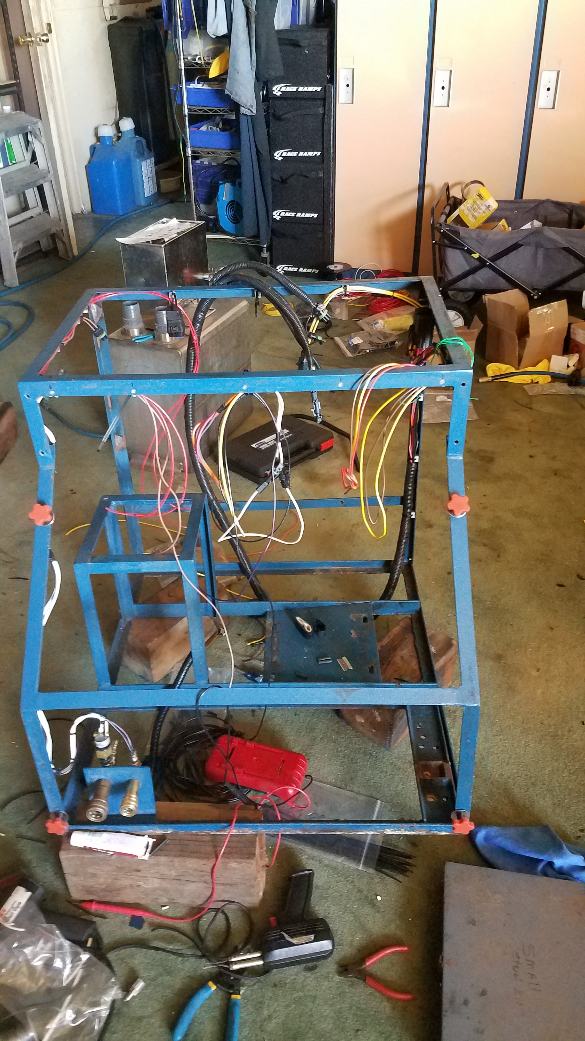

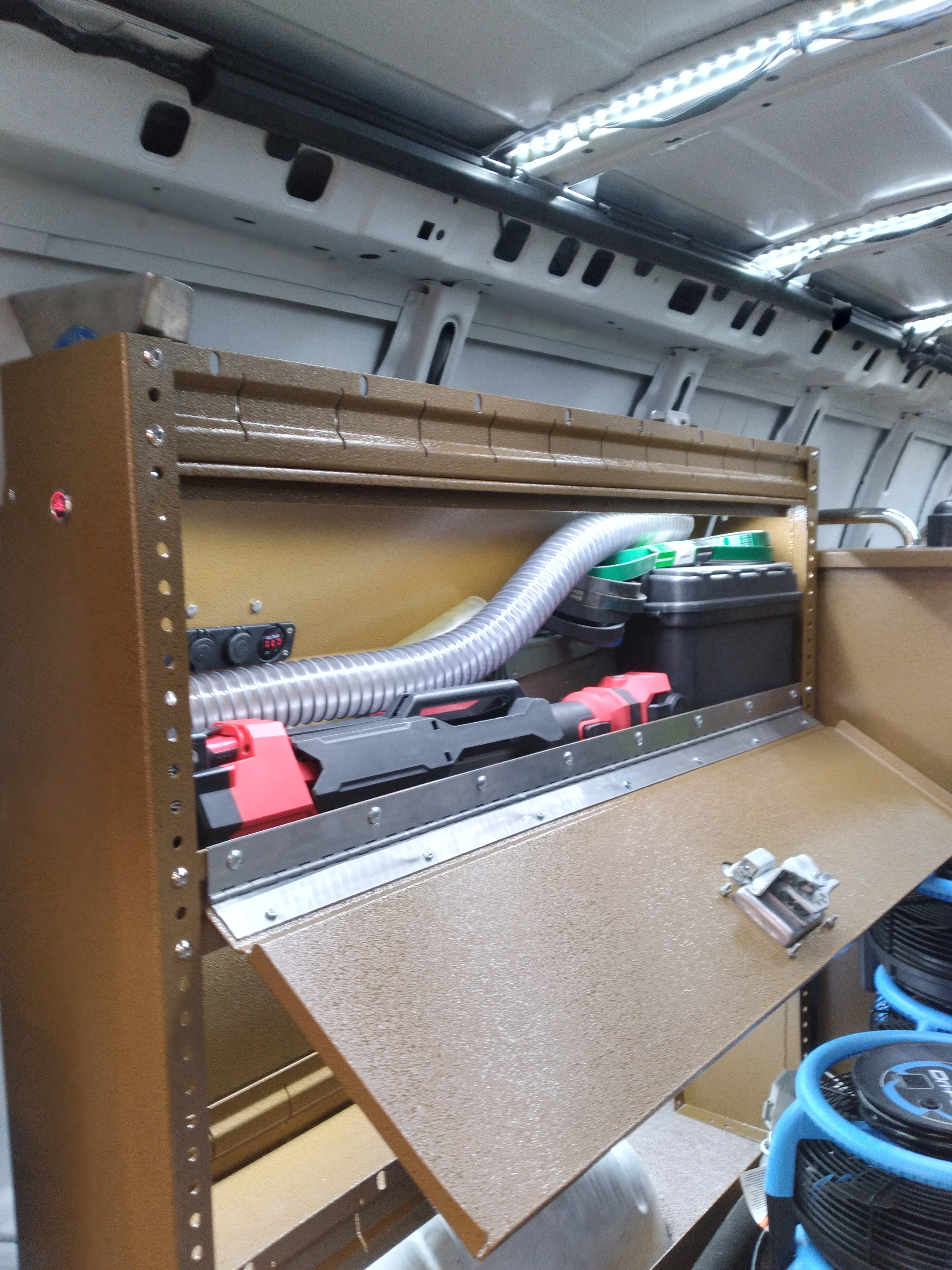

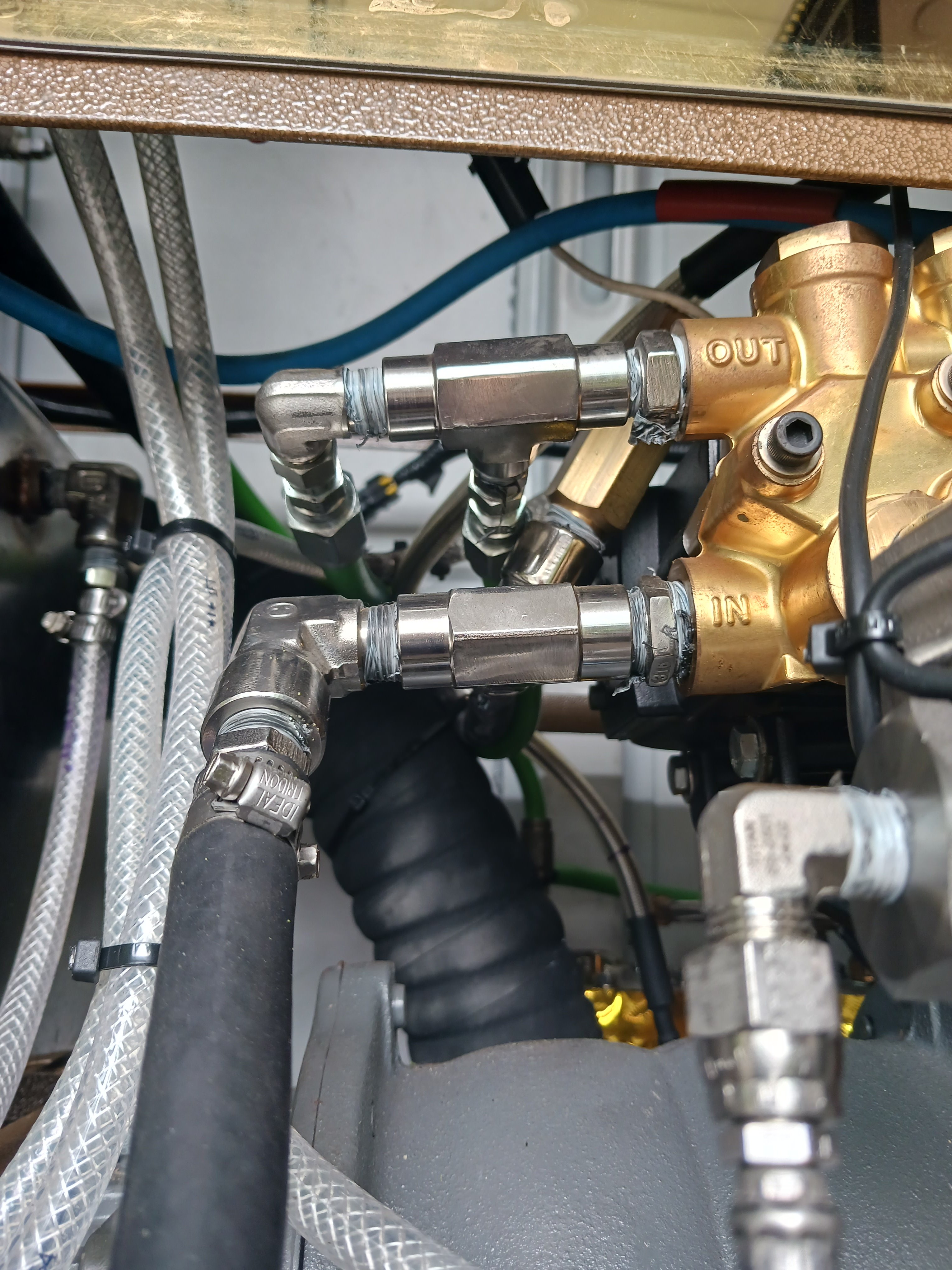

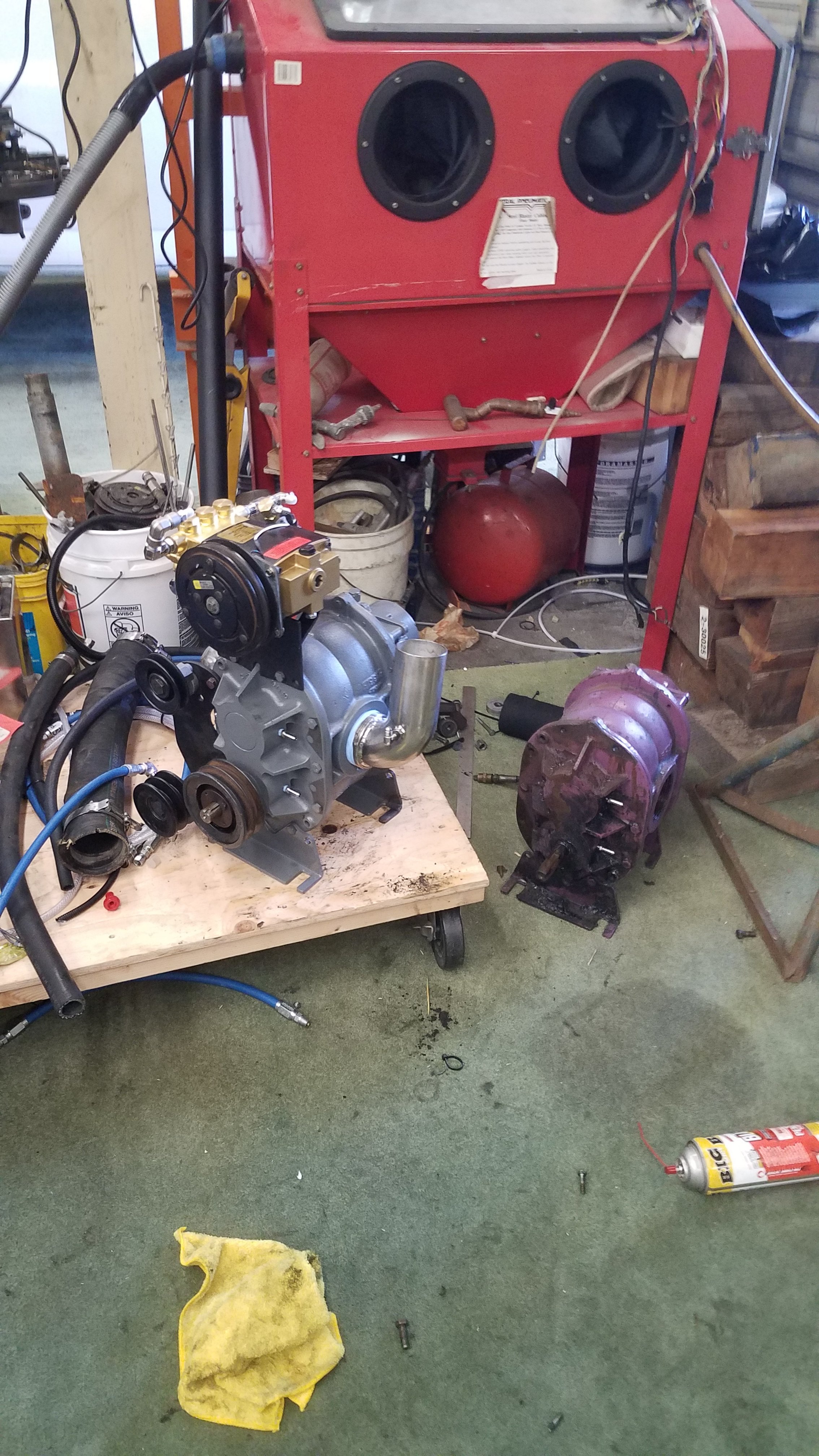

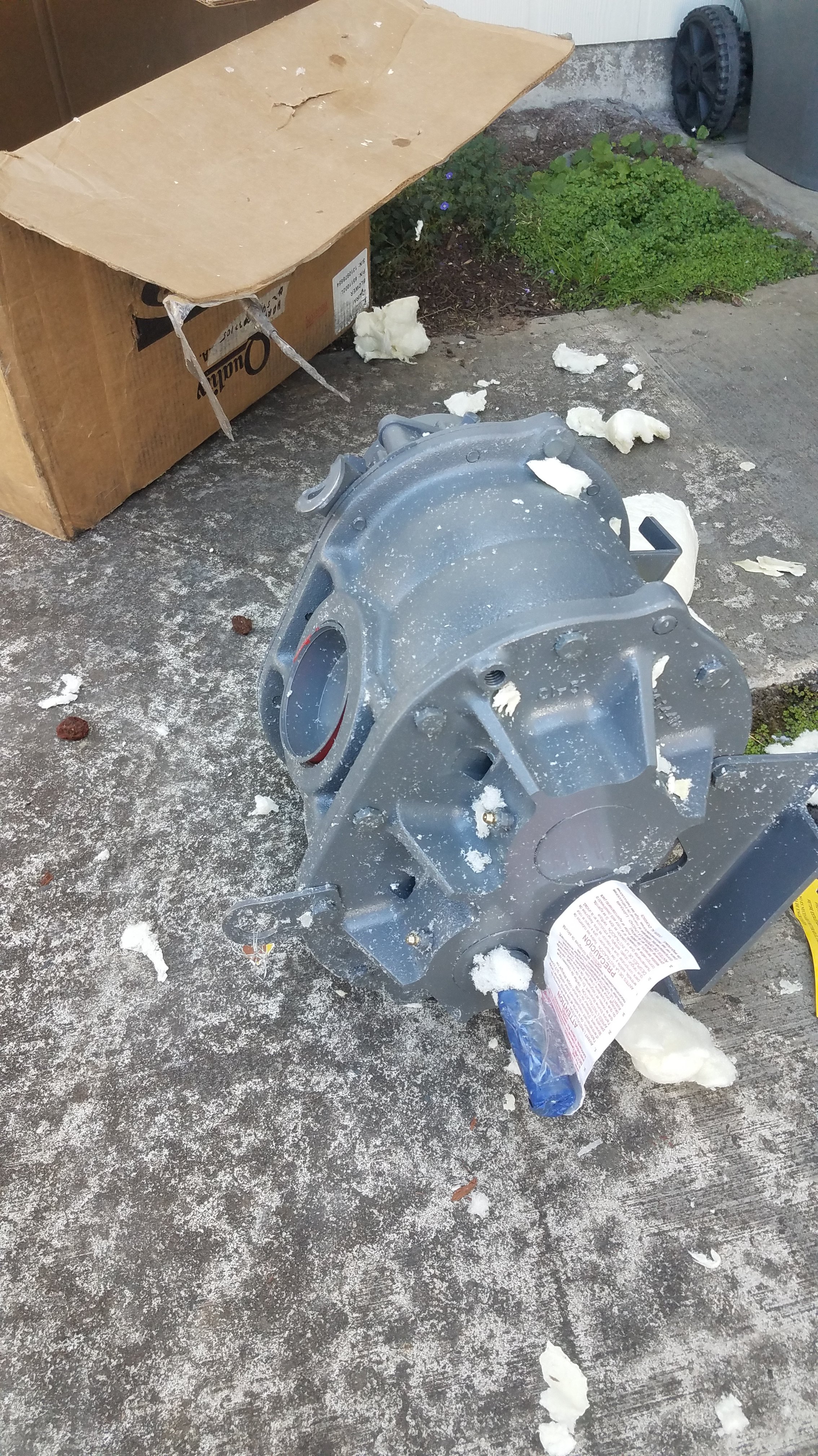

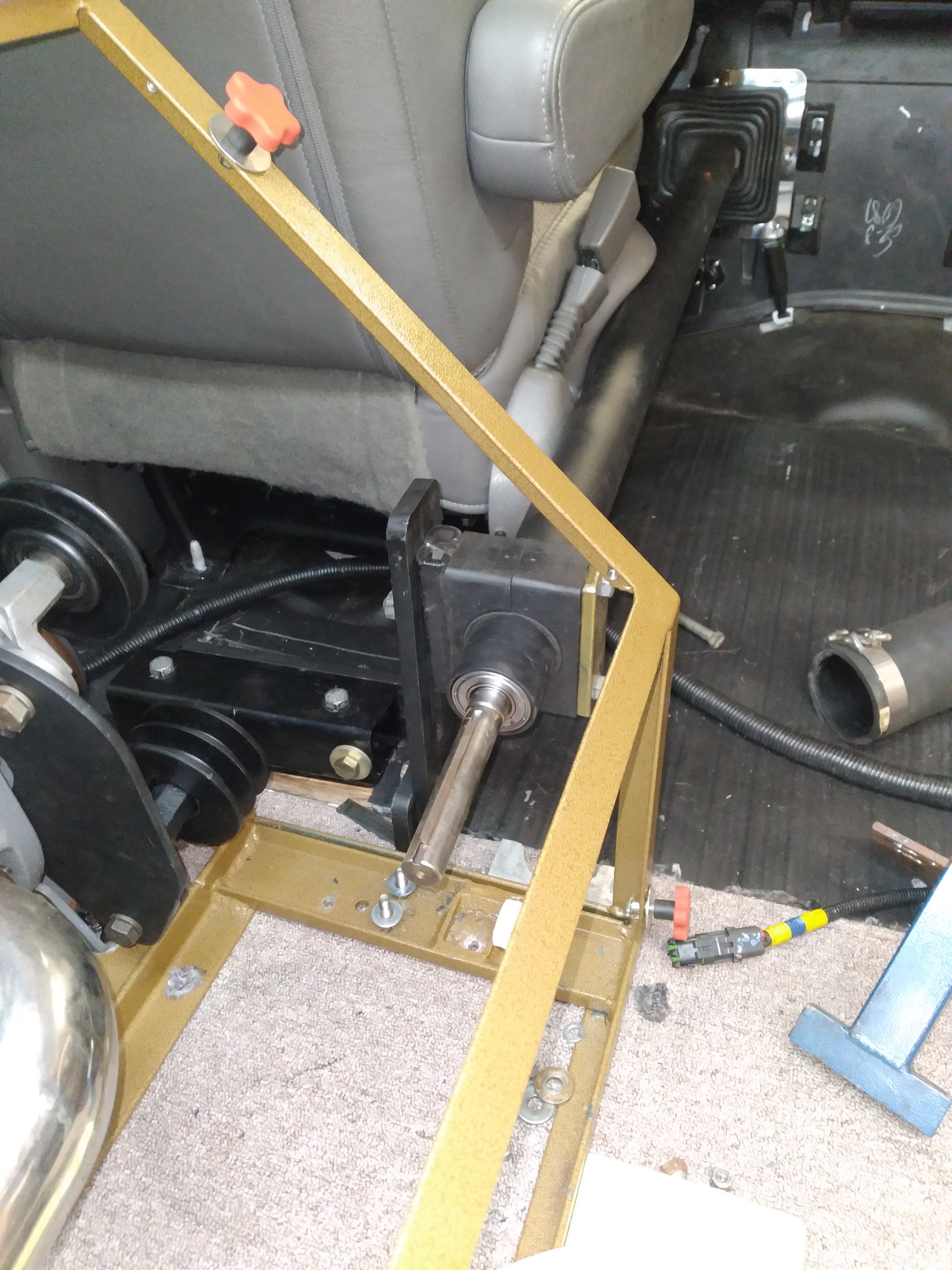

It doesn't need rebuilding it still runs fine, when i built frankinstien i wanted a new machine . Not another machine built from used parts. Properly maintained The machine i built has a life expectancy of 20 to 25 years. It is replacing a 23 year old steamgeni pto(now delegated to be a backup machine) , this machine is solid stainless steel construction, 50gallon wastetank ,machine tins and custom filter box no brass fittings all stainless. It started life as a 1998 steam geni 45 pto it has the best of the best cleanco engine mount with steamgeni drive shaft Cleanco's water to water heat exchangers with hydramaster salsa afterburner, prochem/comet waste pump ,hypro pressure pump roots 47 blower, prochem/general chemical pump, custom electrical distribution prochem waterpond with modified mytee shelf across back custom narrowed side shelving custom modified crash screens all installed in a 2020 chevy 6.0L extended van all pieces custom powdercoated no paint all in chicken feathers everything $61,000

Forgot, the control panel is 24k titanium gold plated polished stainless steel sent to Nova Scotia to be lettered, they were the only company to return my emails about silkscreening on 24k gold

Probably how it should have been done in the first place.

The steamgeni pto is and was a great and highly reliable machine, but i want to do tile and grout and the heat exchangers won't handle the pressures necessary for that and thats what started this whole project, i looked into buying a new machine to do tile and grout and was very disappointed with what is out there, as it stands my 23 year old steamgeni backup machine will probably outlast anything on the market that i could buy now. It was my supplier that convinced me to build frankinstien i started building 2/19 finished the machine 10/19 started looking for a van then covid hit 2/20 bought the van 12/21 started the installation 1/22 completed it and put into service 9/22 have about 200 hours on it so far

Holy Mack! Call him Dr Ray!
nice man. Really freakin nice. Thanks for sharing.

The driveshaft turns about that, frankinstien is set at 1300 engine rpms driveshaft rpms are 1850, blower is 2950 and that is around the same for my stock sg 45pto. Other steamgenis were screamers the hydro 1 & 2 spun the blowers at max 3600rpm. The hydro1 had 2 blowers in series one blower rammed air into the other, blower #2 got really really hot. The blowers on the 1&2 where pretty small back then , sutterbuild 3m
