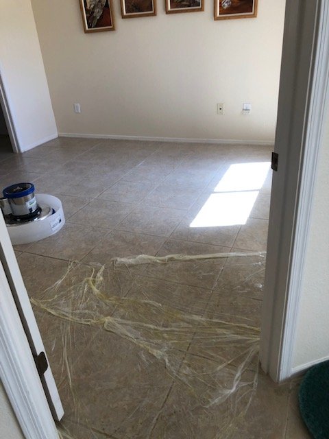

How do you remove carpet glue off tile & grout?
I got a call from an apartment complex.
Their regular cleaners tore the carpet out, removed the tack strips, but left before taking off the glue residue.
The carpet had been installed over tile and grout, the tack strip nailed down in the grout lines.
This morning the cleaning outfit closed the doors and told the apartment manager they wouldn't be back.
Apartment maintenance man thinks its ceramic tile.
Glue is around the perimeter. I have a CRB, 175, Trinity w/tile brush.
I also have the Turboforce I won here on Mikeysboard a few weeks ago, too.
What machine do you recommend, and what chemicals, please explain method too.
I quit my full time driving job 5 weeks ago, so this 140 unit apartment would be a big deal for me.

That stripper that comes in the metal gallon cans in the polyurethane dept. at lowes should do it. Get a few different scrapers, good air movement so you don't suffocate, and a special breathing mask for that stuff

I say go buy a gallon, test a small 2X2 foot section, see how long that takes, and justify your price on that.

Any kind of stripper will not budge it. It will need scrapping. Put a scraper disc on that 175 and be carful if it’s tile.

I don't know what rotary scaper Kenny is referring to, but the one's I'm familiar with scratch the chit out of ceramic tile, and possibly chip it at grout edges
hard brittle glue residue or rubbery?
be a big PITA either way .
Hands and knees scraping first, otherwise, brushes or pads will load up with goo
you need a solvent that dissolves cured glue.
Xylene, toluene and other wicked solvents you need to be extremely careful with
here's what I'd suggest, Tony, don't give them a price.
Tell them you want to do a small section no charge to be sure they'll be happy with results.
gives you opportunity to try several things, as well as knowing how much time and effort.
...so you know how much to quote them

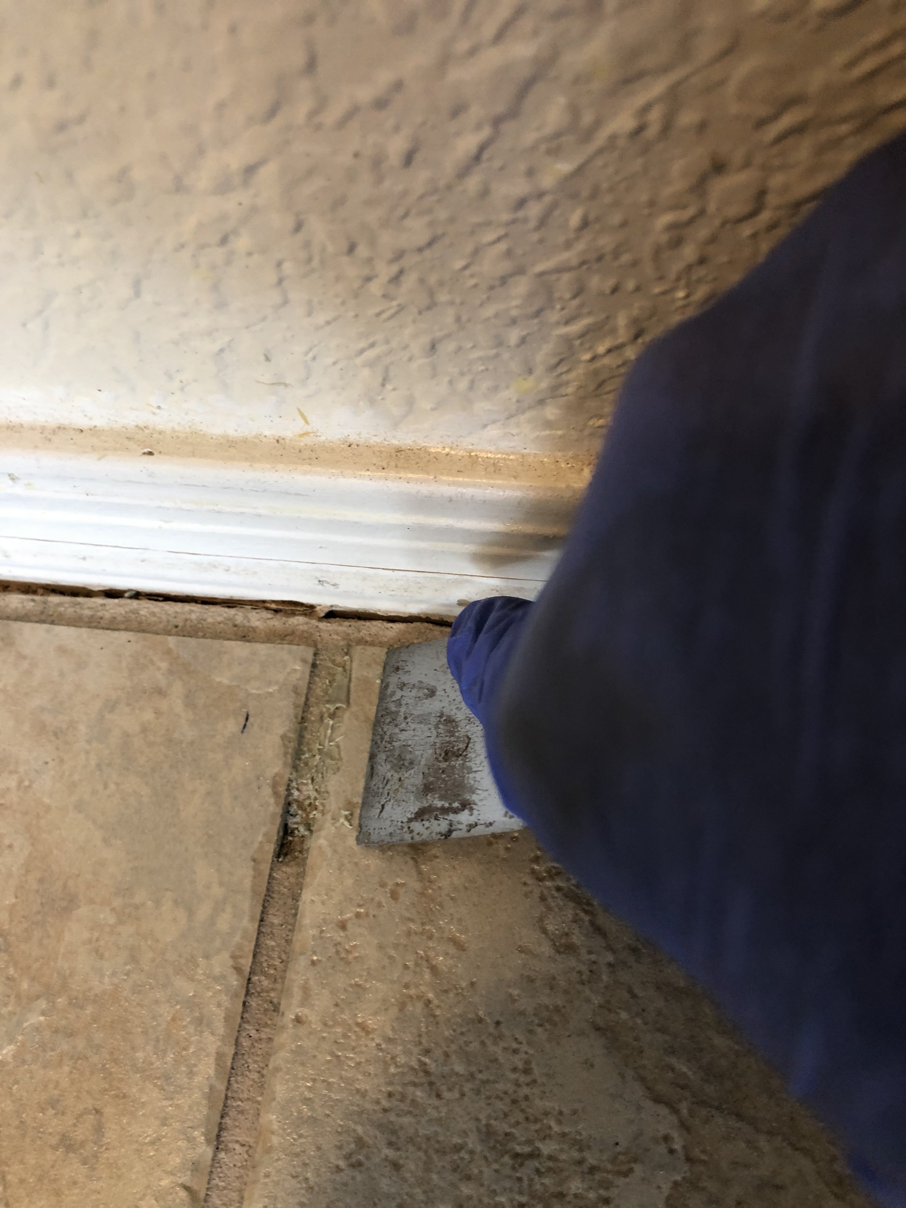

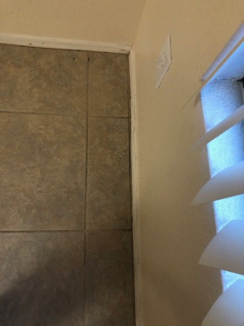

The textured tile makes a razor only one step.
I used Sentinel 707 among others, but it worked best w/o removing color seal off of grout.
I spray floor, let wait 10-15 minutes, because in Phoenix it dries up too quick to wait longer.
I cover with plastic drop cloth so it can sit.
Then I have a 50 lb. weighted plate for my 175 and a ring to stop splatter.
I'll use that with fiber pads underneath plate to scrub.
Vacuum up w/shop vac.
Scrub edges w/ doodlebug.
Follow w/Trinity tile brush and Simix to clean.
Neutralize w/StoneTech Stone & Tile Cleaner.
Follow w/fiber pad to shine, if needed.

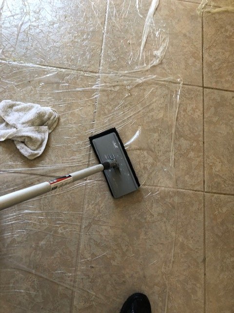

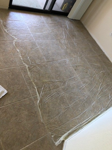

I sprayed Sentinel 707 or 747 (the one the Home Depot had) and covered with plastic so it wouldn't dry until I got to the section.
The plastic allowed me to take time I needed in one section before rushing to another.

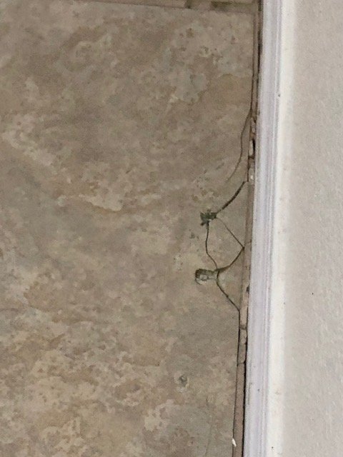

The remover was to be removed with a good rinse.
I ended up using old soaked glad pads, followed by a dry one to absorb.
Then I was able to do the Simix, Stone Tech method to clean.
Turboforce would have been so much easier.

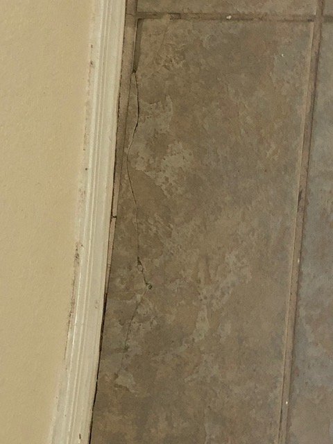

But the baseboards needing caulked and the damage from removing carpet tack strips took that option off the board.
