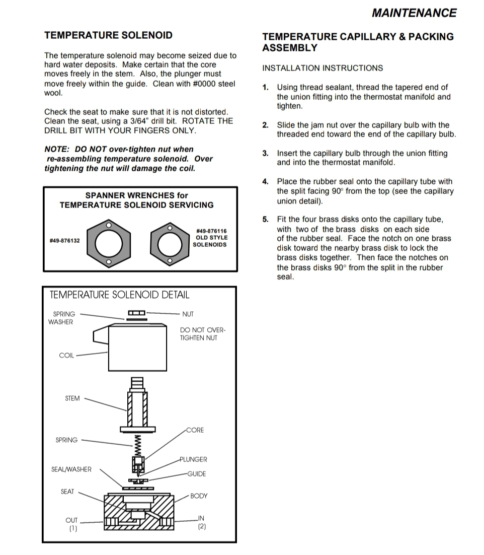

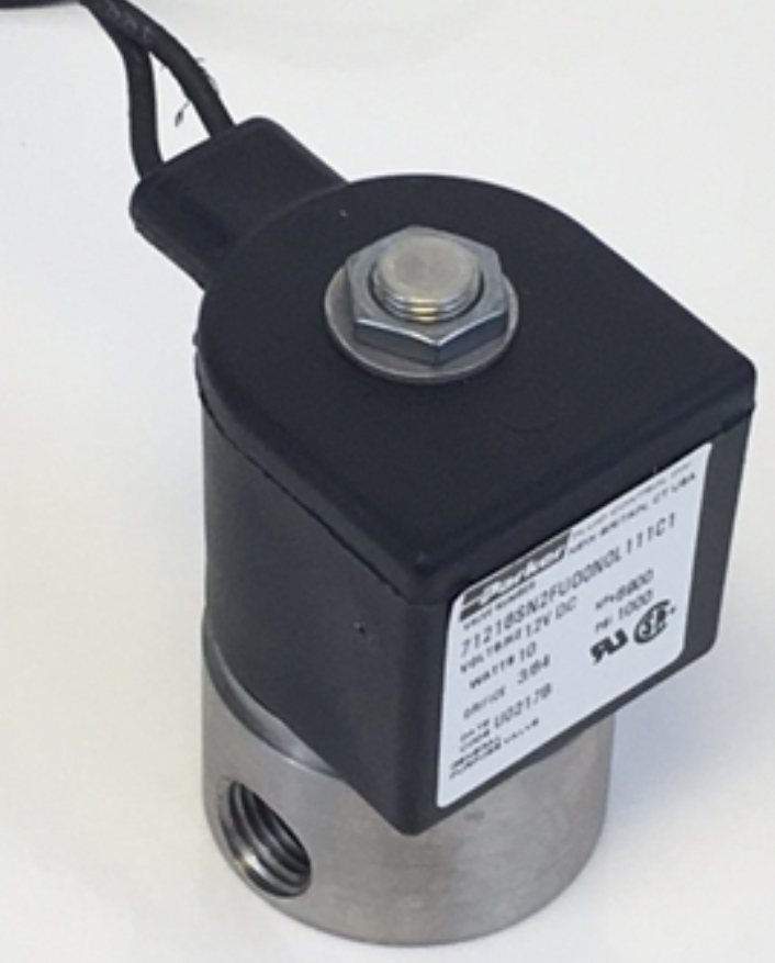

I don't know that machine but on older Prochem units a temperature solenoid controls bypassing water. It would bypass when too high a temp. It would also if scaled up and needed cleaned.
There is also a bi-metal thermal valve in the water box that if it got too hot would dump into the waste tank.

Are you referring to the temperature sending unit on the check valve?
As for the thermal relief valve…I’ve got it temporarily disconnected until I find a hose to connect it to the waste tank
