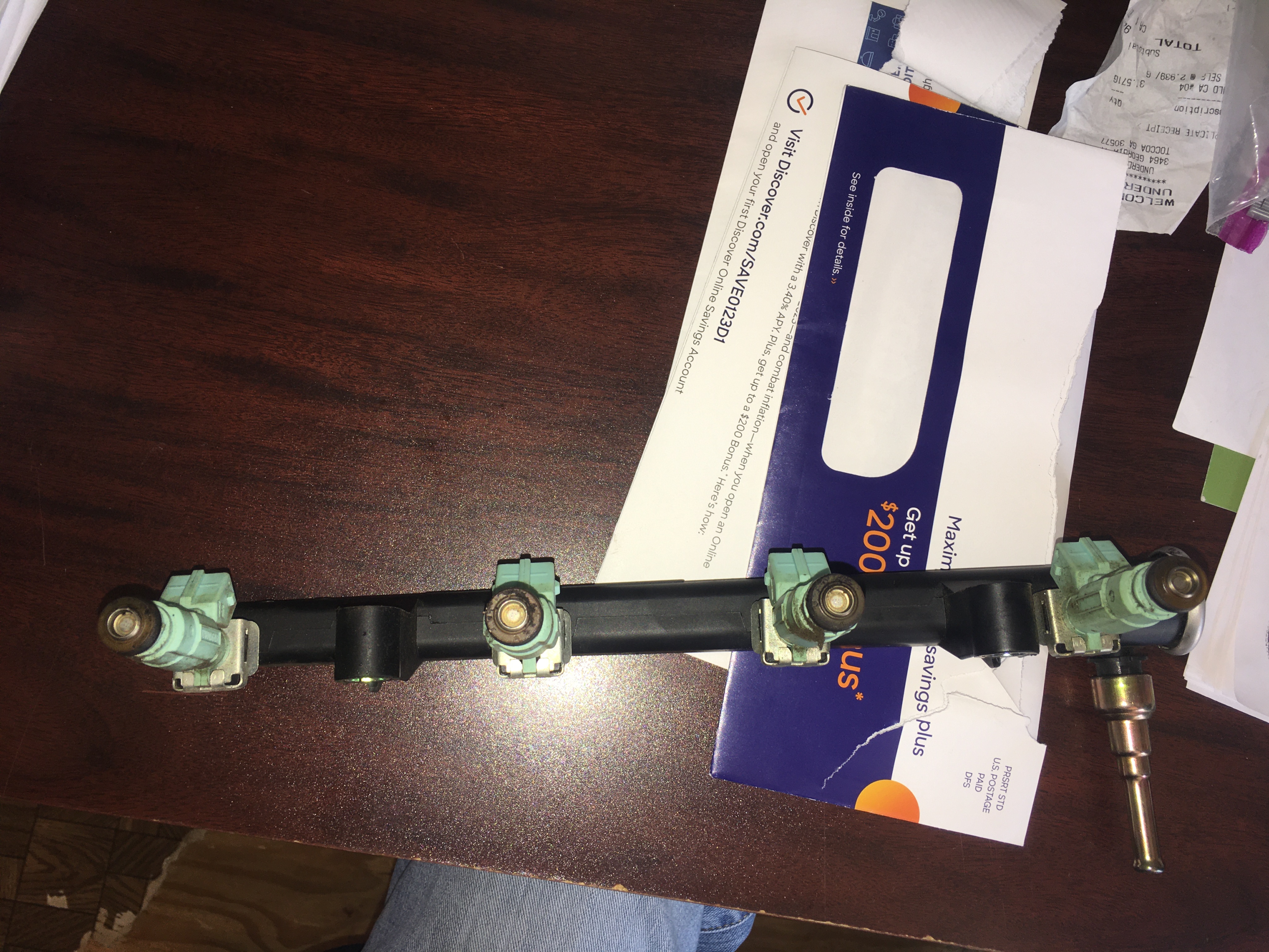

Does this look dirty to you guys? I wasn’t able to test it where it’s located at

Do you know anyone that owns one of theses injector testers? The rubber o'rings look like they should be replaced.
Wtf do you have the fuel rail off now? Did you at least volt/ohm test them? Listen to see if one was acting up?

I'm just reading anything that might cause the glow if it's lean fuel burning. I picked up another set for $75. Amazon product
I pulled one out of the fuel rail and noticed some debris inside the rail where it plugs in.

I haven't checked any codes. The whole inside of the CAT is cleared out. It's a big open tube now. I'll see if I can find the specific EGT
The only two things that haven't been replaced to cause this would be timing and fuel injectors. I wanted to test the injectors. But for $75, it seemed a good idea to just replace them. Remember the previous owner used transmission hoses for fuel lines. I was wondering if there was some debris that might've clogged the injectors
