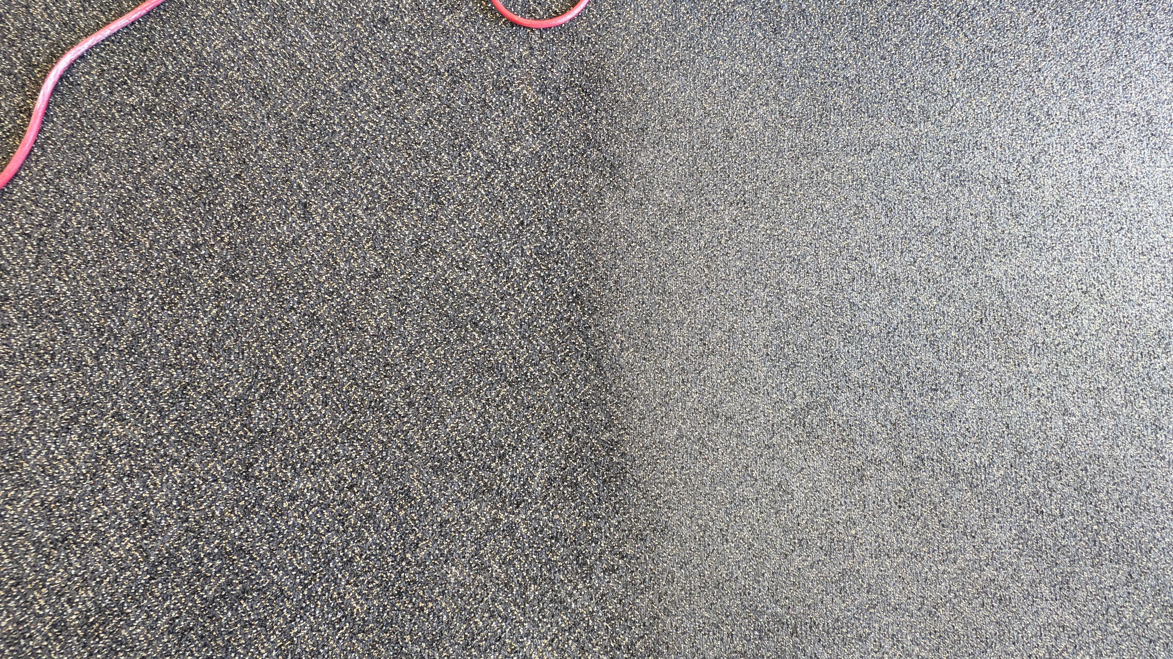

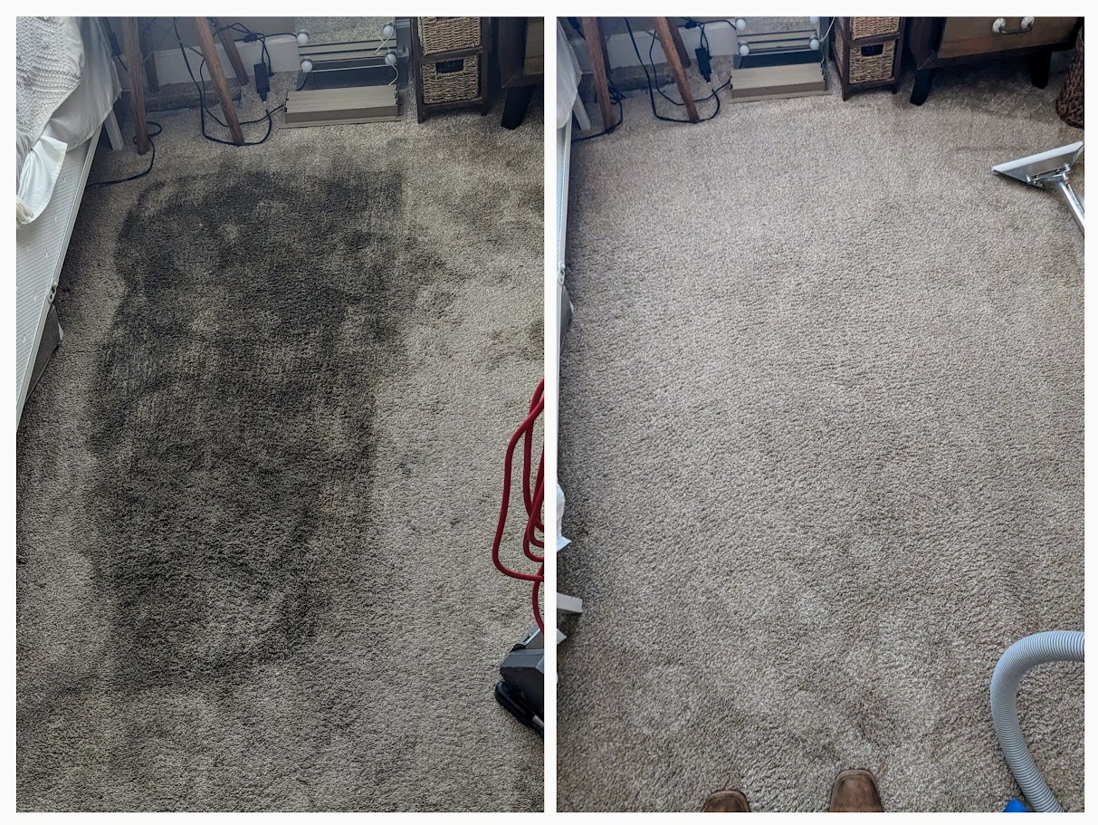

Show us the after pics of that trashed carpet you just cleaned recently?
14,079
pad job.
I dont go after trashed carpet at this stage in my cleaning career.
With the Chosen wand I can clean most anything I'm going to run into and have it dry in a few hours
