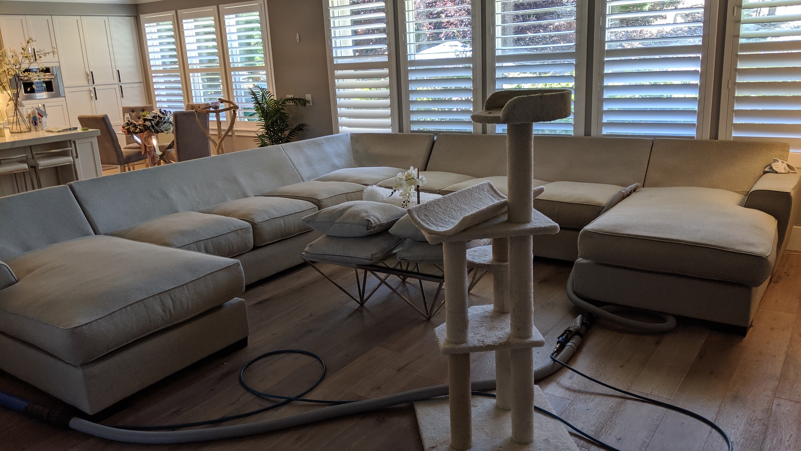

and they buy a linen TV couch....
IMG_20190813_141654.jpgIMG_20190813_141646.jpgIMG_20190813_144256.jpgIMG_20190813_140654.jpgIMG_20190813_140711.jpgIMG_20190813_140702.jpgIMG_20190813_140714.jpgIMG_20190813_140727.jpgIMG_20190813_140721.jpg
Spot cleaning rings galore.
Pre Vibra- Vac'd and "just" rinsed with the SSUP and the new mystery powdered acid rinse.
Perfect.

Linen is one of my least favorite to clean. I use fabric prespray at 16oz to the gallon and 2 oz of peroxide. The acid rinse of your choice. Looks like about 17’ and with 2 of us cleaning would take 1-1 1/2hrs. It looks better when dry than wet. We set up a fan if we are cleaning carpets also.
