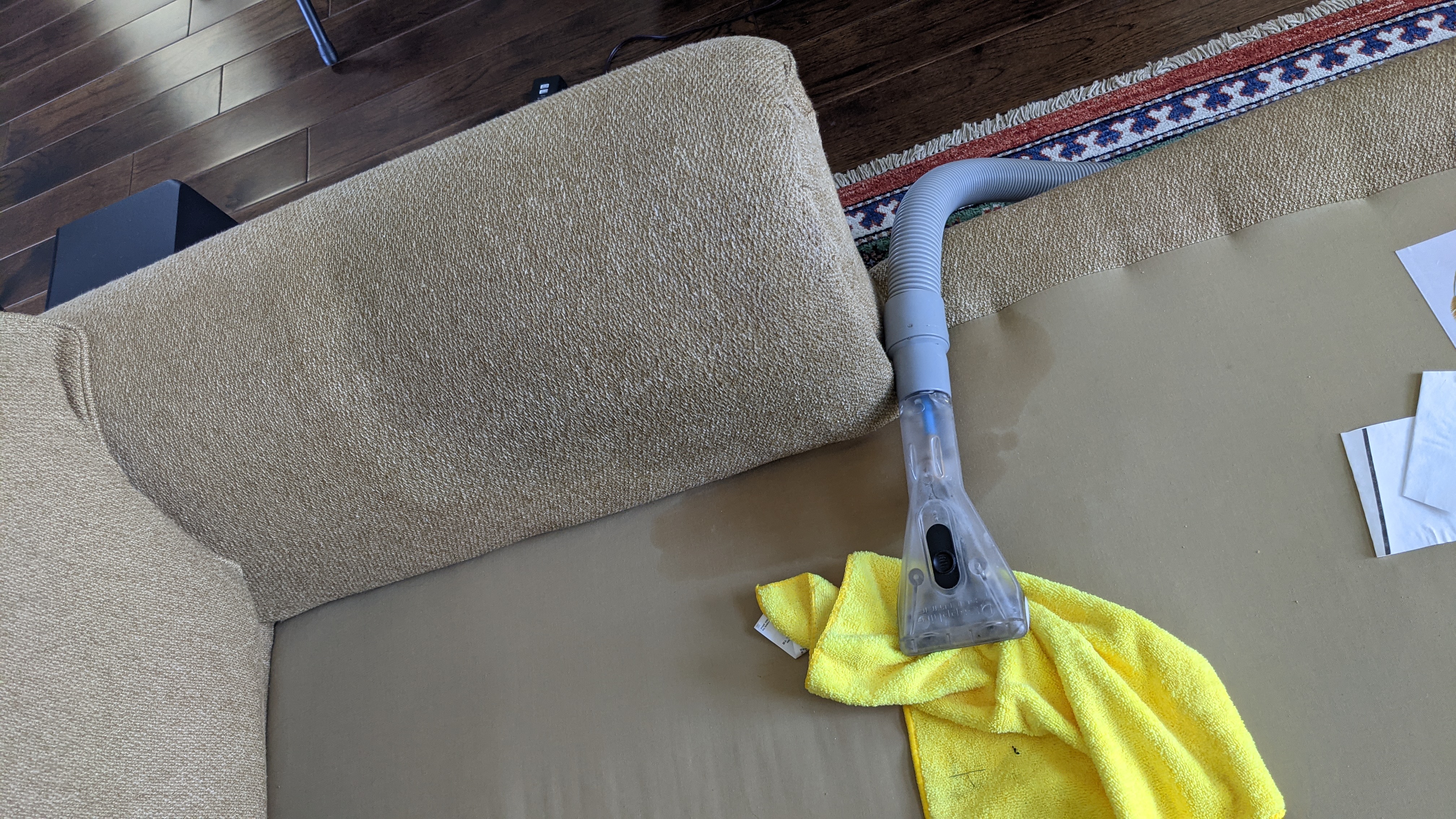

Another pleasant pepitizing outcome
117,323

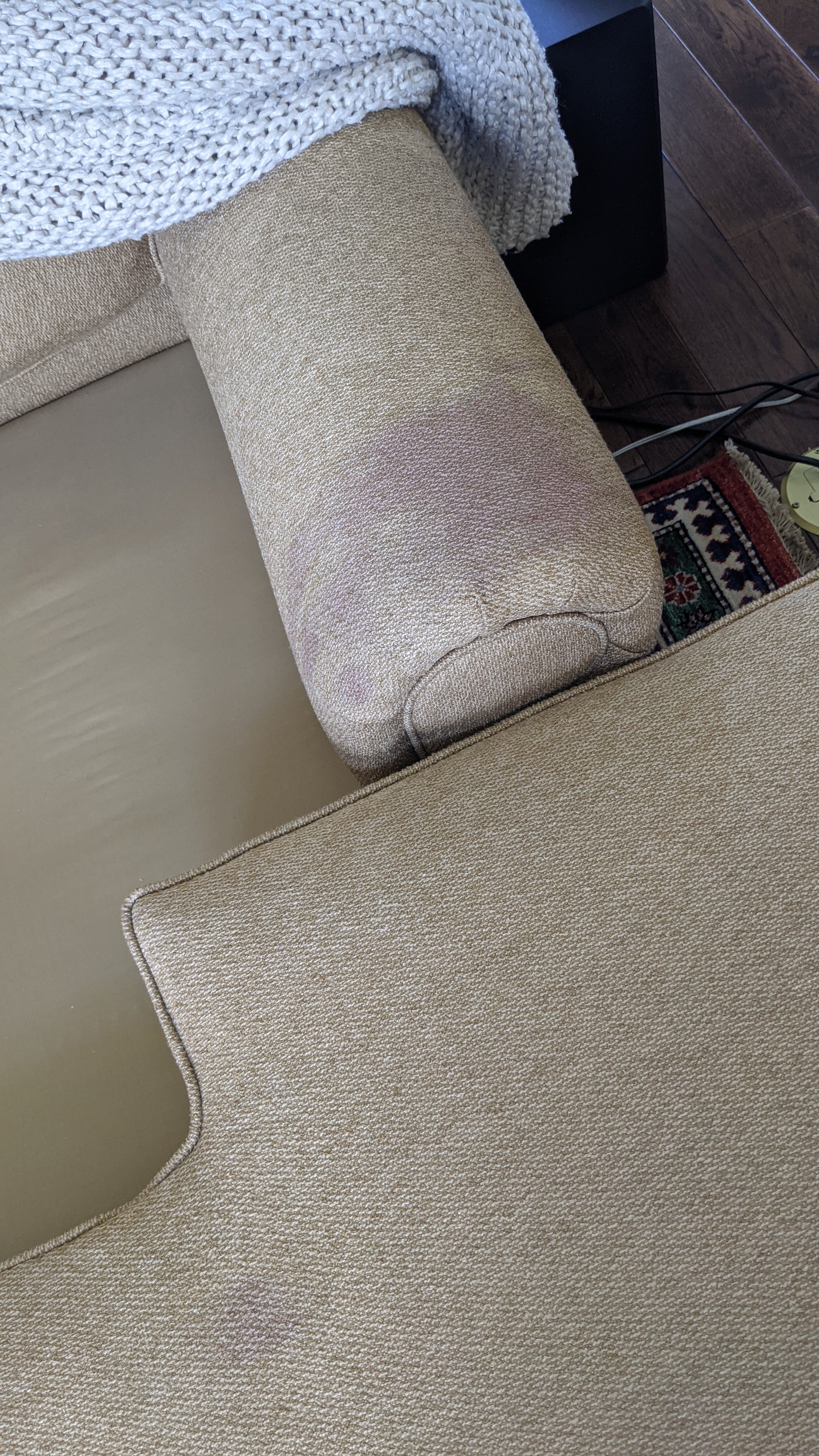

2-week-old wine spill on an unprotected froofy fabric..
Still damp when I left but if I didn't get 99% that I'll be shocked..
Just peptizer and AFR...
12,849
Nicely done Mike
When you can remove tannin stains on natural fibers without oxidizers and reducers, you get that kind of even, finished product.
