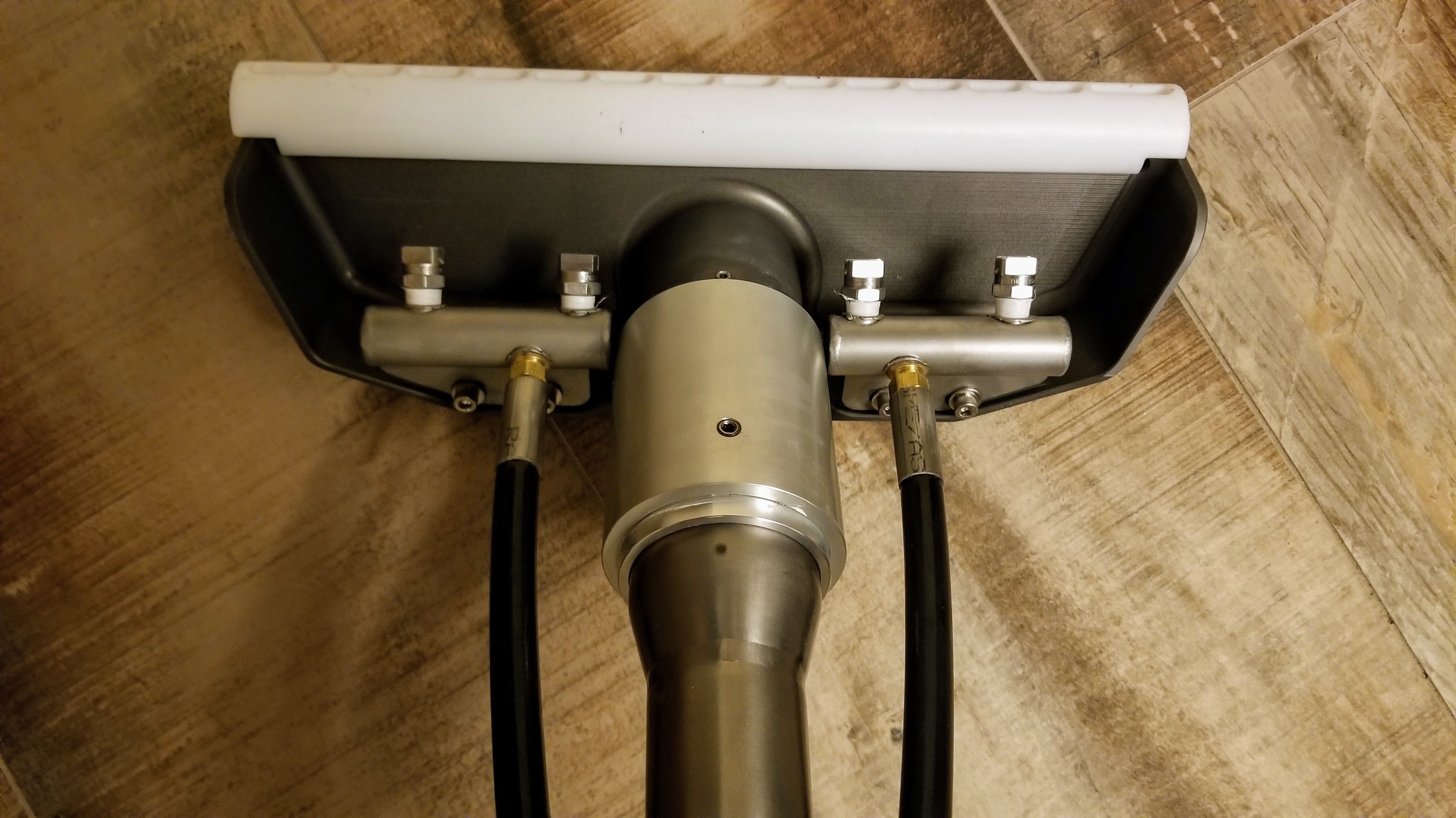

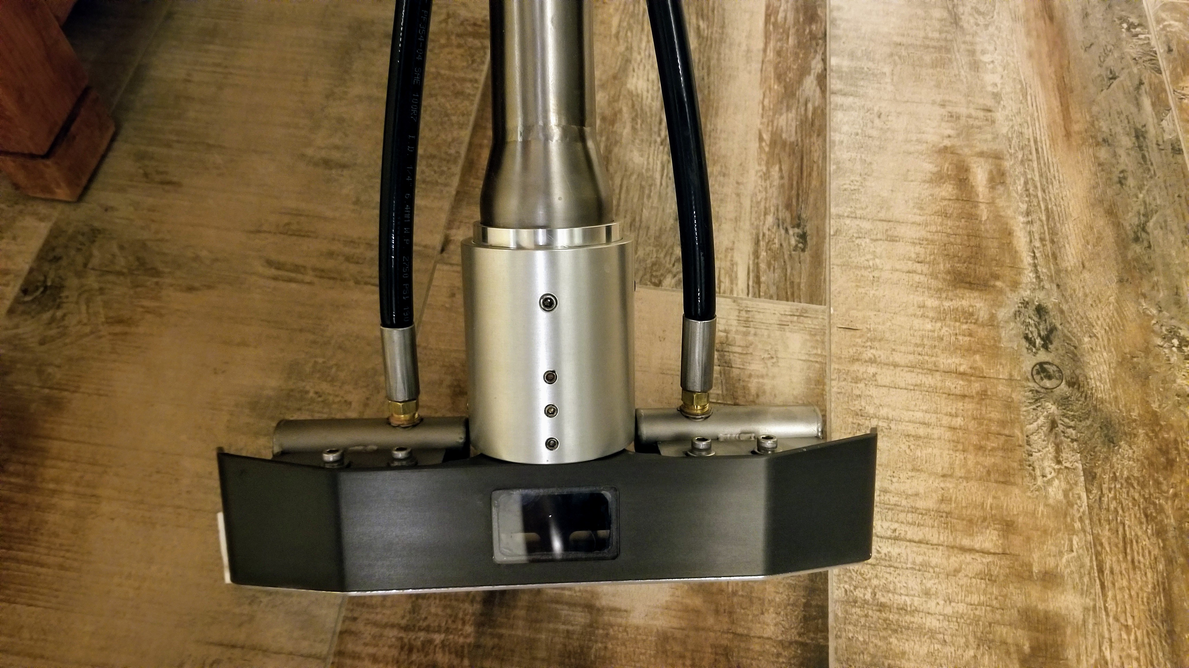

Why haven't any wand manufacturers tried this yet?

Probably because nobody would by it.
What's so special about it besides the large amount of labor that goes into making it? It looks odd to me.

It might be alright. They moved the expansion chamber closer to the floor where it's needed most. I guess

If the 2" flare makes a real world difference ie a vacuum reserve buffer, then a full 2" tube to those small girly hands 1.5 hand area would surely work better.
more tube = more buffer = more effect..

It is a Devastator 1.5/12
The first is a 2" flair to the head.
So effective Marty needs a hole glide to use it.
I'll start drooling when I see a Mach Glide on that head. Until then...

That "High technology" is not worth $1500

Makes sense to me. The 1.5" tubing provides more lift but less CFM than 2" throughout. So having 2" closer to the floor would allow more water recovery initially and then the 1.5" would provide quicker evacuation because the lift would take over likely creating a cyclone or funnel type of effect. Will work well so long as it flares back out to 2" at the vac hose attachment to keep up with volume which I'm sure it does.

I would like the physics data for the devastator wand as well. Any spec sheet with blueprint with dimension. Ill see if i can come up with why it worrks great...
