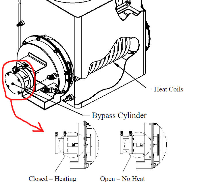

So I havent got the temp control fixed or working! low 195, med 215 , high 245 something liie that.
My 405 I could turn the heat exchanger off and the machine would produce less heat and never bypass. It will sit at 200 ATM all day. I turn on the heat exchanger it will blast 240 consistanly ATM.
the temp dial when working correctly can be set from 100 to 240 and it will bypass to maintain that tempurature.
I wonder does the 570 have the ability to divert heat exhaust out away from the heat exchanger and run cooler without bypassing water like mad????
Or is it just designed to produce massive heat and bypass excess heat without diverting the heat away Some time I would be happy to have it sit at 200 without it bypassing.
I was told there are older models thst do divert.

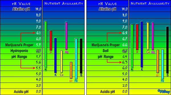

The other thing is I'm using more green products so I can recycle the water to plants and trees. but I would prefer to waste as little water as possible

Sam I haven't studied the heat exchanger yet but I'm pretty sure that it uses a vacuum pump to move an exhaust diverter. I don't have the dial, I have low medium high. Since the exhaust is buried inside of the water box you will get at least the temperature of the bypass valve used. Changing the temperature lower should close the exhaust diverter causing the water to heat less. It will only bypass into the waste tank when you exceed the set temperature.
regardless of the product plants like a certain ph to grow properly. Grass for example if you raise the ph of the soil will probably die. Most plants grow well in slightly acid soils. I grow lettuce in 5.5 ph. You can use the water for plants but to much in the same area over and over will raise the ph of the soil causing negative results.

I've dumped on my lawn and trees no chemicla burn yet, mostly I aim for trees.
The ph doesn't burn them. They absorb the nutrients they need only in a certain range. Outside of that range key nutrients are locked out. If the ph is to high or low they suffer. Iron for example isn't absorbed at a higher ph. All plants are different but most prefer a slightly acidic soil. In the chart, marijuana won't absorb any nutrients if the soil is above 9 ph. No I don't grow marijuanaa but they always have the best chart and most up to date info. They still absorb the water but you starve them from the nutrients they need. If you water the same plant to many times the damage will start to show with yellowing first.

Sam - as Gene mentioned there is an exhaust diverter that either sends exhaust through the HX or around it. The diverter moves in or out by means of a Bimba pneumatic cylinder. By your description (temperature knob continuously variable) I assume your machine is serial 343 or earlier. Later models used a 4-position switch and were setup slightly different.
So, basically - as the temperature increases above the setting the temperature switch closes and sends 12V to a solenoid air-valve (Mac Valve). The air valve switches vacuum to one of two ports on the Bimba air cylinder, causing the exhaust to be diverted. When the temp goes back down the process is reversed, closing the diverter.
Possible causes:
  • No power to the thermostat. Unlikely, as it gets power from the same place as temp gauge and hour meter.
  • Bad thermostat. If the dial is set colder than the current temp it should send 12V out.
  • Broken wire between the thermostat and Mac Valve, or bad ground wire to the Mac Valve.
  • Bad Mac Valve. When it gets the 12V from the thermostat it should switch the vacuum ports.
  • Broken, cracked or kinked vacuum lines - one from the blower inlet to the Mac Valve and two from the Mac Valve to the Bimba air cylinder.
  • Bad Bimba air cylinder.
  • Linkage issues from the air cylinder to the diverter valve (i.e. the clevis pin fell out or something like that).
  • diverter plate stuck (gummed up with exhaust deposits?).
  • There has to be at least 7 in Hg at the blower inlet or there won't be enough vacuum to move the air cylinder. Unlikely - if your vac is that low you would have noticed!

Its 403 or something like that and I have the temp switch that says off low medium high 4 position switch! My question is more for sapphire if the temp switch is working right and I put it on low temp does it stay at 195 degrees by somehow not using the heat exchanger and diverting? thus not dumping like mad? I told my distributor they said they put a call into sapphire I've never been called back by Mitch or Empire.
Mitch told me months ago that the switch maybe bad. The pump out had a diode on the machine that popped and they cut it off and bypassed it with a wire so now if the pump gets over loaded it will trip the breaker on the machine.

I when I got down there they only tested the heat temp valve at the back of the machine and determined it was opening up at the right temp. Even though I already figured that out. I dont think they get what themp switch if for and that it should divertto control th temp better
Yes - if it's working properly the diverter opens and sends exhaust around the HX coils instead of through them, but the exhaust is always preheating the water in the water box, so you always get some heat input.
When you set the temp setting on low how high does the actual temp go?
Possible causes:

Listing every nut, bolt and wire makes it seem that way, but basically a thermostat runs a vacuum-operated diverter valve. In the grand scheme of today's world that's not very complicated....
(says the industrial tech who works on way more complicated controls every day - I forget sometimes not everyone does this all the time :icon_redface:)
It can be off or low it goes to 240 to 280 until the by opens up when that happens if the machine is getting full the vacuum drops dramstically
