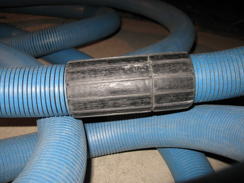

if you haven't used the cuffs I put in the picture you don't know what a cuff is supposed to do and how it doesn't need the latch, the latch is a bandaid for a poor fitting together or loose fitting cuff, the cuff doesn't have to fit tight if you have the latch and that is why the current models need the latch because they are not made nearly as precise.

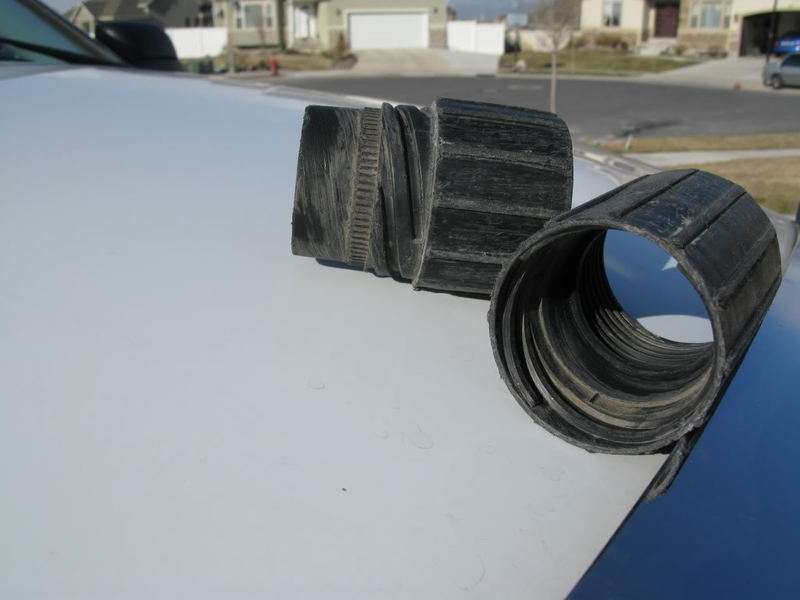

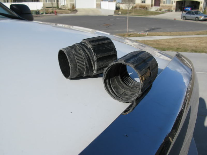

it appears that I was the first guy on this board to ever use cool cuffs, because no one has seen or used the cuffs I am showing at least noone has said so, these I bought in early 04 to the best of my knowledge for another reference it was before saul tried to copy them with the gray cuffs. if you are clamering for the latch you HAVEN'T used these cuffs, they don't need them, the swivel ideal is not needed either, just these simple WELL made cuffs, IMO the problem with the new cuffs if you look carefully at the difference between my originals is the length of the taper on the old ones is TWICE as long, is more gradual and longer, the new ones are short and abrupt, keep in mind these have seen 6 years of hard use, use beyond what any carpet cleaner would do to them. its not uncommon for me to suck up mud and other debris on water damage jobs, and they STILL work better than a new set, these style of cuffs I only remember about 4 times ever coming undone in 6 years when I didn't want them to, and that was rolling up a cluster phuck of a pile of hose. I think anyone here would trade needing the latch if that was how they worked without it.
new style
old style
notice the far more gradual taper of the old ones.
