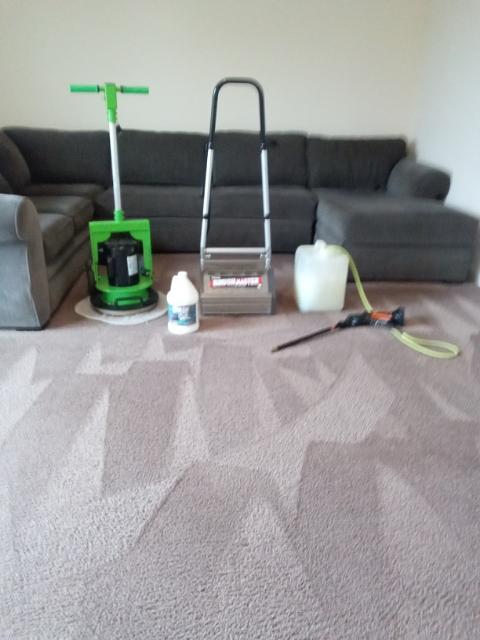

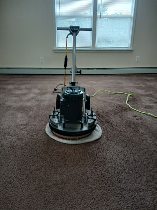

Don't use a Buffer
Most of the work is done by a $3000 dollar 14'' CRB and it's worth every penny
Then a OP Machine - TOPS Odyssey or Tankless Vibe
