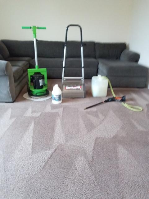

Let's not overcomplicate cleaning carpet
The TM Manufacturers want you to spend Thousands on something you don't need today
And it's not necessary
Unless you don't like Money
Cleaning carpet doesn't take $30,000 plus in equipment
The experts say 85% is removed with a Vacuum
That leaves 15% that's sticking to the Fiber
Cleaning Carpet is a Very SIMPLE and EASY Process
Detergent Scrub Remove
LESS water MORE agitation !!!

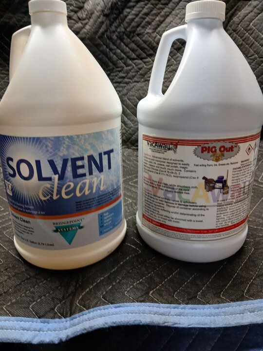

Kenny,
What brand of dry volatile solvent? Do you recommend?
I've been using VacAway Pig Out for over 10 years but it was out of stock for months so I had to find another brand
I started using Bridgepoint Solvent Clean
They both work great but Solvent Clean has a little less order

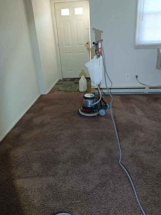

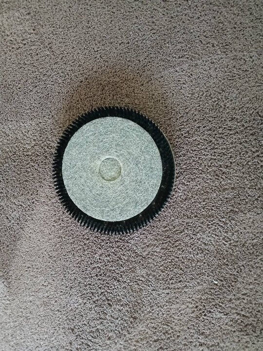

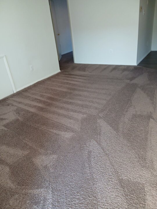

Still experimenting with my Hawk on Apartments
This time I used Bonnet Pros Multi Brush with his 14'' Fiber Pad to scrub
Extracted with 17'' Microfiber Bonnet and 15'' Driver
Groom with 10'' CRB
5 oz of Carpet Details no peroxide
I love VLM !!!
