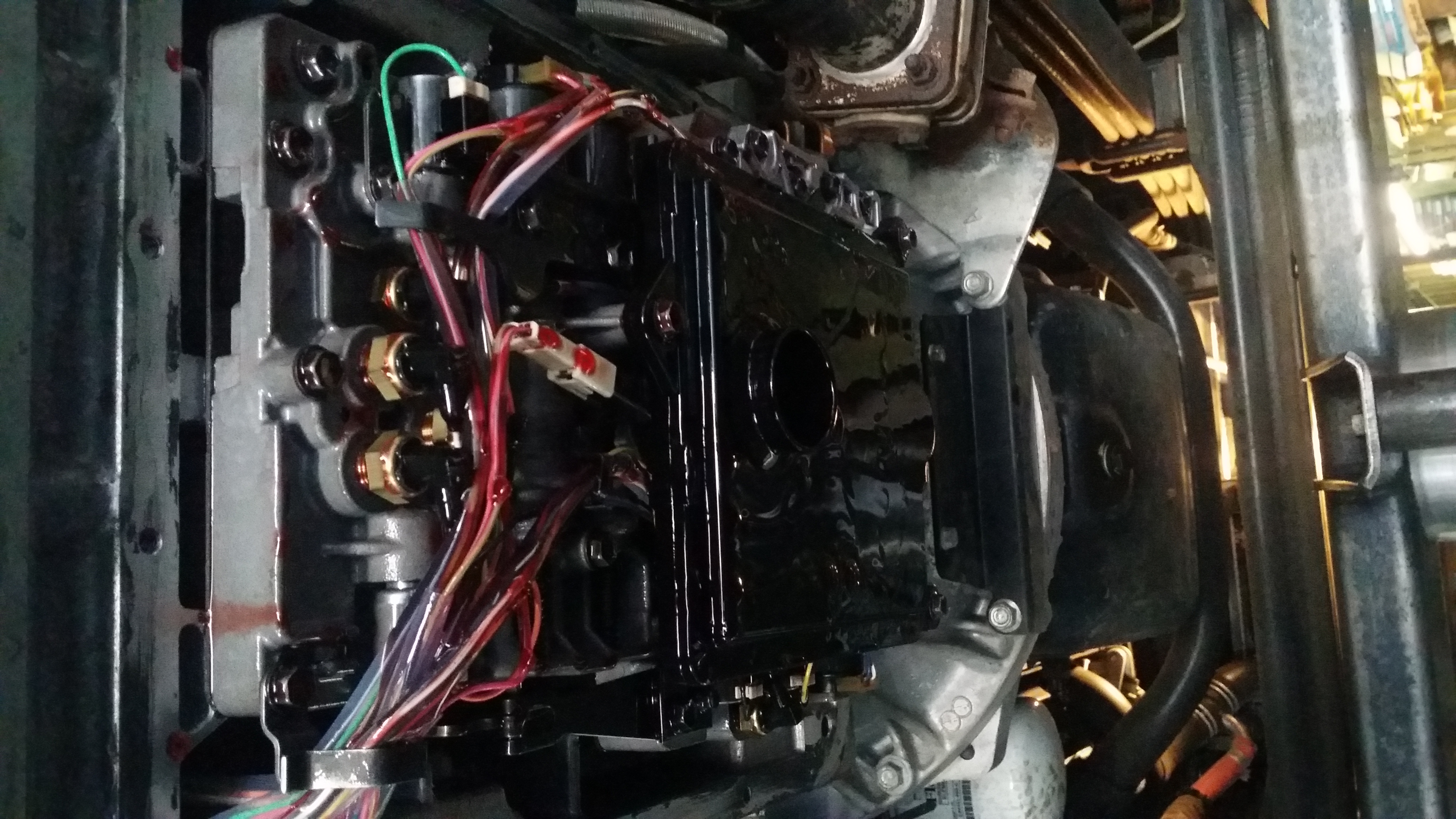

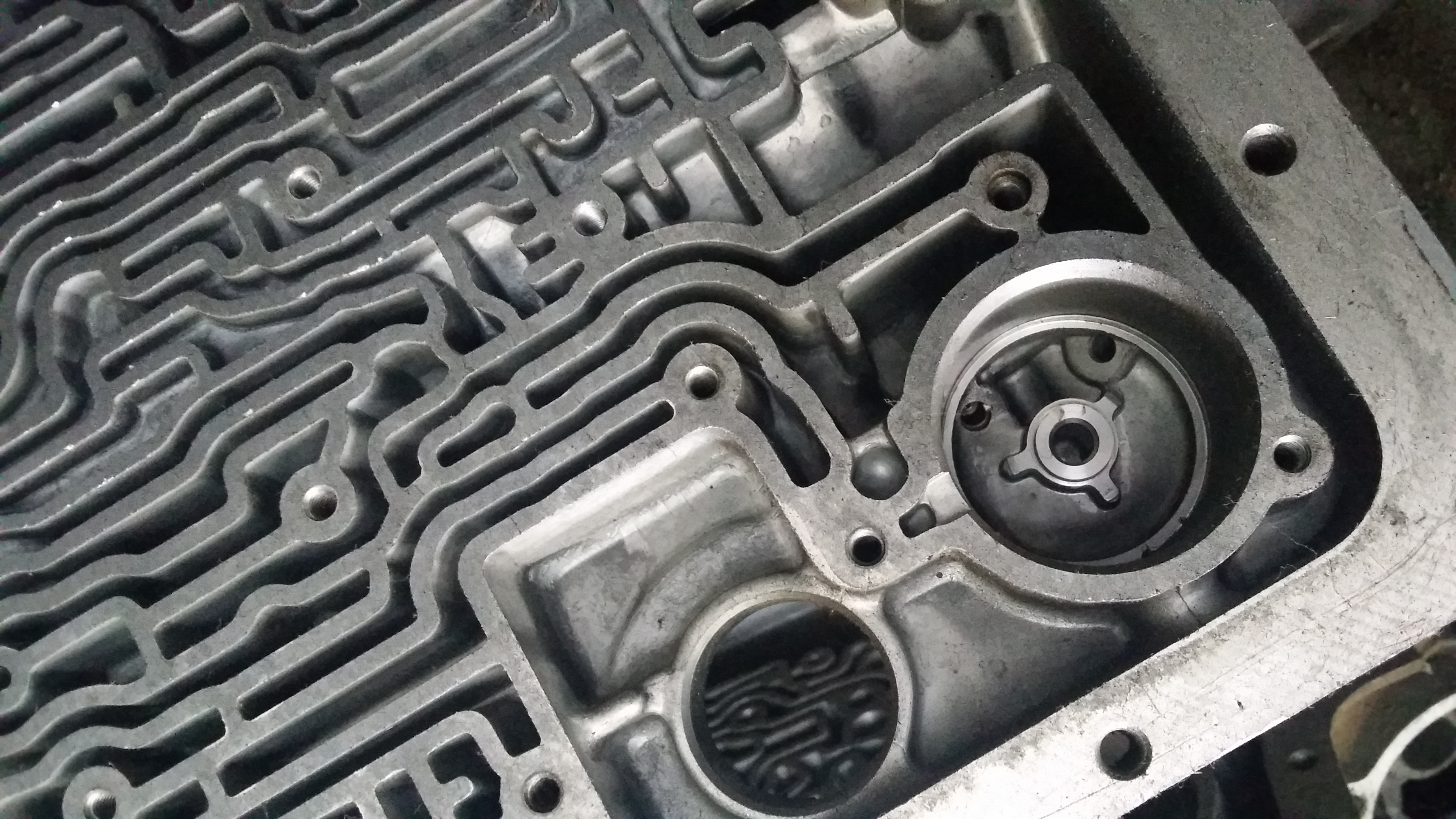

115,964
I go 100 hours on mine.
At the tranny guy now getting a full service, flush and filter
$250 worth of fluid alone..yikes
Ever seen inside an automatic transmission? (Not mine)
