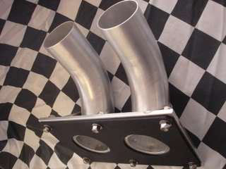

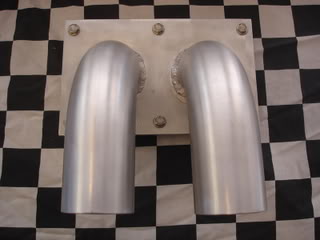

This isn't directed at Mike as he's probably spot on with his measurements, but every time I hear about 28 cfm more etc... I think of Bristor and his $99 cfm gauge. It's more than just numbers, every time you introduce a "Y" especially one like Joe's offset Y, you introduce turbulence, at some point a single 2.5" hose has hit the point of diminishing returns and frankly is less expensive, and less hassle to use.
And to answer Steve Snail, on a #4 blower with a 2.5" intake, I think the law of diminishing return will kick in, so No I don't think you will notice a vacuum increase by bolting one of my 2.5" elbows on the tank, your stock twin 2" plastic fittings are fine.
