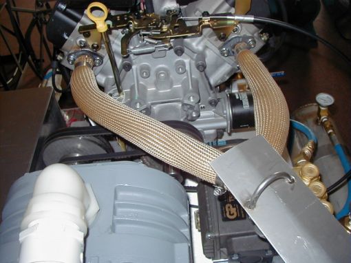

John;
Exhaust wrap is "old school".
Exhaust tubing gives you better insulation and less heat loss:
It also lasts longer than the wrap on this Kohler 31HP engine.
Larry
Duane Oxley
Moon Unit
Oct 18, 2006
2,379
Smyrna, GA.
Duane Oxley
Does it work well enough for you to grab the exhaust manifold while the system is running, and hold it for a few seconds?
