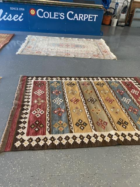

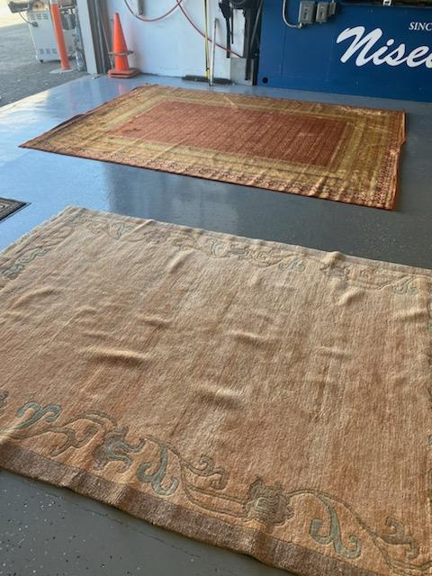

red one in back is 100% Viscose
tan in front is wool...
all wool..
Olefin
demo rugs for the Vegas MF IICRC class...

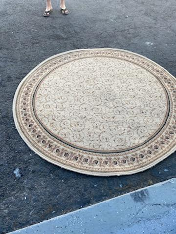

The round one can be cleaned in the driveway. CRB and dirt swirling will actually take longer than extracting, so why not do a better job of cleaning?
