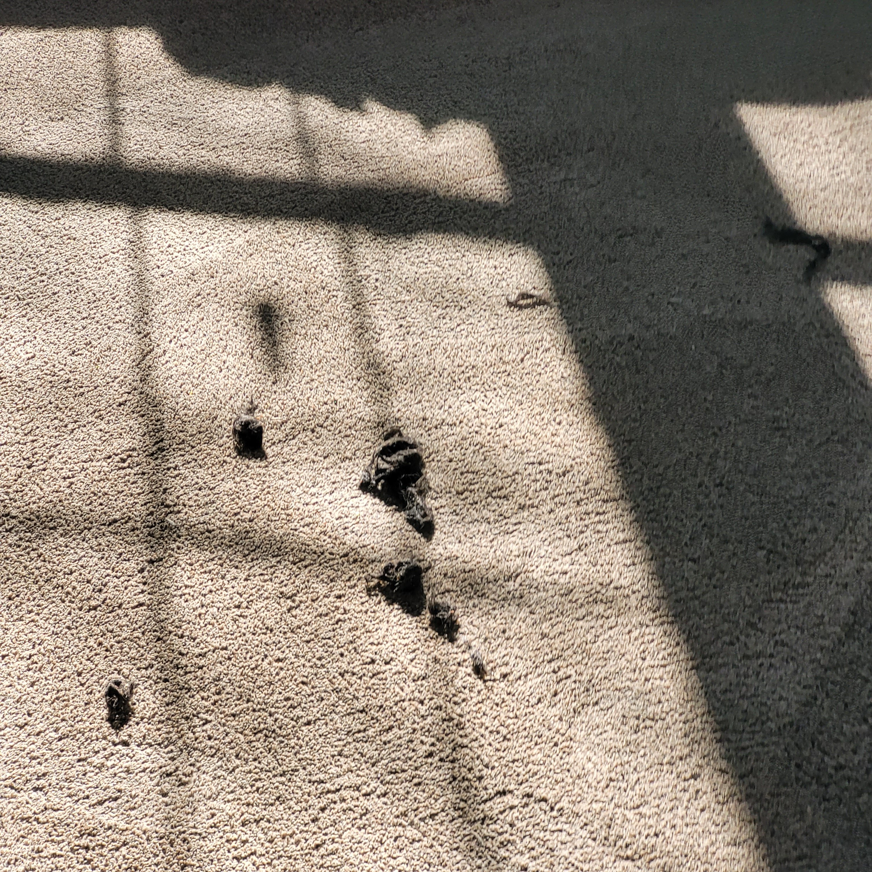

In the world of HWE, imo wicking is most likely to occur in entry areas and high traffic areas. DIY homeowners and new techs are both prone to over clean/ saturate these problem areas with gawd knows what..
I believe my instructions are sound, especially in humid Florida.....
But I'll probably take the peroxide option out.
You're right, your instructions are skunk, I mean sound. I have to agree with your assessment about the wicking. When using CRB, I always get stuff flying off the surface( usually dog hair mixed with human hair and mud in the same areas. My theory is that beat-down padding gets saturated with soiled water and since the carpet is drying from the bottom up, all that scum has a tendency to resurface. I've seen the same pattern over and over, and I wish that I could turn jobs like this down.
Here is the pick from using CRB at the transition points, to support your assessment.
