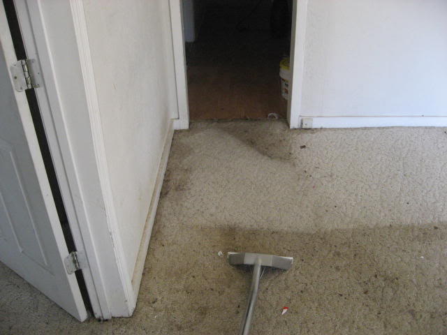

who's afraid of dirt....
a typical empty in a student rental town
no big deal, just a normal dose of PowerBurst at appx 300sf pr RTU gal will get it cleaned to the level they're willing to pay

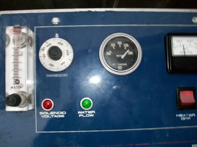

heat helps..

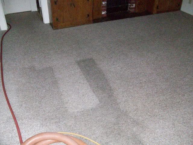

this one is for you vEEgs..
Normal duty cycle with our 09 flow Ti.
BTW, "normal" duty cycle for us in "empties" is 15-20 seconds on, 2-4 off.
In res we do slow dry strokes, but not in empty rentals

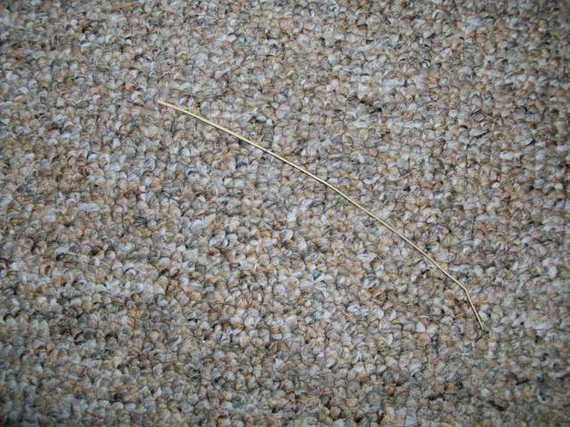

This one is for MARTY
Look what I found...
49,343
Now, imagine running across that piece of straw every 4 or 5 feet, in ever room, of every apartment. Your vac won't pick it up. It clogs up your wand. All you can do it cuff it up.
PITA

Rake. And if it clogs up the wand with that V blower, you may try attaching the vacuum hose to the machine. It should be in the owners manual instructions.
49,343
Well, in your own left handed, down under way, you have hit a point. My bad memories in relation to the straw are all associated with a 36 blower. I haven't gone through the rental turnover season with my new V yet. The 6008 blower might just make a difference, if I weren't using a glided wand. No way that straw is going up a hole in the hole glide.

Larry;
I do have a question.
Why is the heater light on with the voltage reading 60 volts ?
Larry
junk volt meters they put on PMs.
It's not uncommon for them to go south
Maybe the vibration, I don't know.
Not worth replacing to me, cause I know the generator puts out enough volts at anything over 2600 rpm

Why is there so much straw on your customer's floors, Marty ?
Do you have thatched roofs ? In UK in some of the older homes I'd see a piece of straw.
Or do your customers use straw brooms to sweep the carpet like they used to on dirt floors ?
