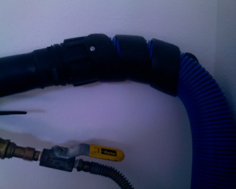

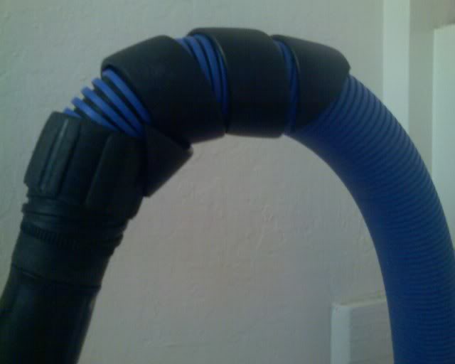

Us high heaters have to deal with our hoses folding/collapsing about once a week.
Especially when using your wand on staircases.
Not any more.
Ask your local hose shop for some in 2". It's used to bale other hoses together. Sorry but I dont recall the name of it.
yes , that's a genuine Cool Cuff. Love it, hate Joe!

That's a very good idea, kinda like the steel braid on the the KMA hose from greenie.

"quality" hose can be viewed in many ways, from Meat's comments i see he is referring to a stiffer hose, most stiff hose is what these guys with 2" wands are trying to get away from.
Stiff hose might fly in Apartments, but in furnished homes it's the number one reason guys don't like to use a 2" wand.
Enter the eternal quest for the high heat, durable, yet still flexible hose.
Either way, those hose bend restrictors are still cool!
