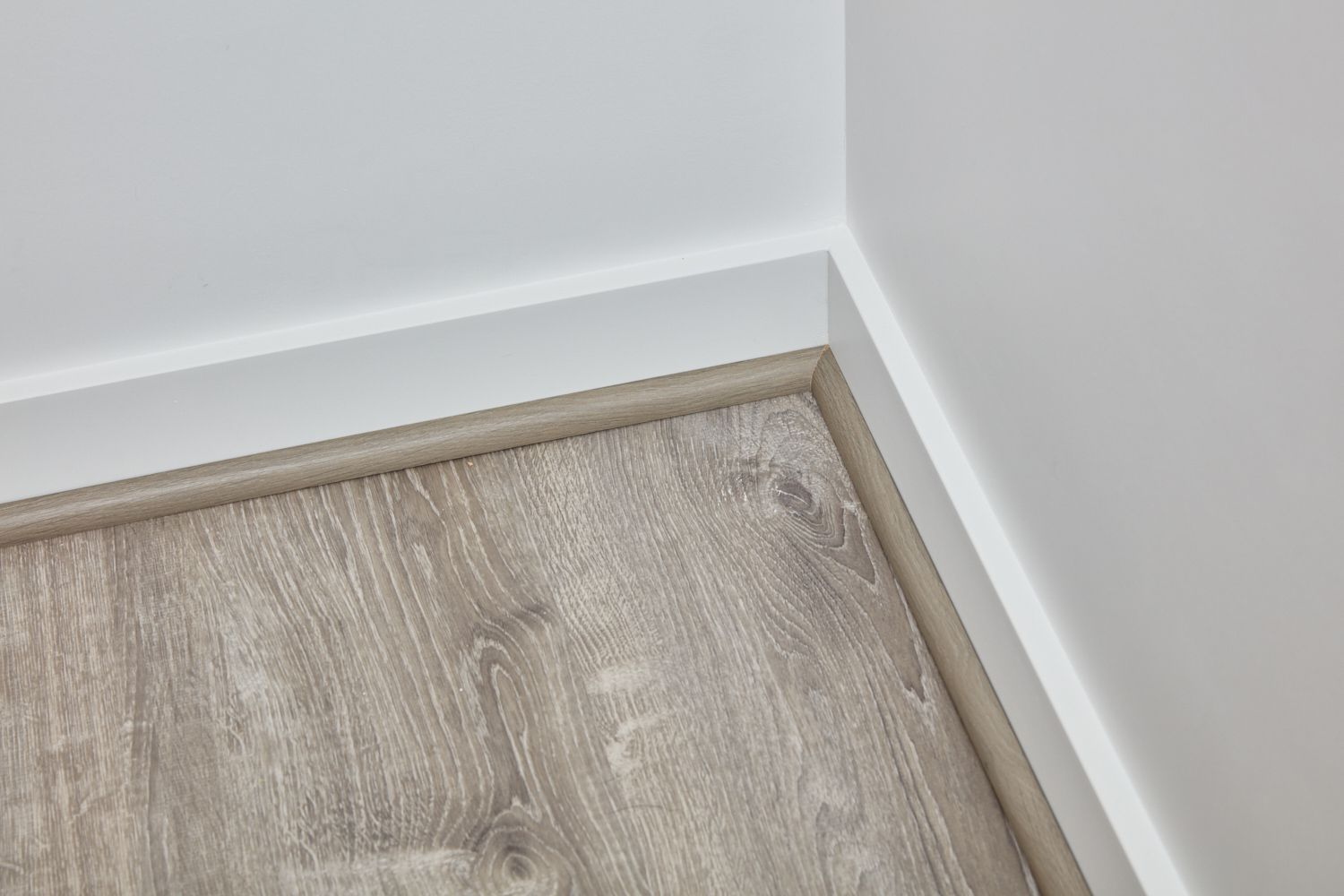

LVP should be installed UNDER the baseboards so that it can "float" (expand and contract). It's super common here for people to tear out the old flooring, or lay the LVP over the old hard surface and butt it up to the baseboard and install quater round to hidw the gaps, inn oreder to save money, and time...
Looks like shit imo/
then it wasn't installed right.
nothing wrong with 1/4 rnd, but thinner shoe mold looks better.
and if they want colonial doorstop for shoe, (what that first pic looks like to me) which I agree looks much nicer, additional cost's apply
(material is more expensive)
otherwise, MDF is trailer park crap as far as I'm concerned and it's not worth pulling.

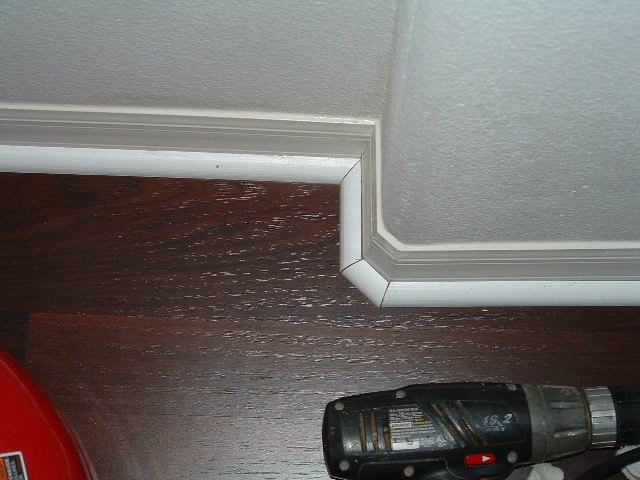

Now, let me help you so you don't sound like a complete idiot
that's the only molding that's finished in your pics

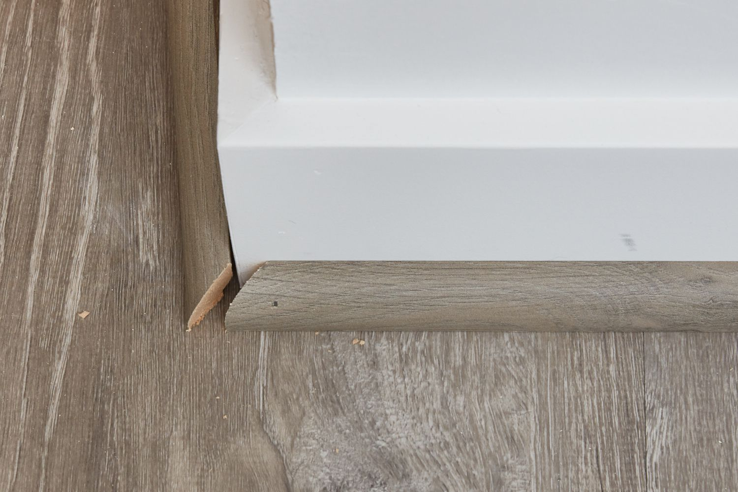

That one's not finished.
Needs caulked and painted same as base mold to look good.
It would look fine then

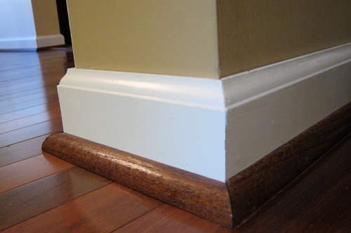

that one's the wrong color .
Shoe should be same color as base.
That would stick out like a sore thumb regardless if profile'd shoe was used.
