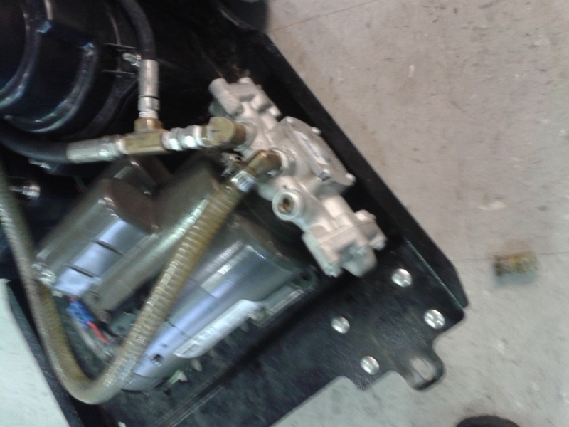

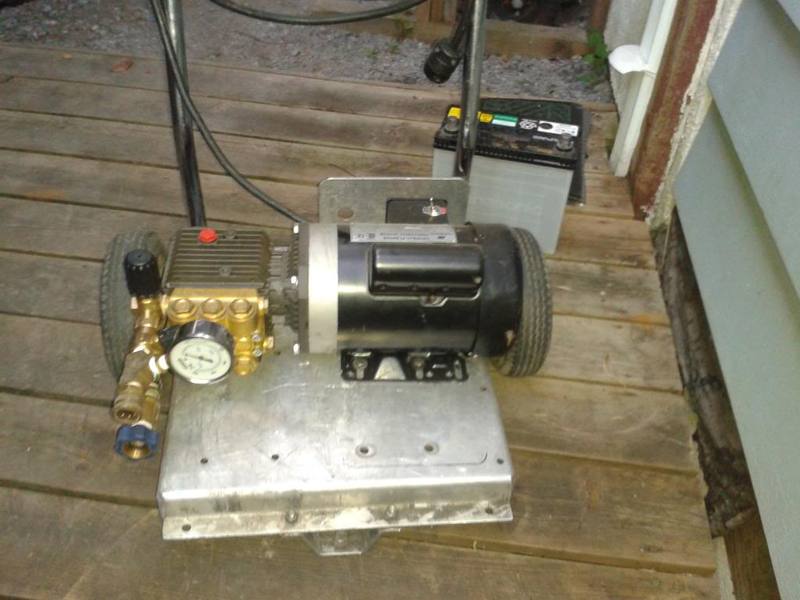

This is a direct hook up pump ( You might remember this one Mr C- ya sold ot to me), plenty of oomph for tile, can also be used for carpets.
pimp on a cart. I can just drop a hose in my tank to suck water for the pump or directly to a faucet. -
Now about the extractor pumps. I've found pumptec don't drop as much in pressure as the cats does. When I key the same wand open on ninja number one (cat ) set at 350 the pressure drops to 225. Do the same on ninja number 2 (pumptec) the pressure only goes down to 300.AW20 1101.5 jets. The problem with both pumps is the aluminum construction. The cat does appear to be "dipped".
I've found choking the flow down to a 3 instead of the 6 flow I was using increased impact and not dropping 3200 pounds of pressure when keyed.

And for all purposes the General (cart) pump is superior to both the pumptec and the cat- except for amp draw.

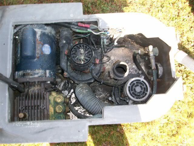

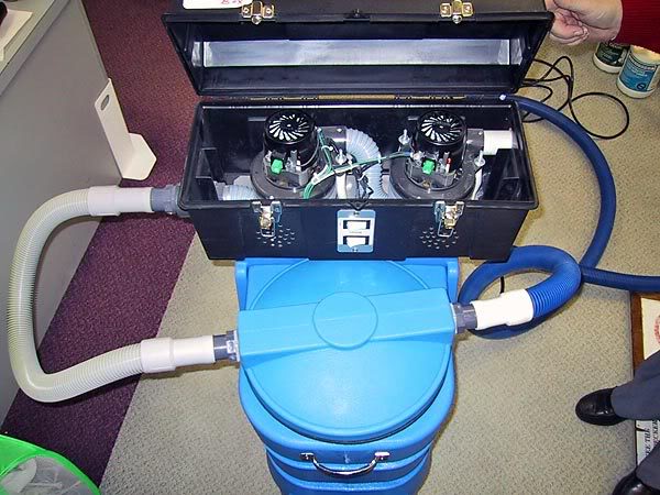

I know I've posted this before, but here's a general shoehorned into an old school ninja body. I ran the tool box vac booster to get some serious suck. Too bad it got burned up in a fire.
vac booster
Body with General lower with baked booster - the 4 two stagers were phenomenal in vacuum. Both units were rendered useless by a fire. That WAS a high performance portable.
