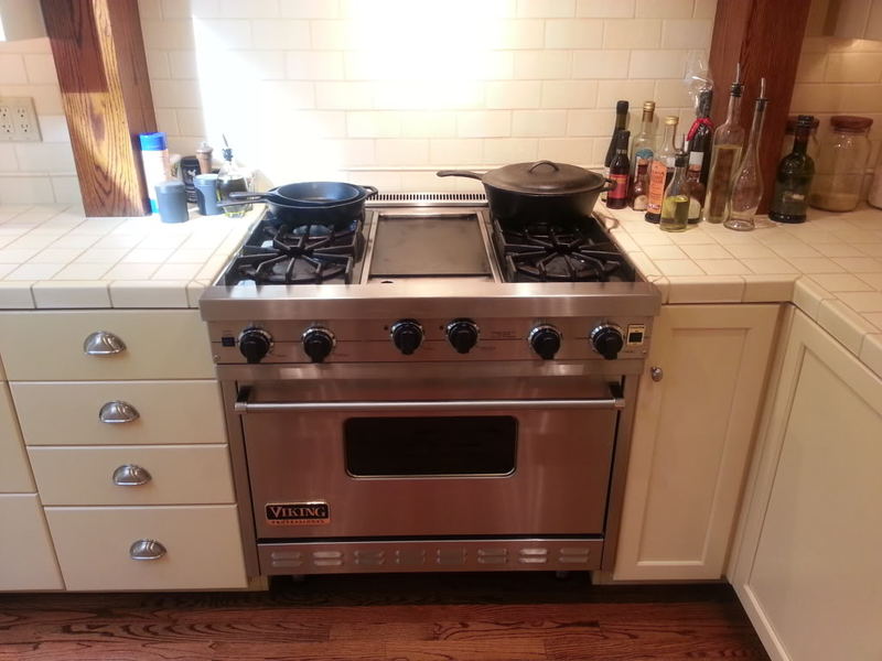

What in the hay is going on here..
117,254
10 year old install.

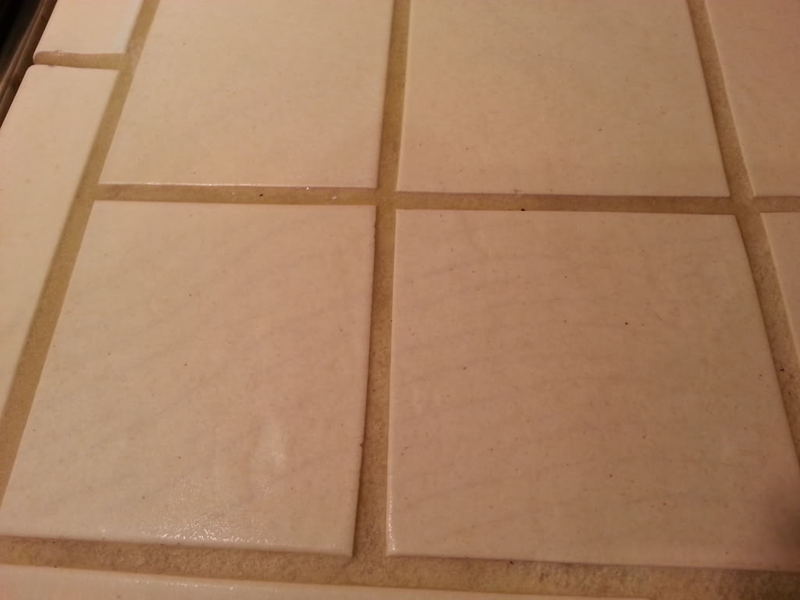

She cooks a lot as you can see by the butter absorption in the grout near the range. It's the veining/ stretchmarks like lines that have her and I mystified. She claims they started showing up just recently..
For the most part the lines/swirls only show where some heat form cooking or coffee is happening.
Its a very delicate ceramic, lots of chipping going on.

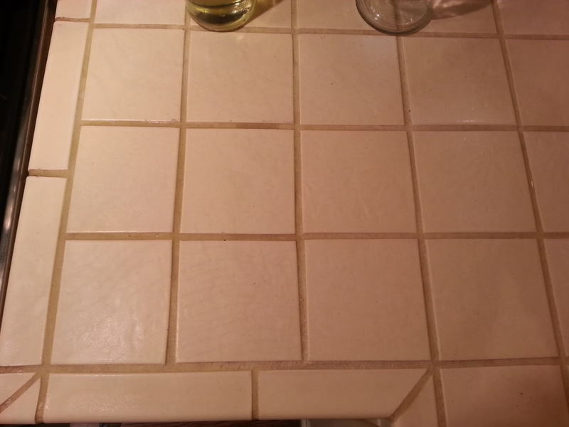

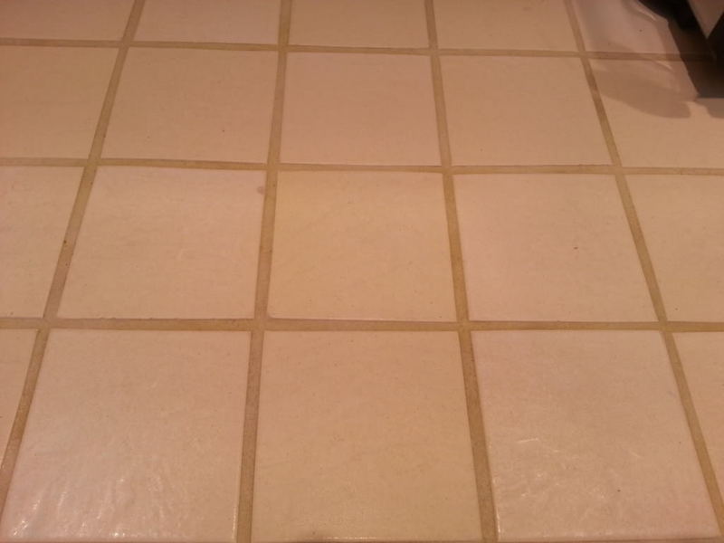

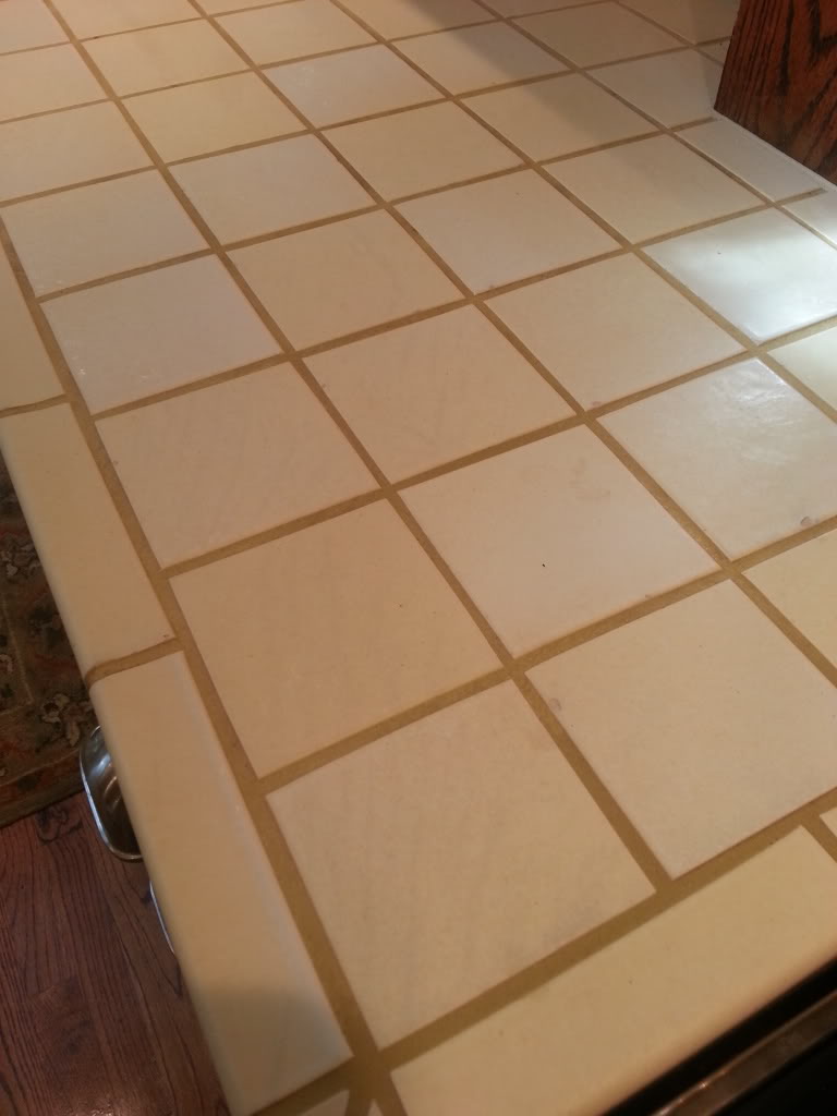

117,254
Could be heat but on another counter it's happening as well with no nearby heat source.
Im going to try and color seal. Dont have high hopes of it sticking.

Looks like the glaze is getting hairline cracks or something. I've seen this several times before but never really knew what it was.
clean image
Oct 5, 2012
971
Carl Maddock
cracks in the bisque, glazing remains uncracked, moisture, even atmoshperic, will travel up cracks and transluce thru glazing as a shadow, with the glazing magnifiing the situation
If you feel with your nail, you prob can not feel cracks. Sometime they will open and close with heat.
Why they cracked like that is intesting. Base material is stronger than the tiles.
Definate color stain to minimize migation into cracks, cause they can bloom even bigger
I was thinking along the same lines...but assumed a tile vs glaze mismatch

She probably set hot pans directly on the counter from the cooking top.
