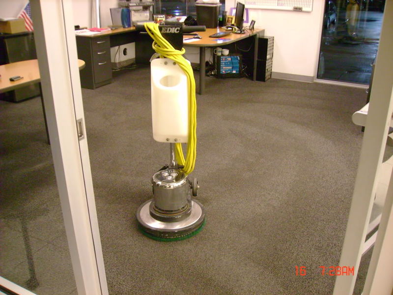

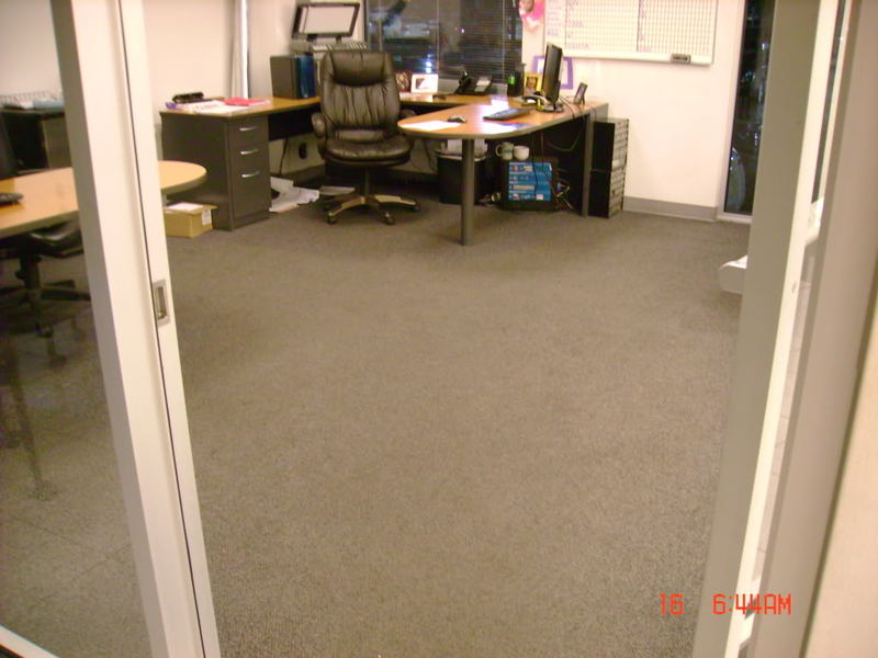

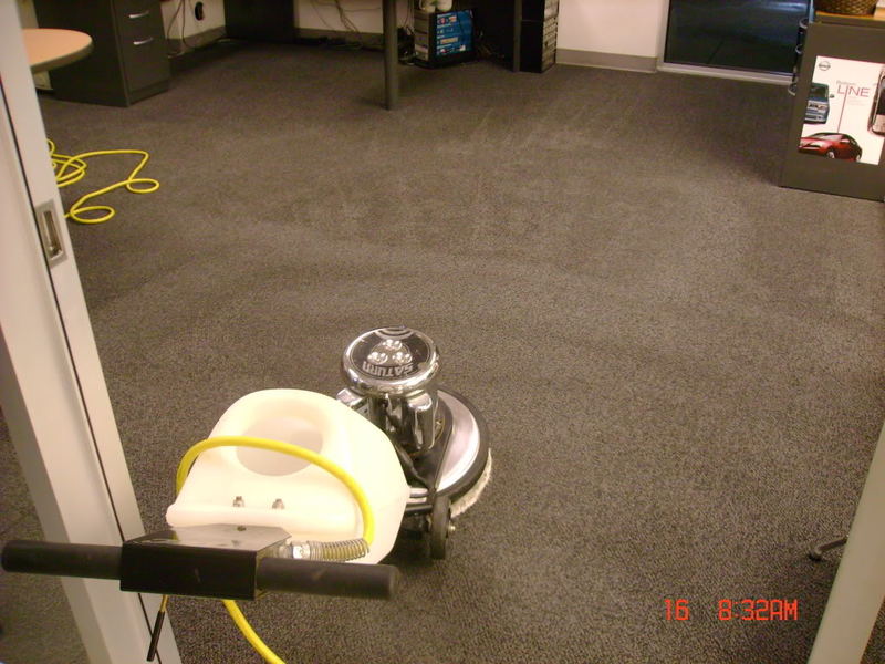

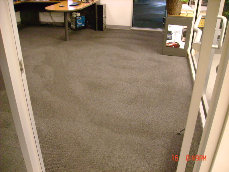

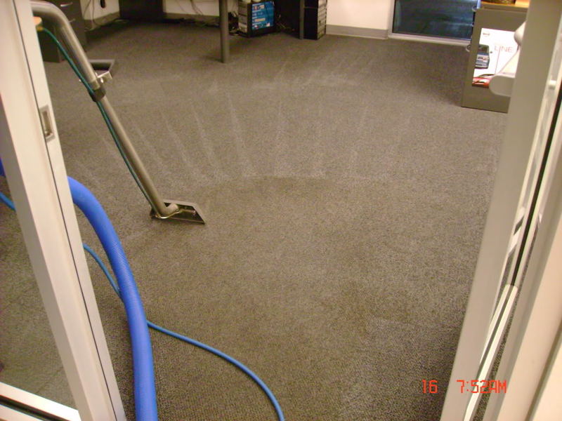

Well here are some photos. I learned a few things about scrubbing with a green pad. I tripped a breaker and the pad was wet and the carpet also plenty wet. I had to flip the pad over to the used side. The unused side was too rough. I guess the pad needs to be smoothed out over concrete. Anyways I am going back to using my brush. When the sales manager comes in tommorow and his computer doesn't work he is going to be po.
Before
A good precrub does wonders.
Look at the difference
Wow padding makes a huge difference. I used three pads for best results.
All finished and no grooming cause the cleaning ladies were coming after me to empty trash cans etc.

well 1st....them are some fugly pictures...hard to pick out whats what in the carpet
2nd where is your glide???
3rd hell yes encap that bitch and be called good.....sometimes you just cant fix it :cry:

A lot of carpets clean better without a glide if you need to scrub on it. This carpet would be good for a glide though. I have another 4 jet that I would like to put a glide on for cgd jobs like this one. By the way I am not weak and can push my wand without any problems. I just need the glide to prevent chattering which was not a problem on this job. But if you think having a glide is going to clean better than what I just did, you are brainwashed.

Dan the job looks fine....
I am with Marty....on the EnCRAPing ...
Sweeny is also correct...
The photos are from a cell phone & distort how clean the carpet really is..
AGAIN...Loose the pads...You can use your "juice of choice"...&..SHOWERFEED
it through your STIFF brush and get BETTER results and save TIME...

Uh you might want to check the photos out there slim. I did pad the carpet after I steam cleaned it with 3 pads. If you mean to only buff the carpet without extracting it then heck no I would never do that especially on a carpet loaded with soil. By the way I went back today to pick up some blowers and the carpet was sparkling and it never looked that good. The manager was all smiles.
