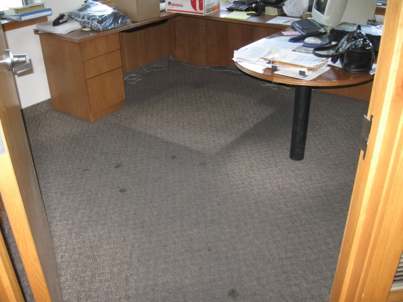

I cleaned a freight company office today. HWE with 220-240 ATM... Greenhorn wand ten flow, bumped the pressure up to 500 PSI. Used a strong solution of bridgepoint Zone perfect mixed with citrus solve. I used Power-Point in my head-cap jug metered around 4 or 6 gal/hour.
I pre-scrubbed with an adsorbent pad and post padded with cotton. You can still see where the mats were. Is there something I am missing?
And yes, that's my helper in the before pic...
I don't really know what I was thinking with the last two pics. I didn't keep track of my before and afters too well...
Anyway, lemmenowhachathinkin...

Try pre scrubbing with a Red pad next time and trigger spraying some Encap and 30 vol along with your post padding, but once a carpet is that bad it will never be 100% again.
They should be thrilled with what you did.

Mikey, what are these red pads you are always talking about?
You want me to use a cotton bonnet AND peroxide? Or did you mean another 30 volume I am un-aware of...?

But my bonnets won't be rinsed out until I get back to the shop... that's my point. And yes, I will be careful with the peroxide on nylons.

What Mikey said!
Mikey schooled me on the Red Pad for pre-scrubbing and it kicks ass on the nasties!
I had to bring out the Red Pad several times this week! Nothing works better for restoration scrubbing.
My favorite "hero maker'' is a real dirty lite colored Berber :p
I asked Kyle what his favorite carpet to clean is? He gave me the same answer, I was kind of proud of that because some cleaners seem to have trouble with Berbs, clients have brought this up as well after having heard they are tricky to clean. I know most of us think differently but that school of thought is out there.
Wear your Red Pad down on concrete for a minute or two before scrubbing carpets and we only use the Red on older carpets.

After you prespray rub your shoe on a couple areas. If it doesn't make a clean spot you need to mix a different or stronger prespray.
The red pad is the one used for scrubbing vct. Keep it lubricated and you will be fine on commercial. I like to run a little old school shampoo through the scrubber.

First thing I don't get is why you're using Zone Perfect when you have carpet in that condition. If you're a bridgepoint man you should of at least been using traffic slam or flex, I probably would of pulled out power break myself though and mixed for heavy soil and applied it liberally 1 gal per 100-150 ft. You need to choose the right chemical for the job, and I'm one that leans towards going above what is recommended and let the chemical do the work. Boosting those with some citrus and some H2O2, roto scrubbing with a 175 with at least a white pad and rinsing with an emulsifier (which I think you did) would of done a lot better. Don't worry so much about carpet warranties when the carpet looks like that....the warranty is gone. So you're job is to get it as clean as possible and if the customer is worried about the protector you can sell it to them of course. In my opinion based on what you used I'd say you under cleaned that job. Now if you pulled out the big guns like I said above and got the same result I'd say you did your best so you need to make sure you are using the right tool for the job.

If you think Reds are fun, just wait till you find a carpet worthy of a Black :shock:
We did a back room in a KMart once that NEEDED a black pad to rip off the eighth inch of hard crud.
It's amazing the abuse Olefin loops will take.

Yep, Powerburst(if you are a bridgepoint fan Power Break) and a red pad (I would have used a green, but you are not ready for that). I agree with the others, they should be pleased, that carpet was trashed. In an environment like that it is difficult to completely erase the outline of the mat as the fibers are significantly distorted from abrasion as the wheels roll off and on the mat. It just grinds the sand into the fiber and vacuums (if that place even has one) don't do well on the transition when/if their staff is vacuuming.

Quicky suggestion:
Freight company suggests to me that there would be aluminum oxide present (from inside the trailers) as well as some type of oil.
I'd suggest trying some type of FSR, like cyclone (?).

when i run into carpet that is heavily soiled like that i break out the bomb.
Flex boosted with citrus solve, and boost all.
spray it on, dwell 5 min, scrub with 175, light spray again, and extract with power point and bonnet afterwards

B&B I think you did pretty good actually, the only thing I would say is I would have run an olefin specific prespray, like prochems olefin preconditioner, or what I use is prochem renovate, I think they are the same product the first one is just diluted more for what you buy, you need something to break up the oils on carpets like that, and often your standard presprays for rez jobs just aint powerful enough

I like Ice Blue/Baby Blue burnishing pads for scrubbing/encapping. Stiff enought to shear the crap off the carpet & soft enough not to damage anything. No break in needed.
Any way, for mat lines like you have in the pics Releasit DS & Punch at 6 oz each per gallon & 2-3 oz of 30 volume will work wonders, as will Vac Away's Cyclone VLM & BP Solvent Clean. Whatever you use hit it with a scrubby pad & follow with cotton. Personally I like to OP with the pads & juice above... Works out nice. Oh yeah... Place fans as needed.

I agree with the red pad and if you have a cimex cut some little pads out of a big pad to fit the cimex, scrub the crap out of it, you can't hurt it
I would also go with the olefin product line from ProChem, I wouldn't use powerburst, scrup in the pretreat and rinse with the deep clean, you will never get all the dirt out of it with a one time cleaning but can over time with a every 3/4 month cleaning you will
make sure you tell them it is olefin and the enviroment it is installed in because it will look like crap in 3 months no matter what you do to it

Here's why I used zone perfect: I do a monthly greasy restaurant cleaning with GDC. I do two of them a month. I have had the oportunity to try every pre-spray I got, and zone perfect seems to do better than all of them but flex. I don't want to use flex because it burns my lungs, but ZP outperforms Traffic Slam, Procyon and a few others I've tried. My zone perfect is not mixed 1-32 though. I generally mix it 1-16 or more. If I think I need more, I will use White Lightning in my head-cap, but then I have to neutralize it, whereas I don't lose sleep over leaving Power Point in a carpet.

Why would you worry about neutralizeing the carpet in that environment? That is a myth started by chem manufacturers to sell more acid rinse. There are times when you would want to sour a textile post cleaning. That situation is not one of them.
