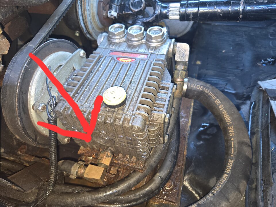

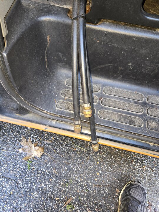

I lost pressure and water started shooting out of my pump. I'm out of time to work on it today, but something I don't understand:
I thought this brass elbow and hose was an oil drain since the hose that comes off it is capped, comes off the bottom of the pump, and is bundled with a few other capped hoses that seem like they are oil drains for the blower. Yet this is where water is shooting out from...

Look in the sight glass on the back of the pump that shows your oil level. If the oil looks white, water has gotten into your oil.
scotty747
Oct 19, 2006
869
Yes that's the oil drain. Unscrew the yellow vent cap on top and see if there's water in the pump oil. Pump is probably shot.
