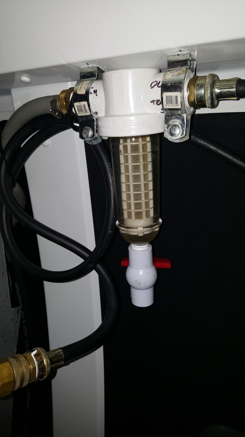

Scott...how often should this unit be recharged...looking through instructions, etc...and wondering what is really recommended.
http://interlinksupply.com/index.php?item_num=AC40
We also have water softner in the shop but also have this unit on board....We are setting up bypass on the system so we don't have to run water through it unless we actually hook up to another clients faucet...
Thanks! :)
