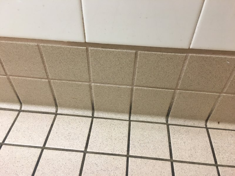

1200sq ft of this and I'll be squirting some ultraseal on it after
14,080

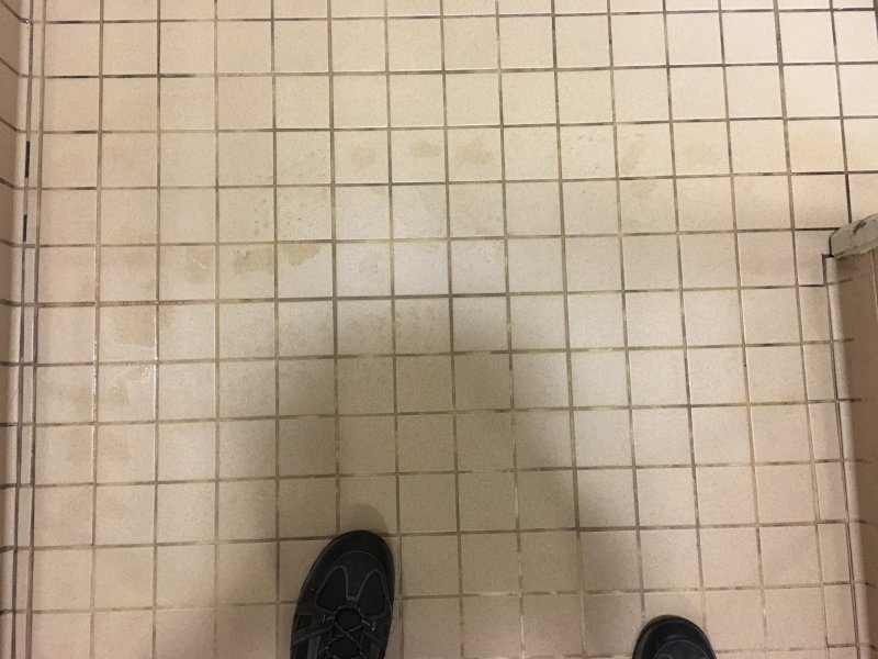

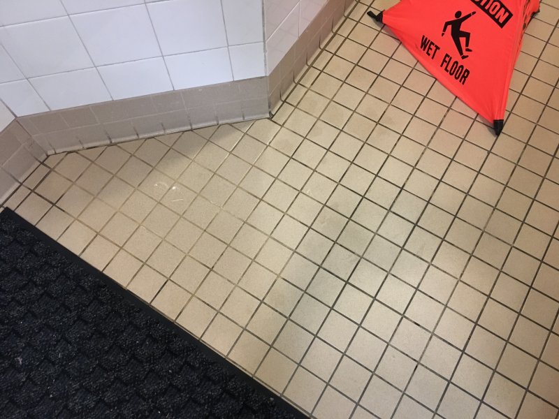

Here's a few tested spots. I only treated it with Saiger's juice, and a little acid after. I didn't let the acid dwell too long, so maybe...
They know it'll be blotchy, so I'm not gonna stress over it

I was thinking the same, but he will do OK on this one.. I would have priced it about the same(and I HATE night work)! They must like him for some reason.. Must be the trailer!
115,929
Any 12 ph powder at 3 ounces per
3 ounces vct stripper
2 ounces 40 volume or Oxy Clean
Long dwell, scrub like mad, dwell some more..
1200 with your new spinner
Cobb's Acid
Scrub again
Spin again
Force dry
UltraSeal.
14,080
Cobb's Acid
Scrub again
Spin again
Force dry
UltraSeal.
How long should I let the acid dwell?
