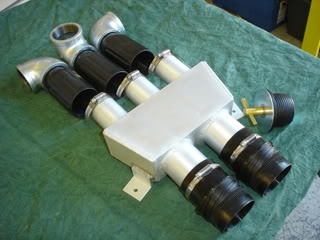

I am still in the process of testing this .....but so far it has been working out great..I opened my third vacuum port on the back side of the waste tank....brought it down and put a "Y" under the tank and connected the front left port to the other side of the "Y" and then ran it to the connections that hook threw the floor that go to the outside.. The right front port stayed the same and is still connected to the other side of the ports that go threw the floor....I then did my normal 4 to the door set up and the increase in vacuum was much..that I was able to back my rpm's down and still have better suction then I did before....I will get some pictures of the set up today and put them up..it is pretty cheap and simple to do...I am going to try and see if I can get my hands on a CFM meter again and test this out and see just how much it increased it...but since my first job after changing it .....every time I set my wand down I can here and feel a huge increase.........even with longer runs..

is the vanifold 2.5 and then brought down to 2 inch...
I was told not to long ago that this would not make a difference opening the third port....when I was talking about trying something
I don't remember what at this time but I can find the thread...

I talked to mike earlier and the difference is I stayed with all 2 inch......
and the Vanifold is three 2 inch going out to two 2.5 inch...

this is all in 2 inch..........
the back left port and the front left port goes under the tank
to a "Y" and then goes over to the fittings in the floor that goes outside...
the right port on the tank just shoot over to the fittings ..........
then do a 4 to the door with your set up..................

it is actually working pretty good...not bad for 2 inch and easy to set up....
I liked to killed my fool self when the tile tool hit a spot and locked down.......other then that a lot more suck for the buck.....
