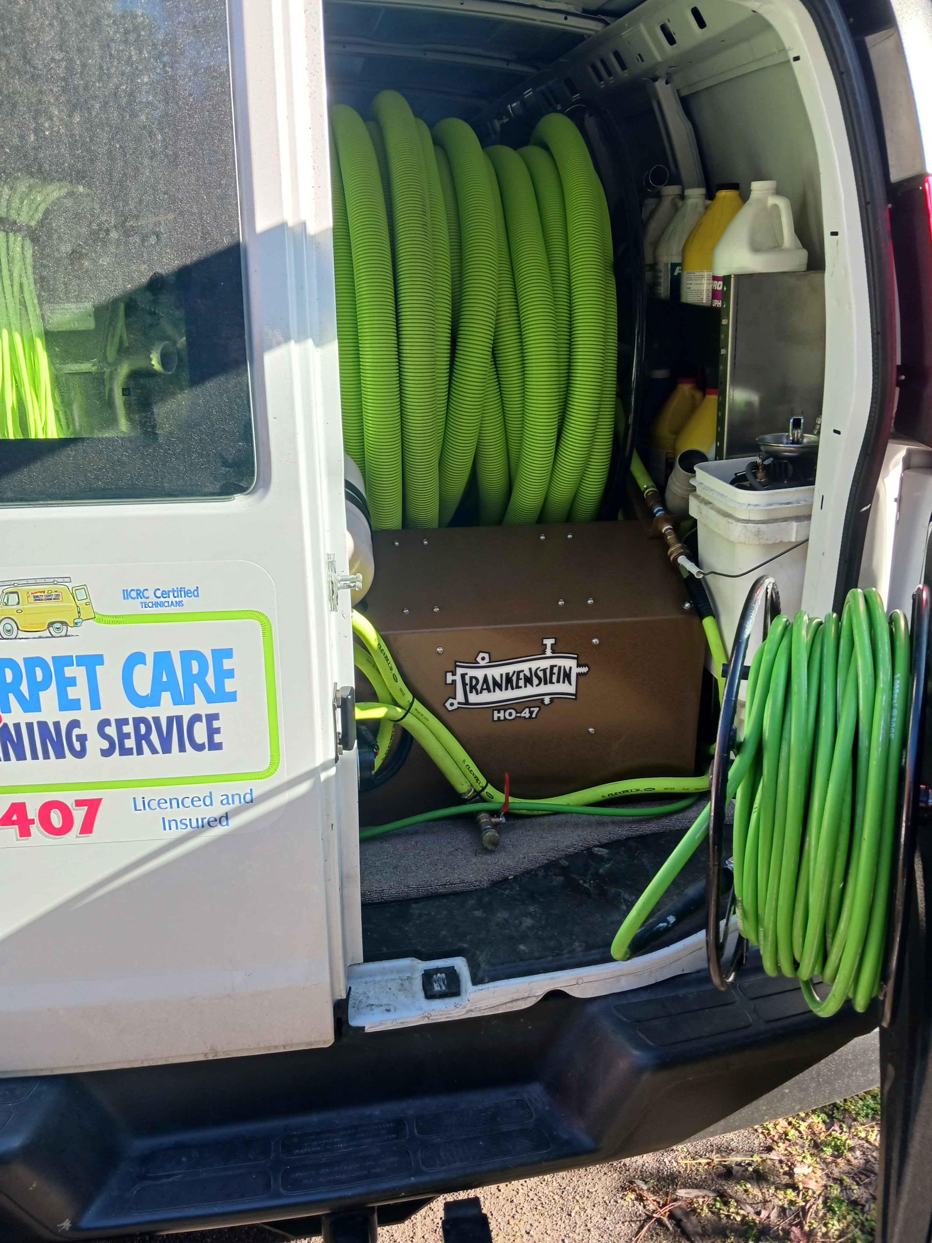

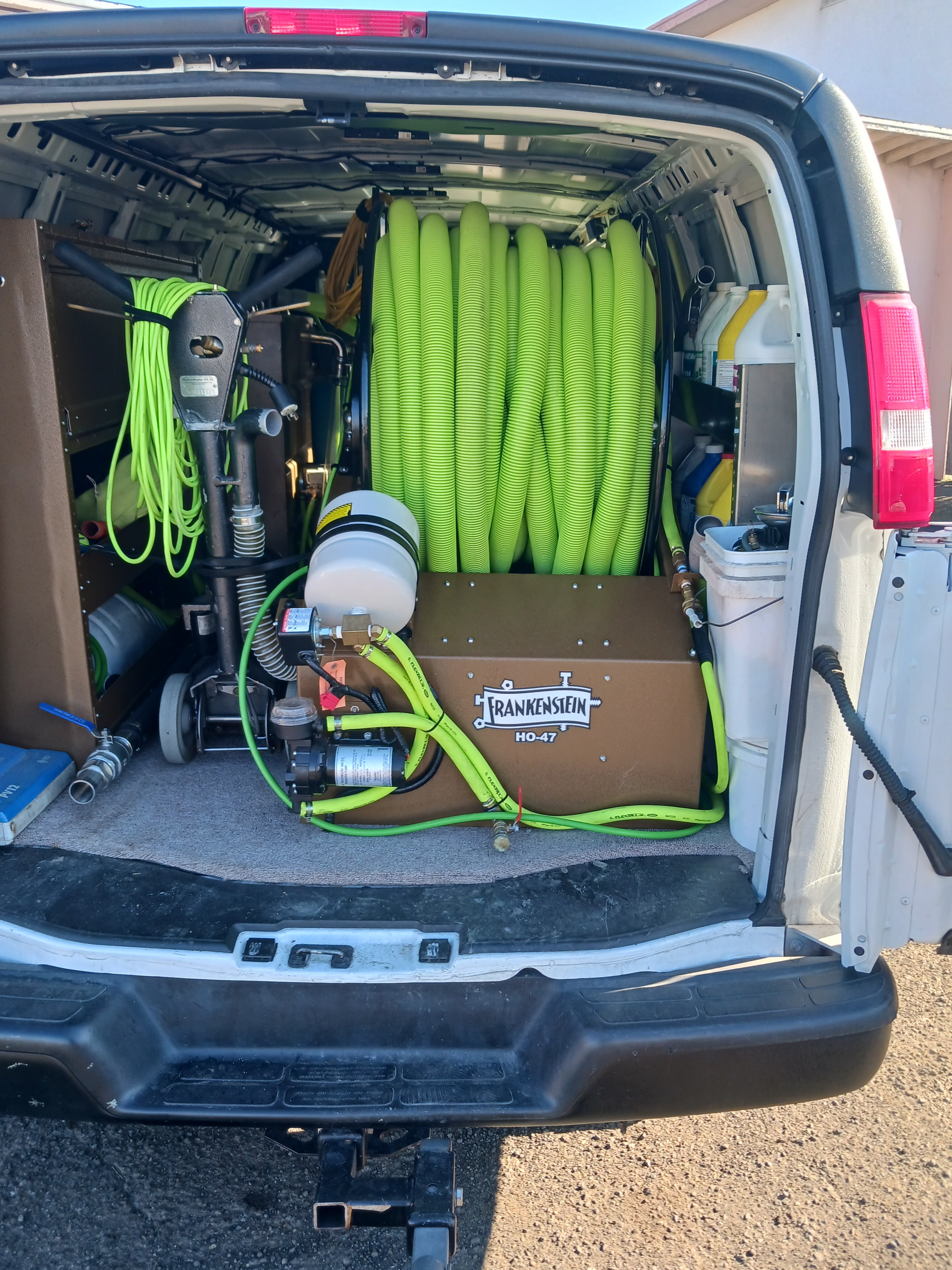

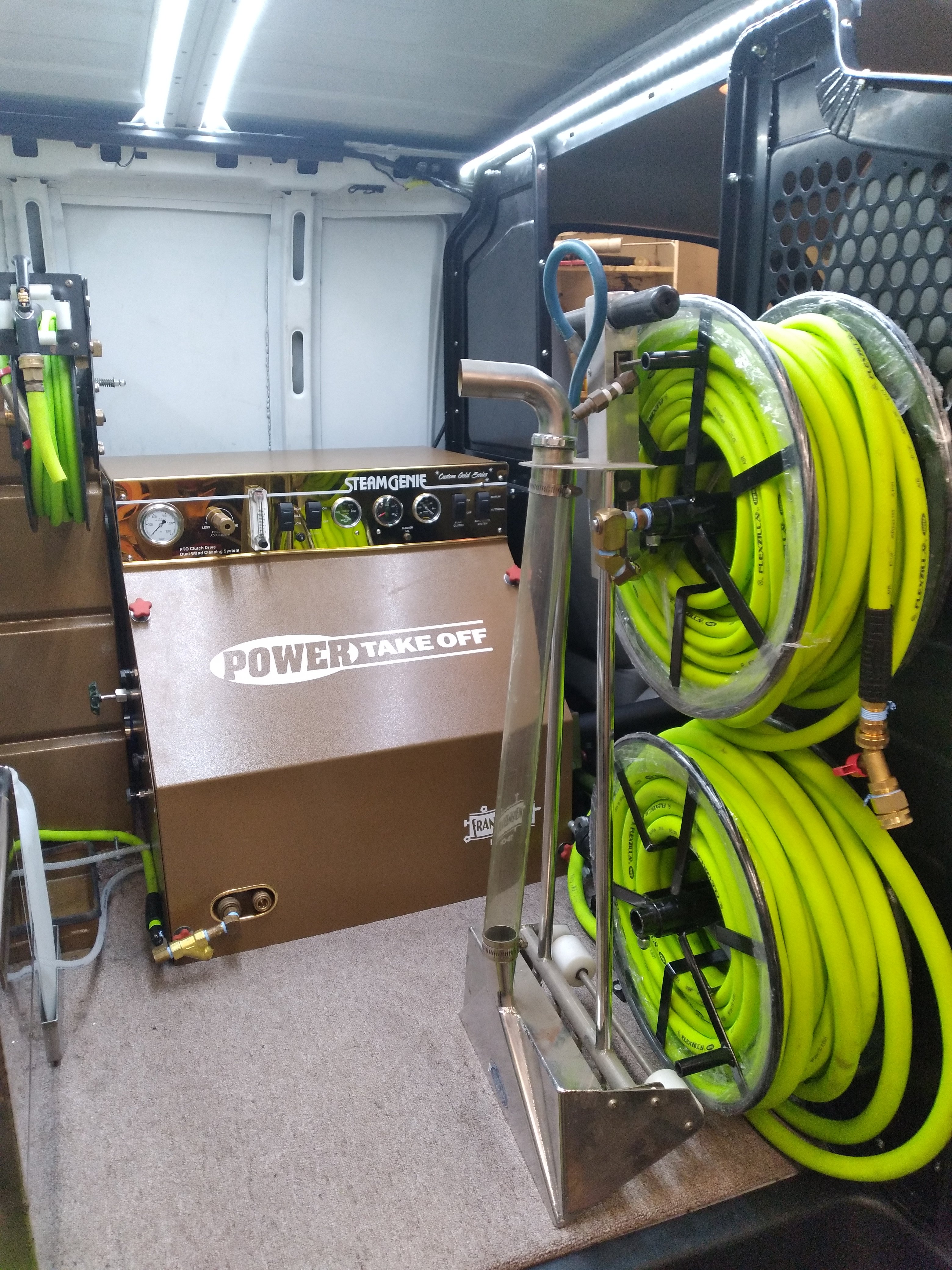

Looking for ideas of how to store wands and tile spinners rakes brushes etc on the roof of Frankenstein (my van) please share pictures if you're using the ceiling of your van for storage
14,079
I hope to replace my rear roll up door soon with barn style doors so I’ll have that advantage of using my ceiling.
you can see the metal clips that are just screwed in, they work good for rakes and pole handle brushes. The wood took a little while to get right.

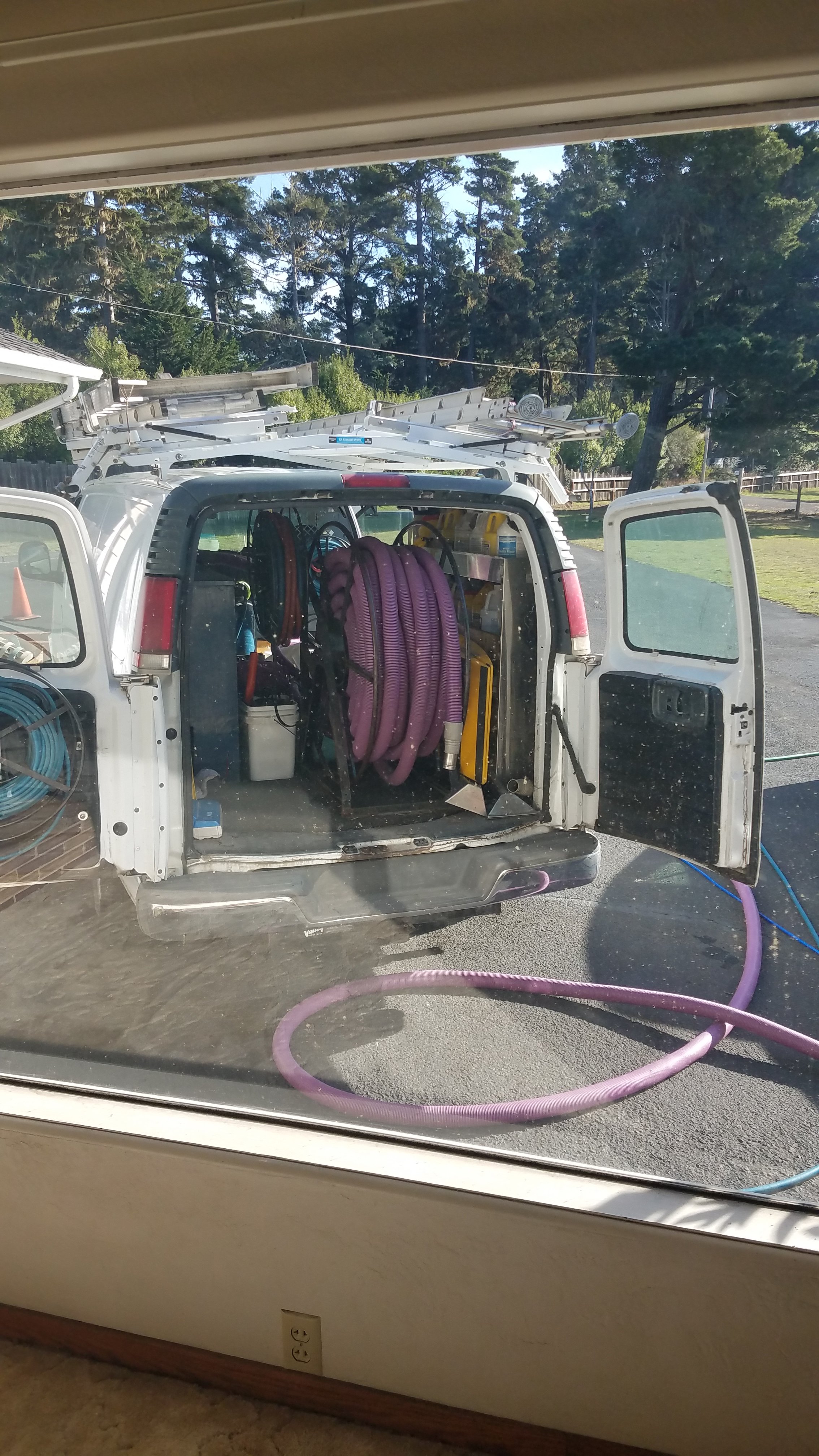

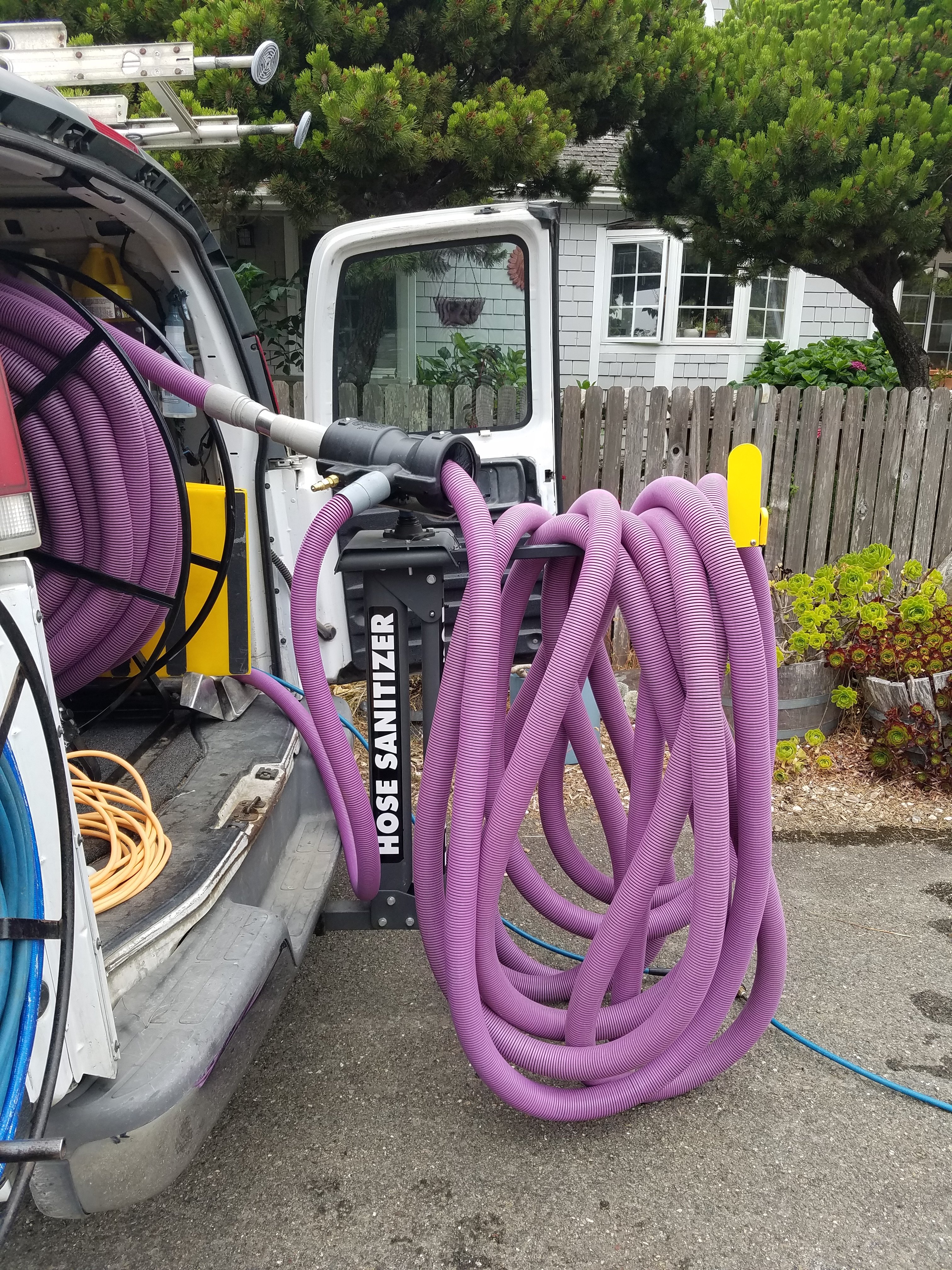

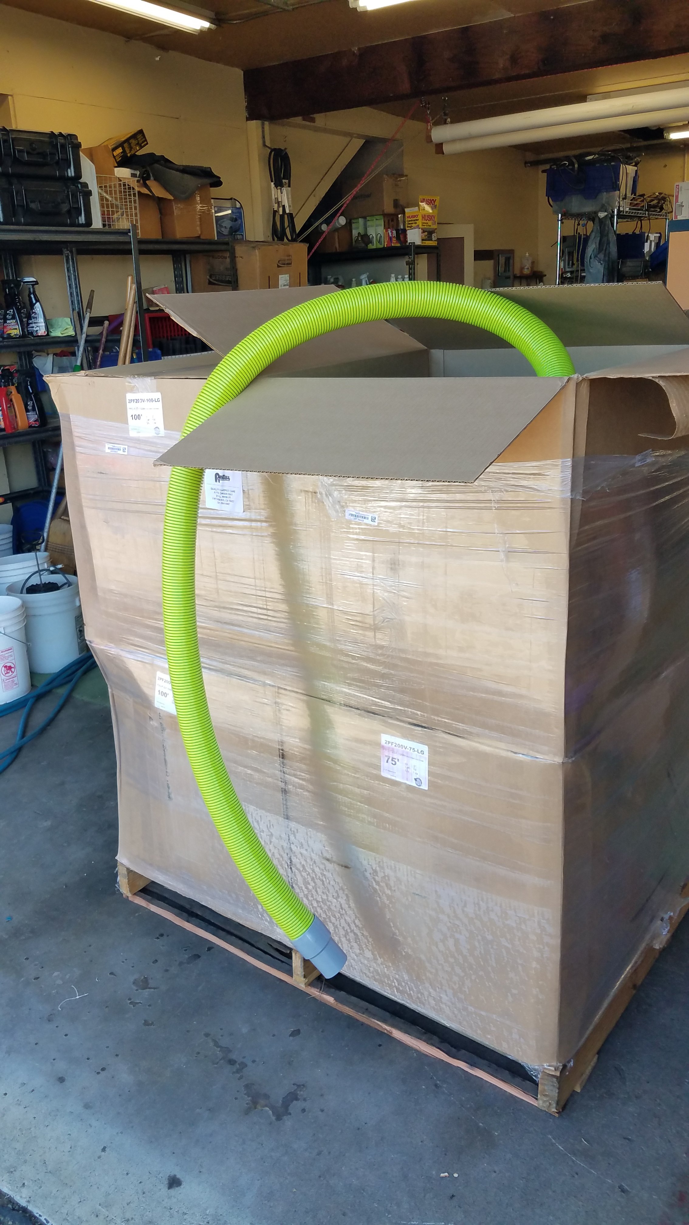

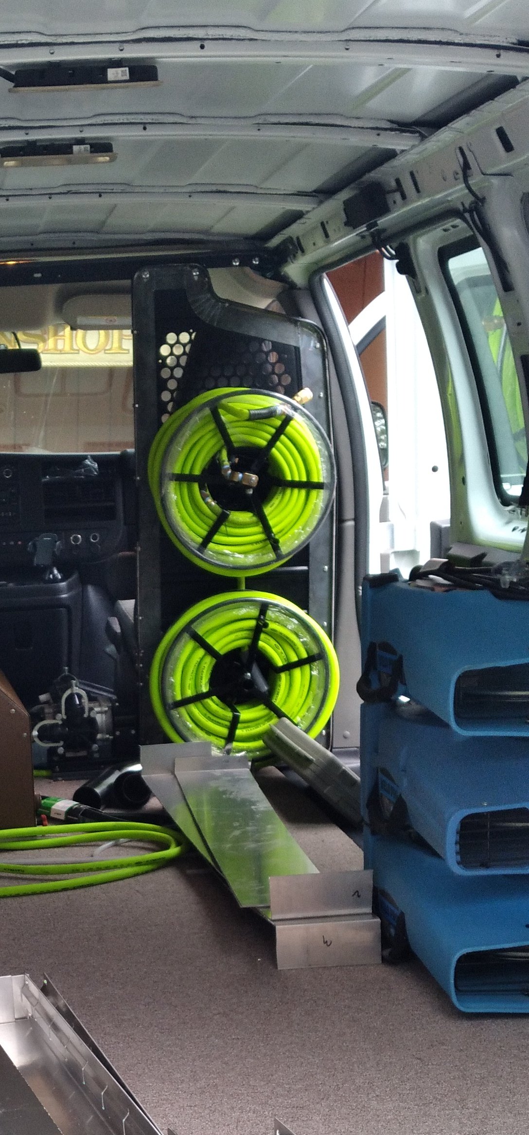

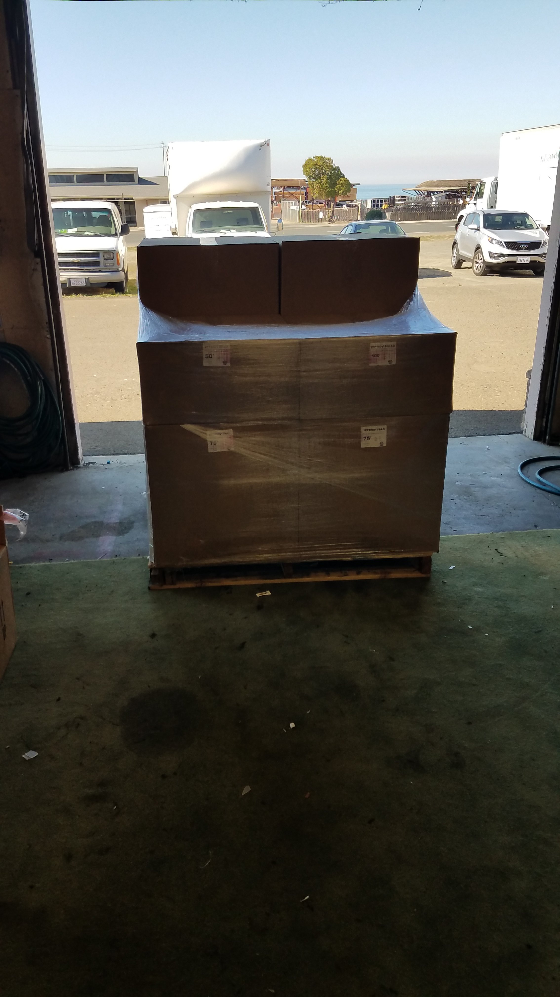

Where do you get the brights vacuum hose? How much does it cost
My hoses are custom made for me by Amflex Plastics in oceanside calif. When all said and done, they weren't very much more than blue hoses from my supplier. But i was able to get custom lengths my first and last hose on the reel are 75' and 2 middle are 50'. You can get the same green hose from Wanders in standard 50' lengths with 1 noteable difference i ordered my hoses with no black most all hoses including the neon or lime green sold by Wanders has black between the outer raised links (look at your hose and you'll see what im talking about) i specifically ordered these hoses all green NO BLACK. I had these made October 2019 i had (3) 2" 75' (3) 2" 100' (1) 1.5" 100' (1) 1.25" 100' if i remember right it was around 900.00 delivered don't quote me on that . Amflex makes the best , and longest lasting hoses, last batch i had made was in 1999 and are still in great shape on my spare truck, i have a bunch of it for sale off my 2 decommissioned vans @.75 perft but you'll have to pick it up the supply and waste hoses are standard flexzilla hoses 1/2" 5/8" & 3/4" my solution hoses are leaf or leafy green 1/4" from Wanders i bought in bulk for $1 perft and used wanders stainless steel gater ends to put um together with bend restrictors from my local supplier i do not recommend Wanders bend restrictors. Hope this is helpful. Dwaino

Beautiful thanks for the info
Vancouver
Nobody keeps their van that clean.
:eekk::eekk:. Is that a steam genie drag wand too? I have to go to the chiropractor after just looking at it. Nice set up.
