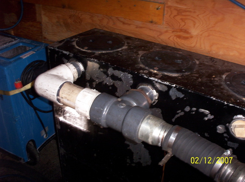

ok lemme see if i can do these small
old setup
new setup

yea eddie that thing has 5 ports...2 are used for the blower(that's why no just 1 4") 1 is for the relief and 2 are for the Y for the vac hose...
haven't noticed much machine noise difference though i need to fix the throttle control it keeps sliding back in...grah pisses me off
no streaking noticed yet..but i have only done commercial jobs since the addition...and that is firing with in 1/4-1/2" away from the glide..
we boobooed a little and made it to low for the spacer/check valves...that's why they aren't there.
when i throw the dual stage on it gets damn hot right quick...in fact it will vapor easily...and makes all kinds of volcanic eruption nosies...hahaha
and the vac has increased quiet a bit...i need another house to test it on...and after this week i will be pushing a little more, have had other things that have taken up the weeks time...
