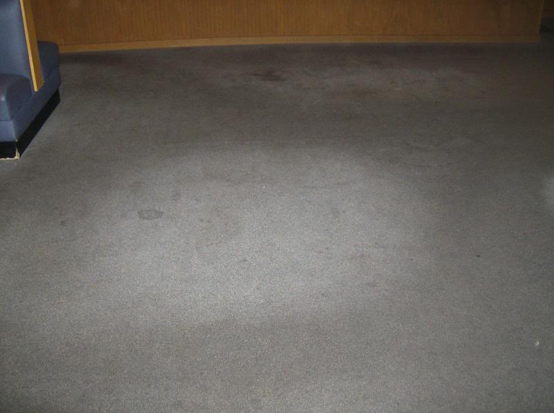

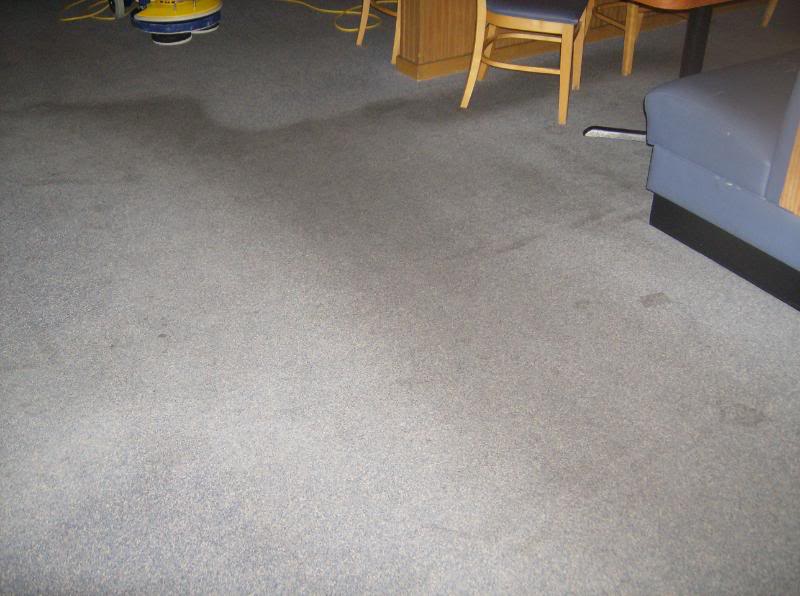

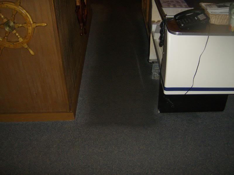

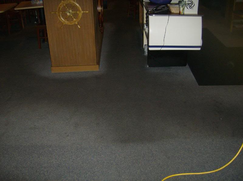

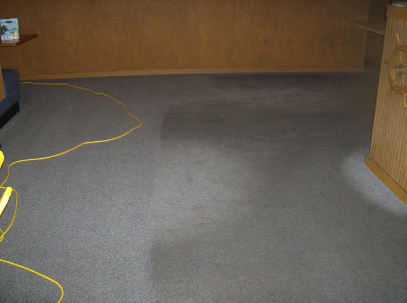

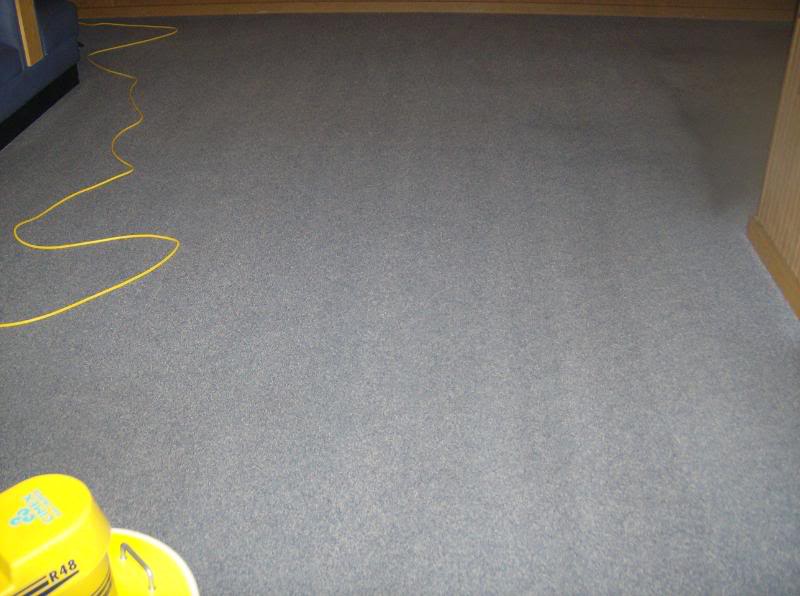

if that was a option for him financially i would have wanded it. you have to remember that i had a in depth talk with him about his expectations and to make sure they were realistic. he is/was very price driven and protector was not a option financially for him. he had tried to bargain me down on my price then walked away from me for about 6 months. I was not really worried about not getting it eventually because i knew what he wanted and no one else was even asking him...he commented that i was the first person that had ever specifically asked him what he was expecting to be done.
I wanted to make sure he was not looking for new carpet when something has been abused and mis cleaned for so long...
