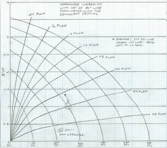

You say same PSI/ flow
and I assume you mean the overall flow of the wand. A 6 flow six jet wand vs a 6 flow four jet wand in which case the force/velocity/impact of the four jet would be greater overall (maybe) but ignores the fact that jets can be changed. The same "impact" (and water consumption) can be achieved with the wand with more jets by lowering the flow and increasing PSI (same water flow overall). That "impact" is arguably more effective and consistent because there is less loss because the pattern width is narrower and thereby more consistent (force). You ever pressure wash your driveway? What tip did you choose (or not) and why?
See the above chart even though it doesn't factor velocity or pattern width....it does however demonstrate the changes in flow/psi and of course, if you move more water through a smaller orifice at "x" psi the "impact" will be greater
*and then there is droplet size
