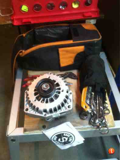

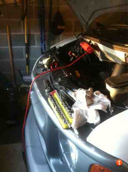

Squeaky Alternator Bearings and a pain in the azz grease gun got fixered today.
Birds chirpin under the hood kill my nerves : )
The Victim!
My lil go bag that has everything to fix anything truck or mount related!

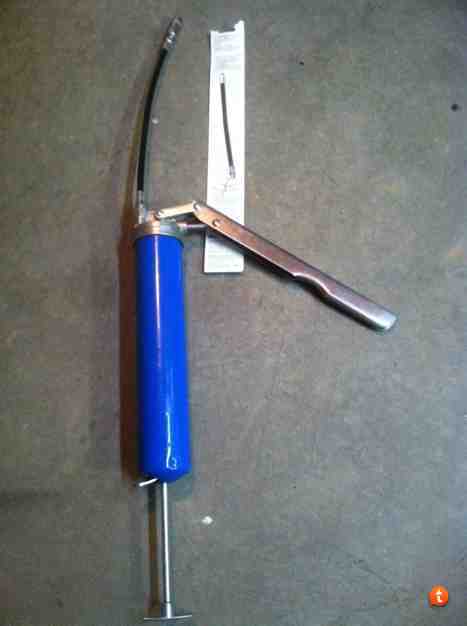

A flexible grease gun hose is a must for any serious blower owner!
Don't be that Guy!

Chris...put a straight edge across yor pulleys.....
over time i've seen the driveshaft work it's way BACK.......
a mis-alignment of a 1/16" will sometimes cuz a
"chirp"...a worn belt will as well!
and yes.....Harbor Fright will have a suitable straight edge
jus go get one!!!
