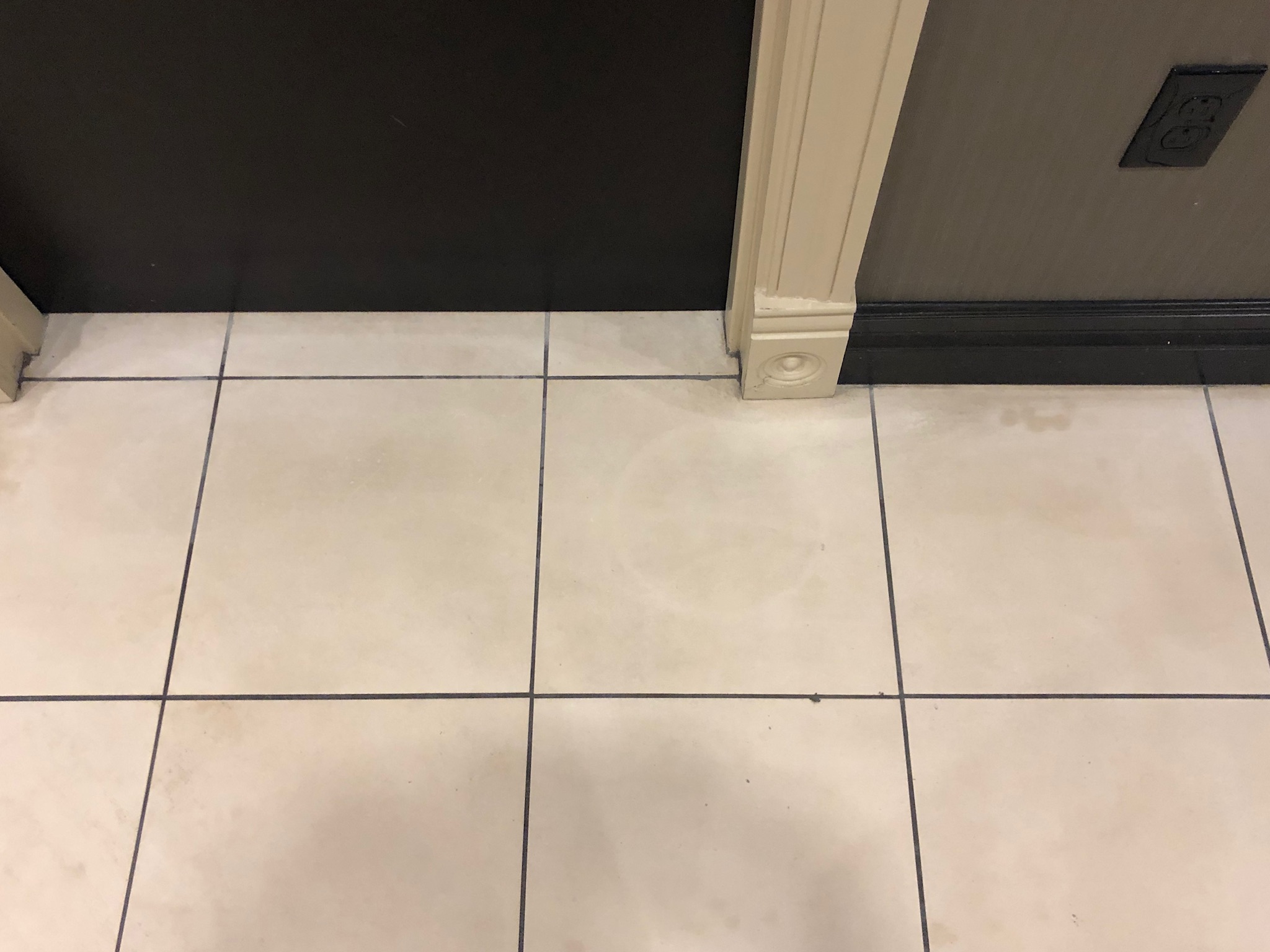

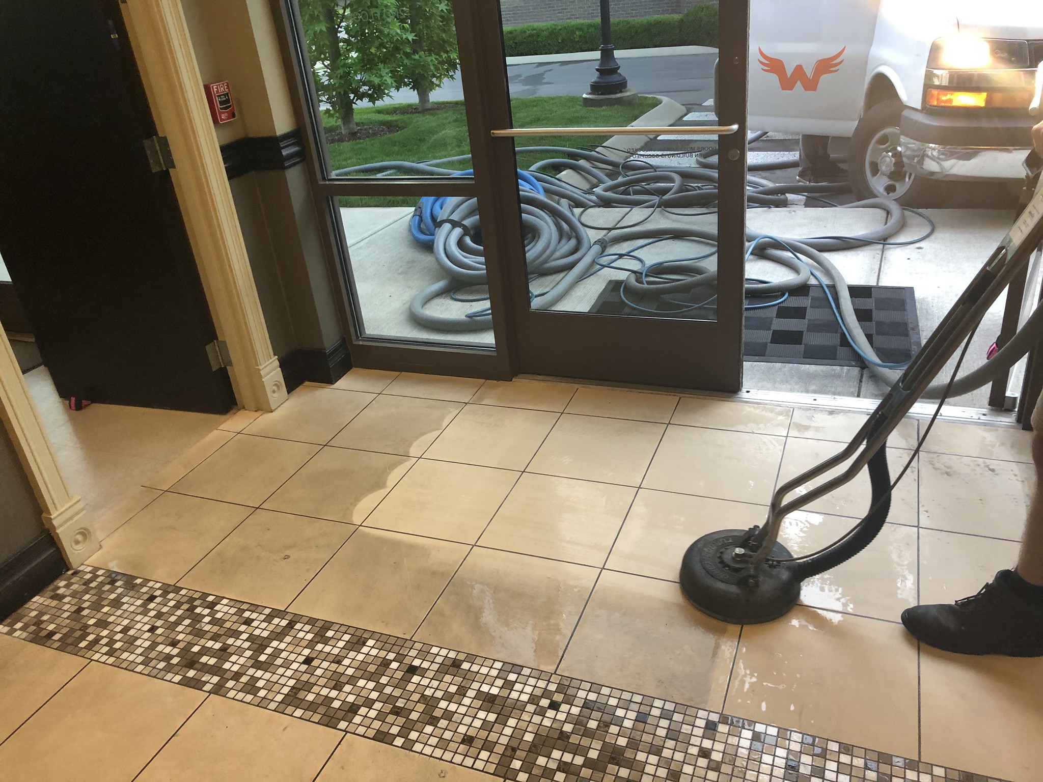

We cleaned a travertine/limestone floor and left turbo hybrid rings in some areas like corners. I went back over with tile brushes on a crb to no avail. I have a cimex and both beige and gray pads. Is that too aggressive for travertine/limestone tile?

It's certainly not Travertine..
And unfortunately I cant see through the blur if it's actually limestone.
If it is and you cleaned at very high psi, I suppose you could have pressure at stitt that my female intuition is telling me you just blast it awesome topical off of a porcelain...
More pics please

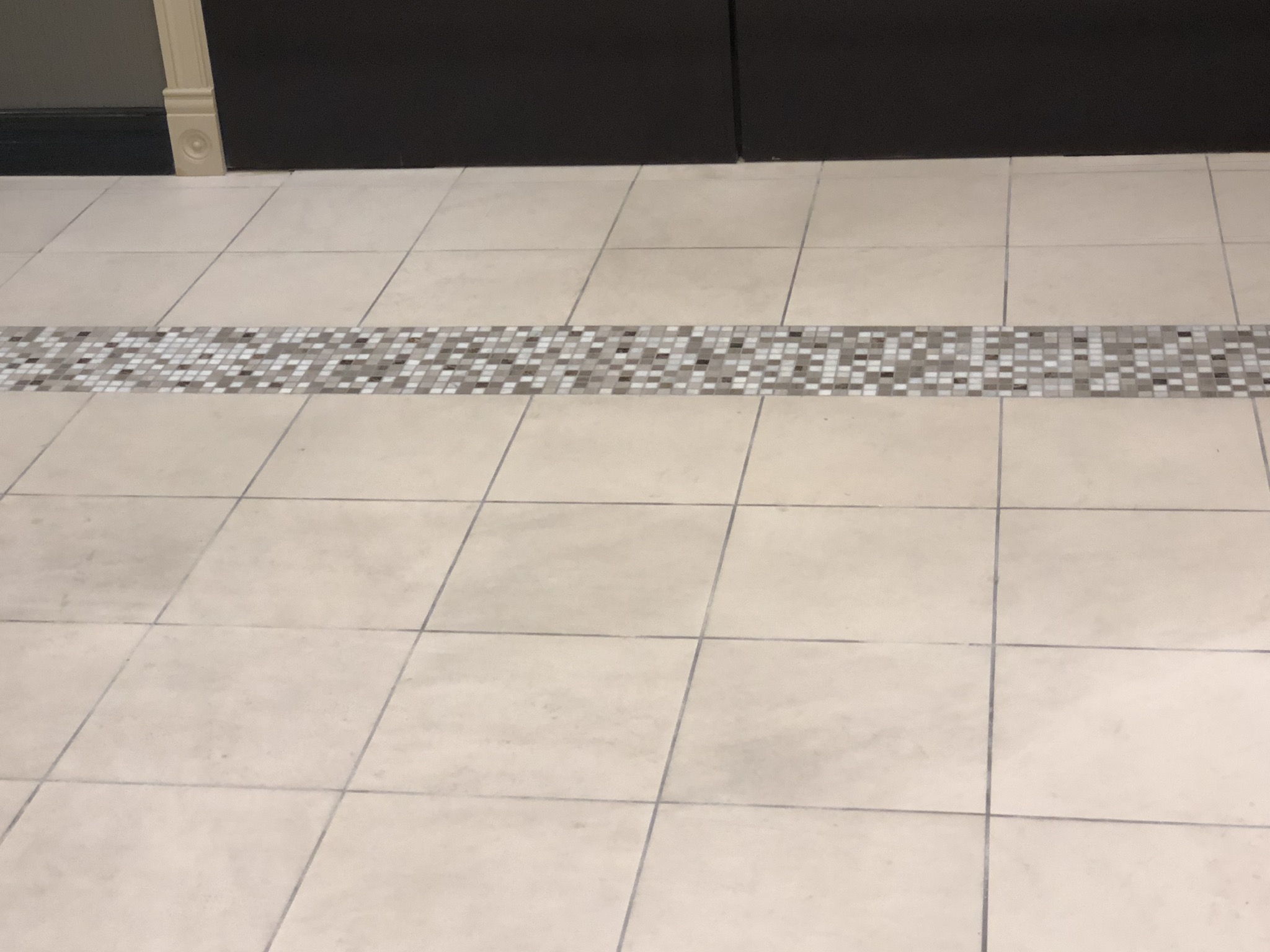

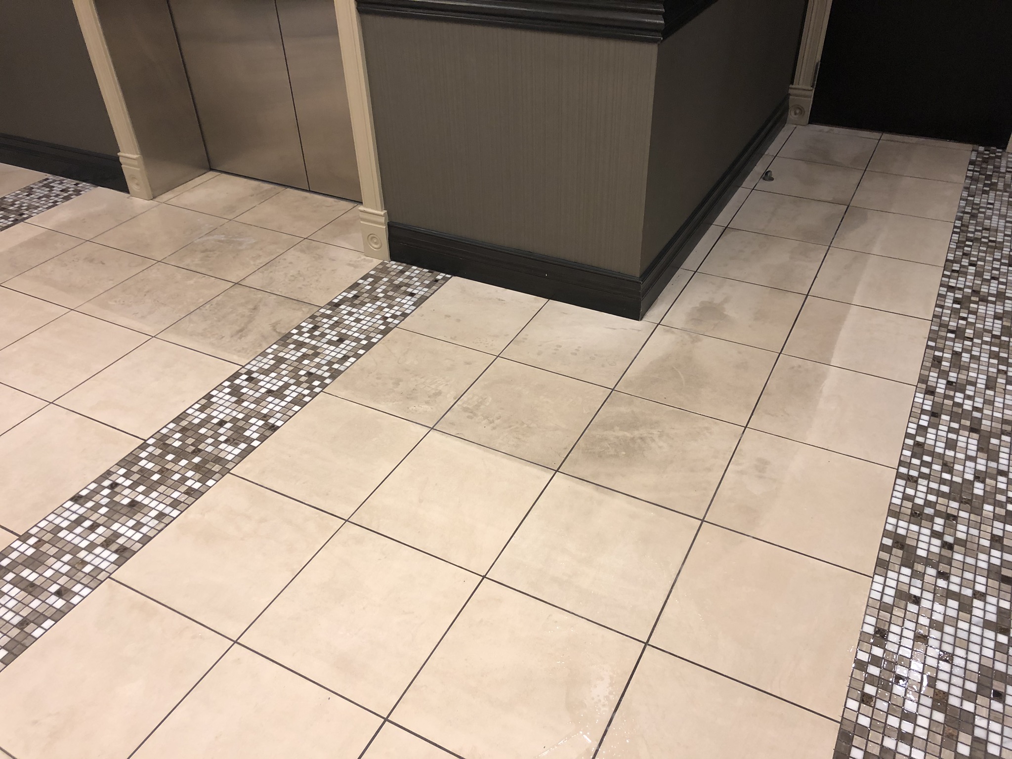

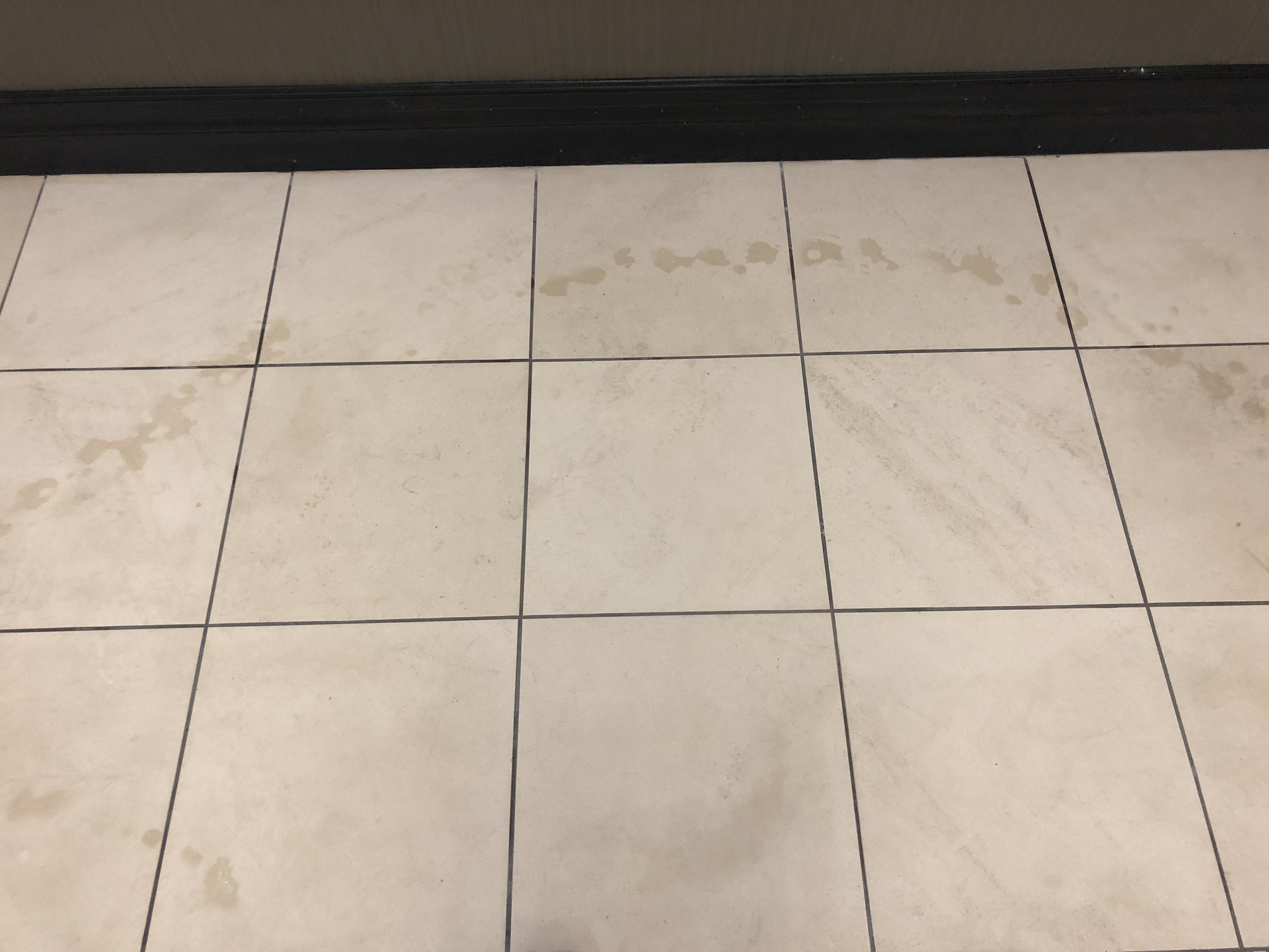

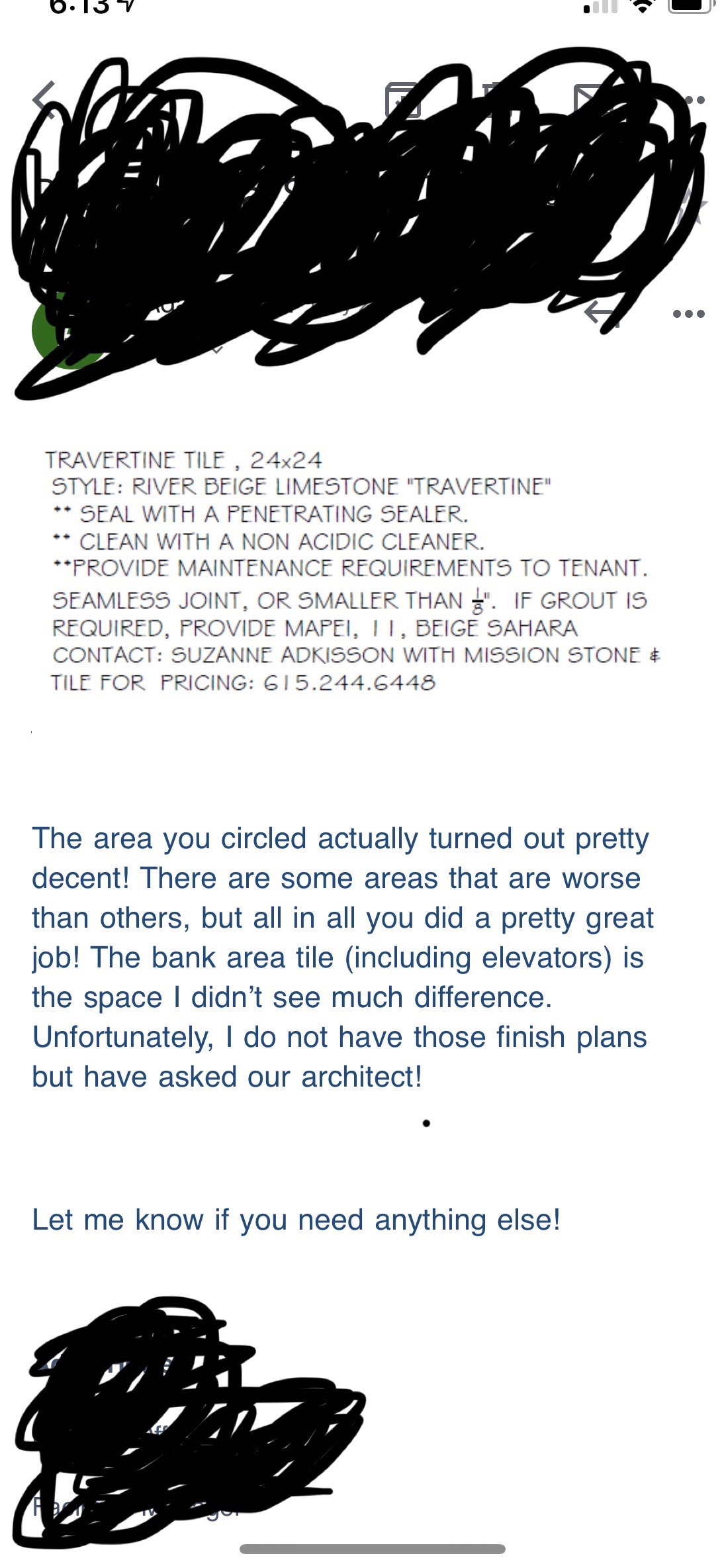

The tile looks ceramic, but it fizzed with the acid test. The architect said it was limestone travertine. I've never seen travertine without the tiny holes. My guess is that it is limestone that they call travertine to help sell. If it is a natural stone, will scrubbing it with a cimex and gray pads harm it? You can see how neglected it was. I am sure any sealer had warn off and it had not been cleaned in years if ever with anything other than a mop.

Not knowing anything but could it be some sort of black shoe sole rub off in the pivit points? Kind of like tire marks on a highway.
Being porous the black went deep into the pores
I do see the parking lot is blacktop
