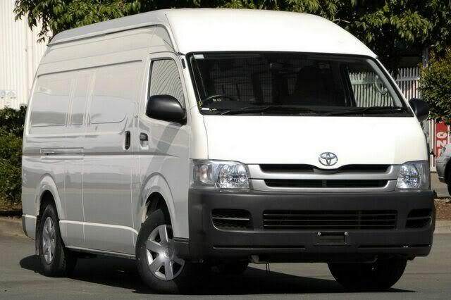

I know you guys over there don't have this van, but this is a Toyota van. This is a larger version of our standard smaller sized Toyota vans over here. This rig is owned by one of our Aussie Cleaning forum member. He purchased a second hand, low km, super long wheel base Toyota Hiace.

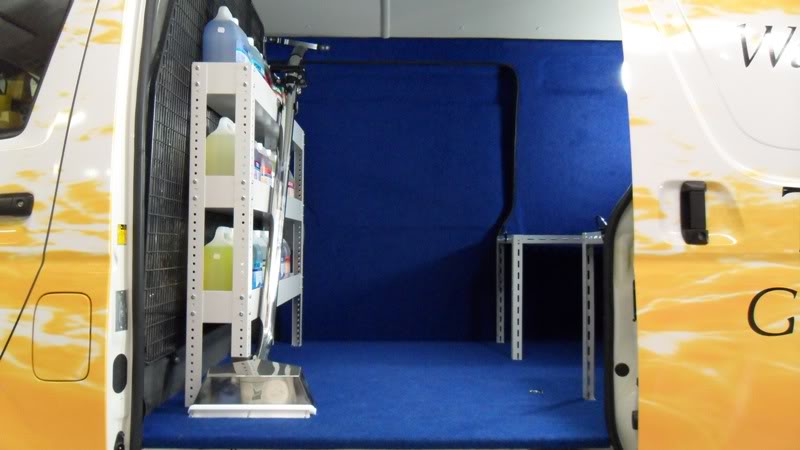

Side view showing chemical shelf and how much spare floor room there is available.

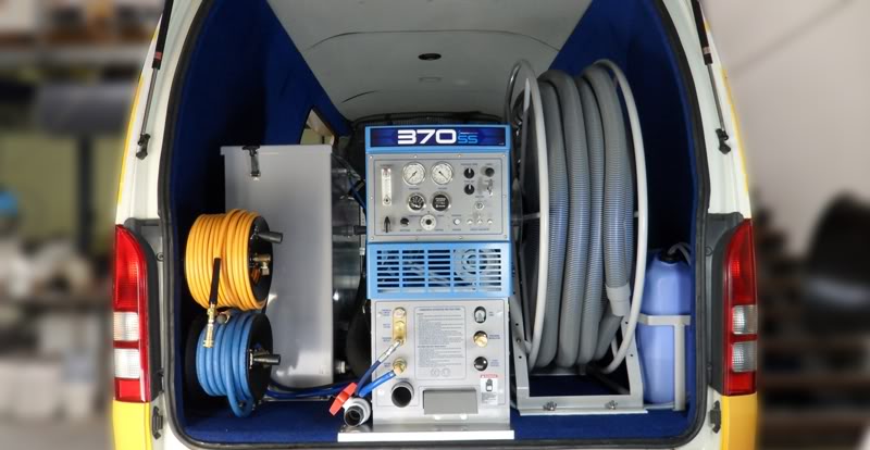

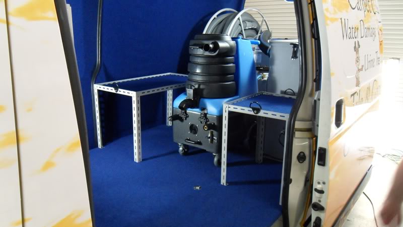

Looking toward the back of the van, the racks can accomdate 6 airmovers (above and below) and still room for a portable, scrubber, dehum or 2 between the two racks.

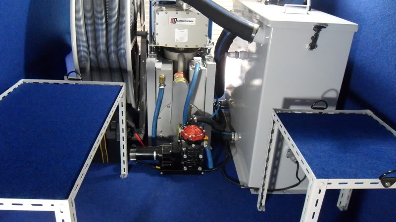

Upon removing cargo that would normally sit between the two racks, it allows very easy access to the APO and the rear of the machine for maintenance.

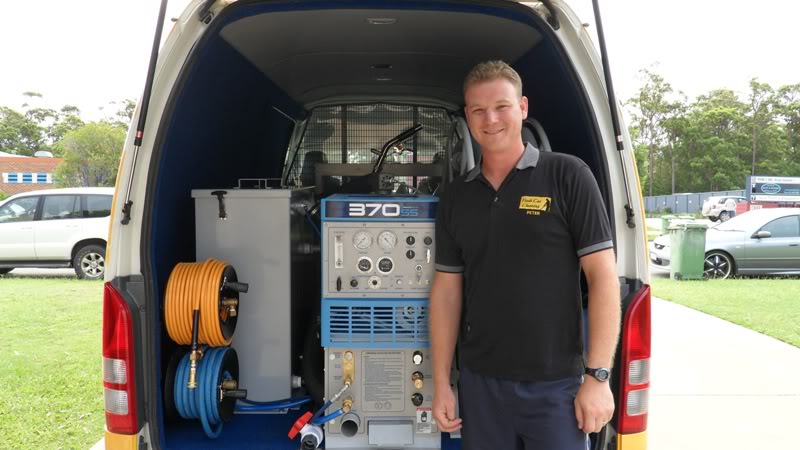

The Sapphire 370 SS. The vacuum hose reel can be removed in under a minute therefore allowing complete access to the side of the machine if it is ever required.
