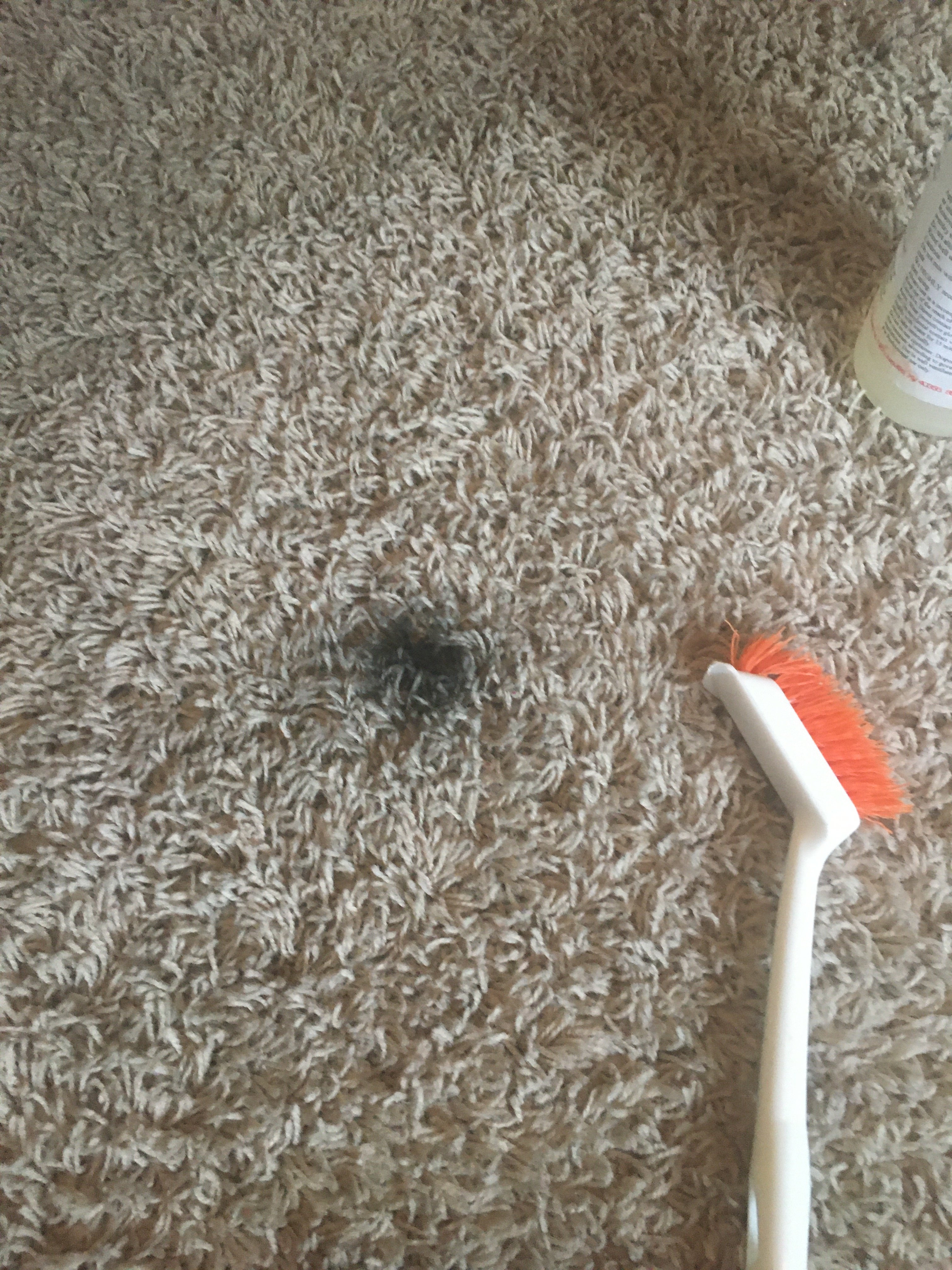

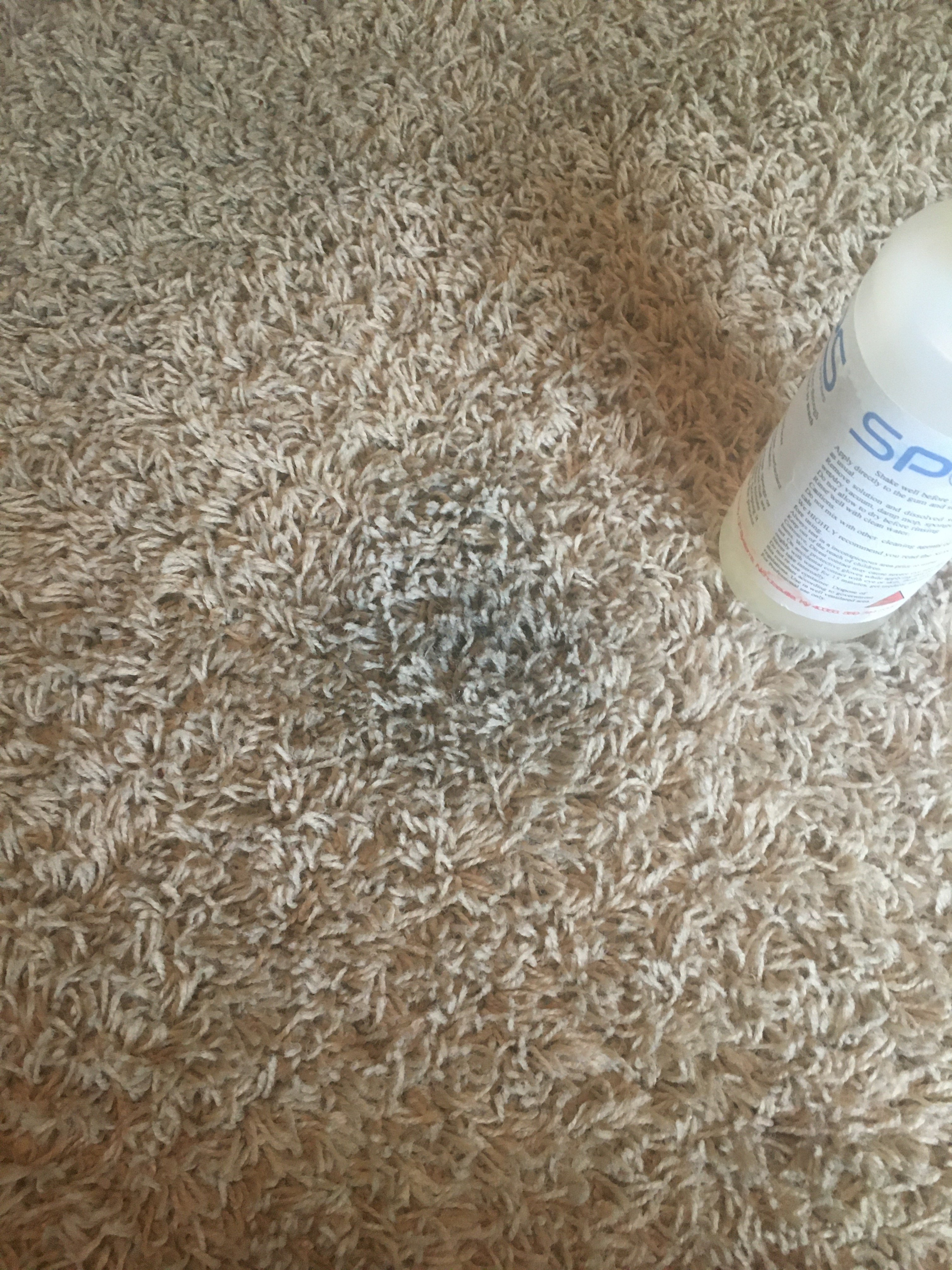

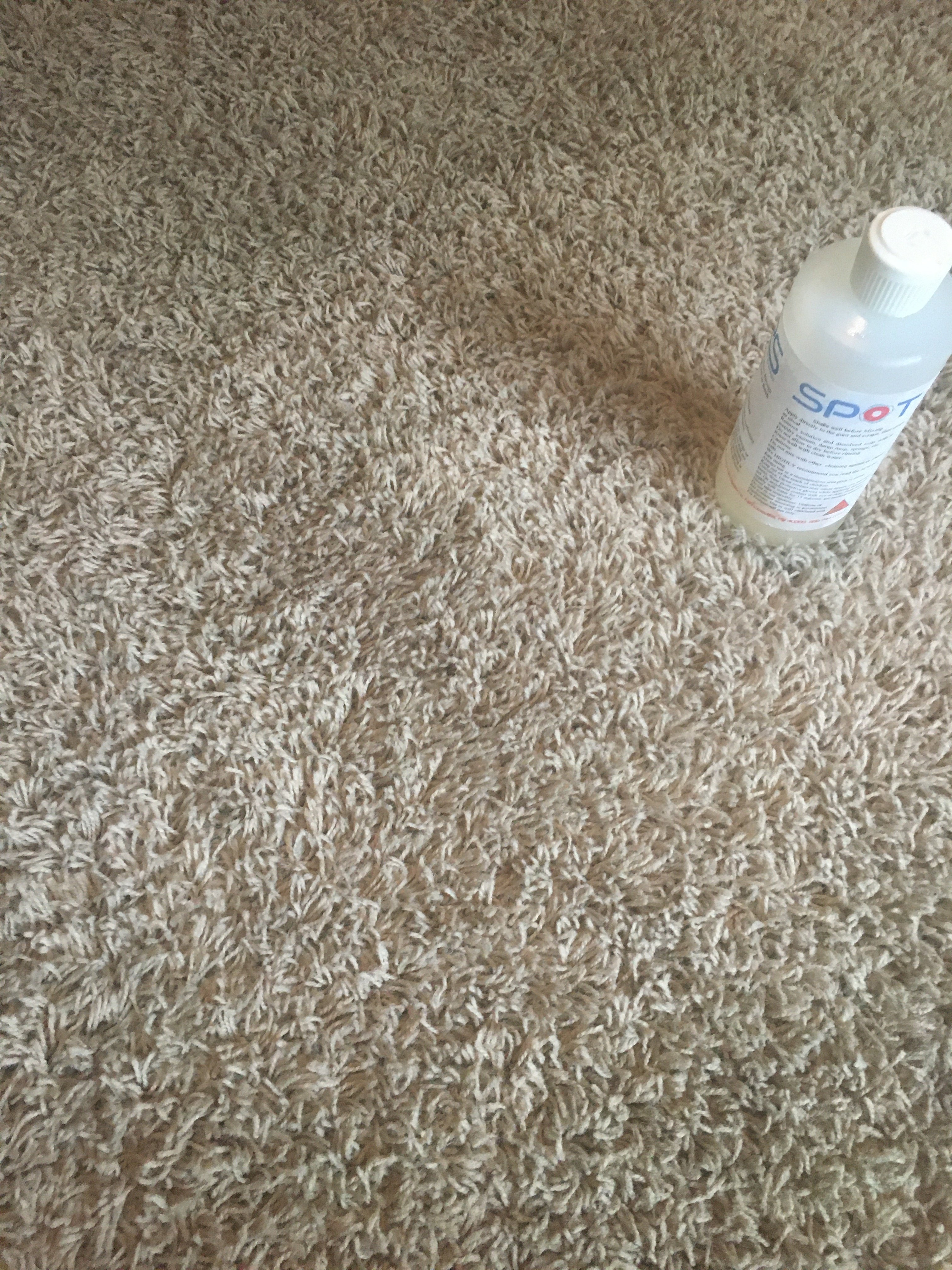

Stephen
Don’t you love cleaning and uncovering carpet leprosy? Even dilemonine didn’t take these black-as-Mikey’s-soul (henceforth BAMS) spots out. This one was big-as-Marty’s-ass (henceforth BAMA) and BAMS all at the same time.
Truly amazing stuff.
27855856-7730-42E1-9C82-7BAABA35B84E.jpeg 1CAAF96C-98BE-496E-A194-ACB7F147B128.jpeg 72BA627A-1AEC-4859-AA96-D5B7FC042041.jpeg
