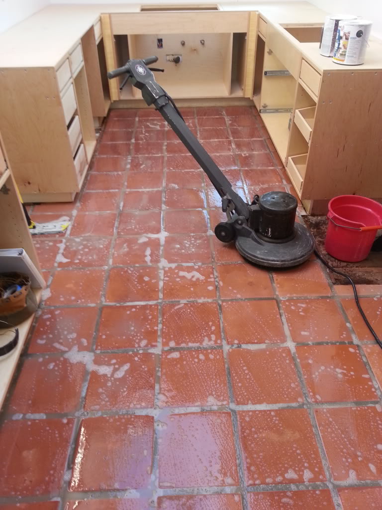

today's Saltillo Job
117,254

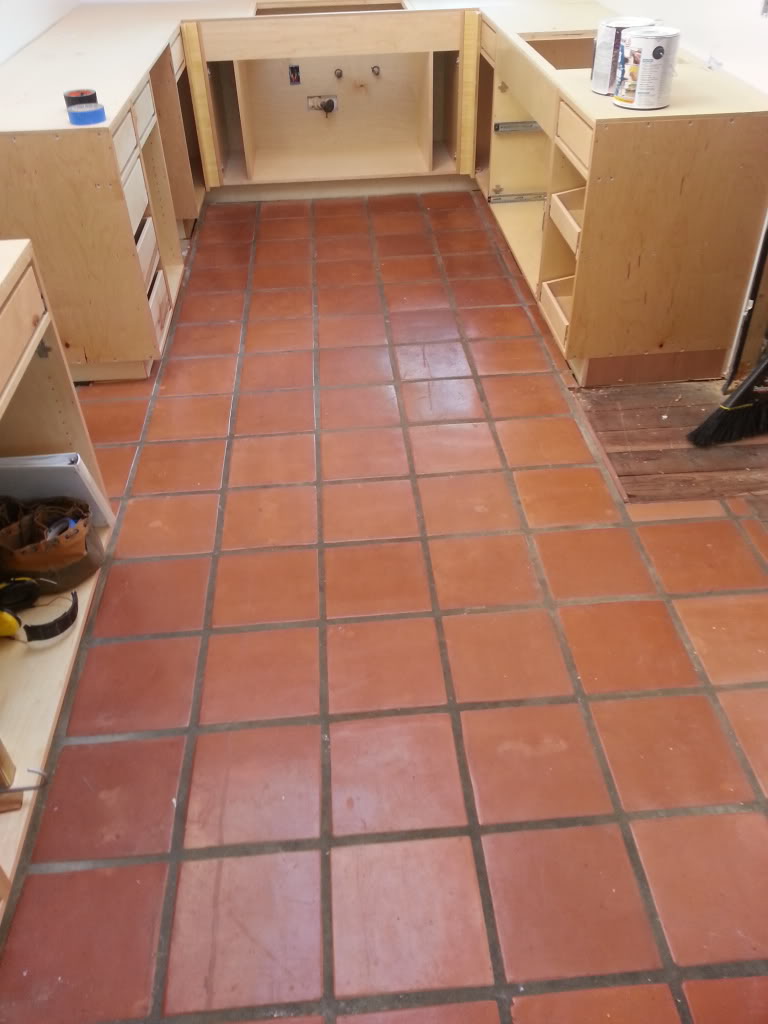

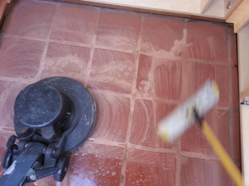

just these 70 or so feet took 2 hours to strip.

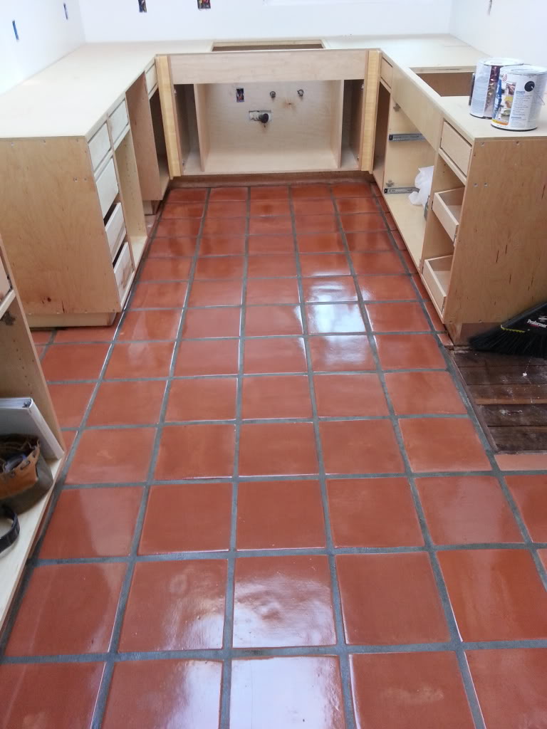

I'll go back tomorrow to apply 4 coats of wax/ finish
pretty much have to charge $10 a foot to make carpet money stripping Saltillo tiles.
20 plus year old floor, never dealt with..

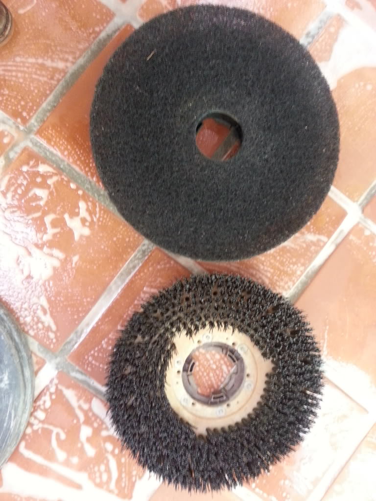

soaking in Zep stripper
Went over and over and over with a Malgrit brush and a black pad..

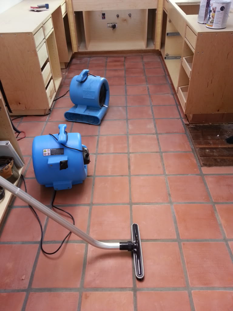

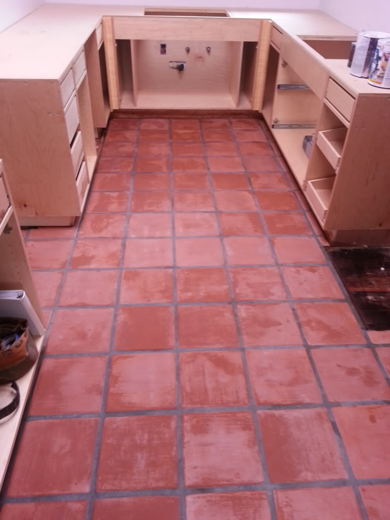

fully naked and drying..
more pics tomorrow..

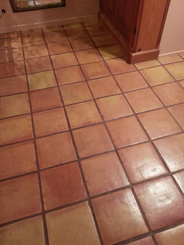

Nice job mike, those are good tiles. The floor should look bitching when done.

I wish I had fred in my back pocket. Mike I'm not knocking the floor, but with a better finish it would have looked better.
117,254
Fred has nothing to do with MY ability to post a word press blog.
and seven coats of a concrete sealer would have been ridiculous consider the same worn out floor continues seamlessly on to the left of the kitchen.
117,254
let me get this straight, polished marble looks "better" than honed or tumbled?
I guess that explains the bald head look...lol
I personally don't like an ultra glossy floor, and neither does this homeowner..

how do you apply the sealer?
how long will it last? i know a near impossible question but a few years or what time frame?
i just walked from one of these because of lack of experience in them..only see them in fla every 6 months or so.
117,254
flat mop it on Dave.
good finishes self level and dry in 10 to 15 minutes.
thats the easy part.
getting the old stuff off can be a nightmare, especially if different products were used over time. If some idiot put an epoxy or lacquer finish on it, run like hell.
strong stripper, scrub scrub scrub rinse repeat...

I like the flat look also. Too shiny and you are blinded at certain times of the day.
117,254
Its a house brand product called Brilliant Shine. Its the janitorial shops highest solids product

Saltillo tile is often coated with a solvent-based acrylic sealer . . .
which can make removal requiring a solvent stripper.
For a water-based sealer we would use Diversey Plaza sealer ($15/gal.),
since it is designed for stone floors.
We like the satin look also, for better durability and uniformity.
