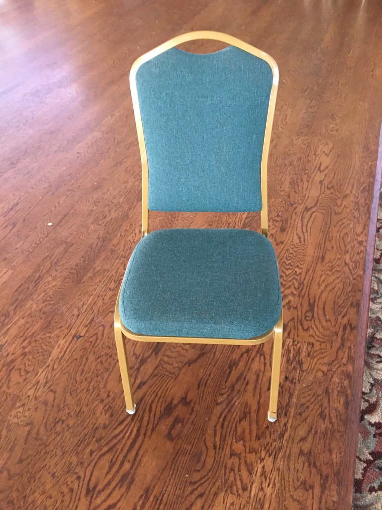

Hey Guys,
I'm sure this has been asked a million times, but I'll ask again anyway.
280 chairs like picture, with upholstered backs.
I'm thinking $3.35 per chair? Doable in one day with helper?
Thanks.

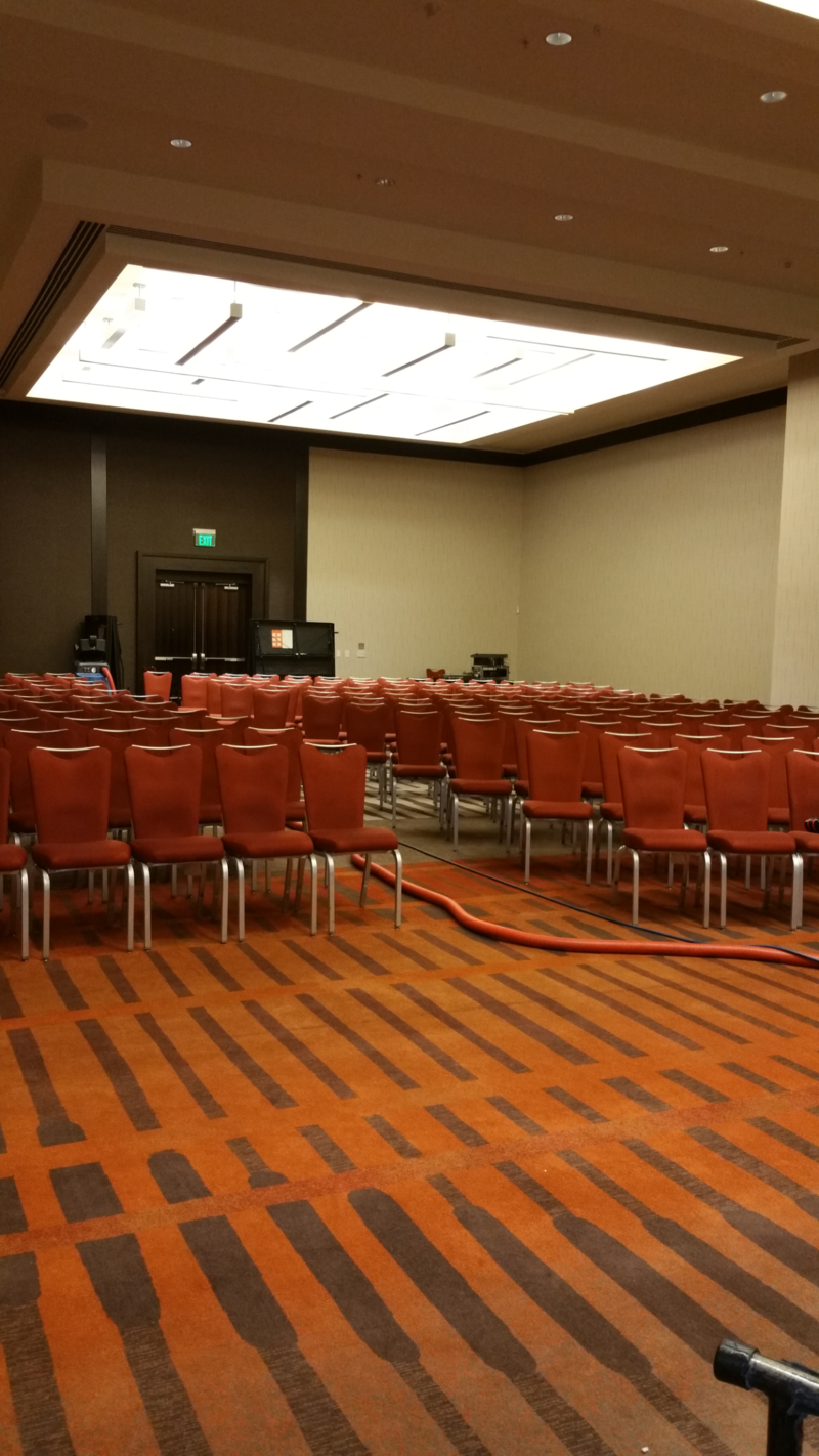

Just did 100 of these plus carpets and tile and grout on Monday.
We are around $10 per chair in our area typically for these but discounted down to $7.
But each area is different and also we know what we want or need for a price point. So if you are able to be profitable and hit your profit making price point, your price will be good
3 minutes a chair would be 20 in an hour
$3.25 x 20=$65.00
So that means clean faster or charge more.
2 minutes a chair
$3.25 ×30 =$97.50
1 minute a chair
$3.25 × 60 =$195.00

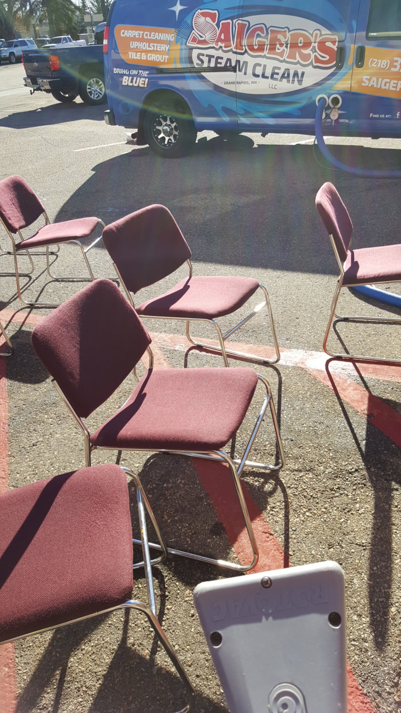

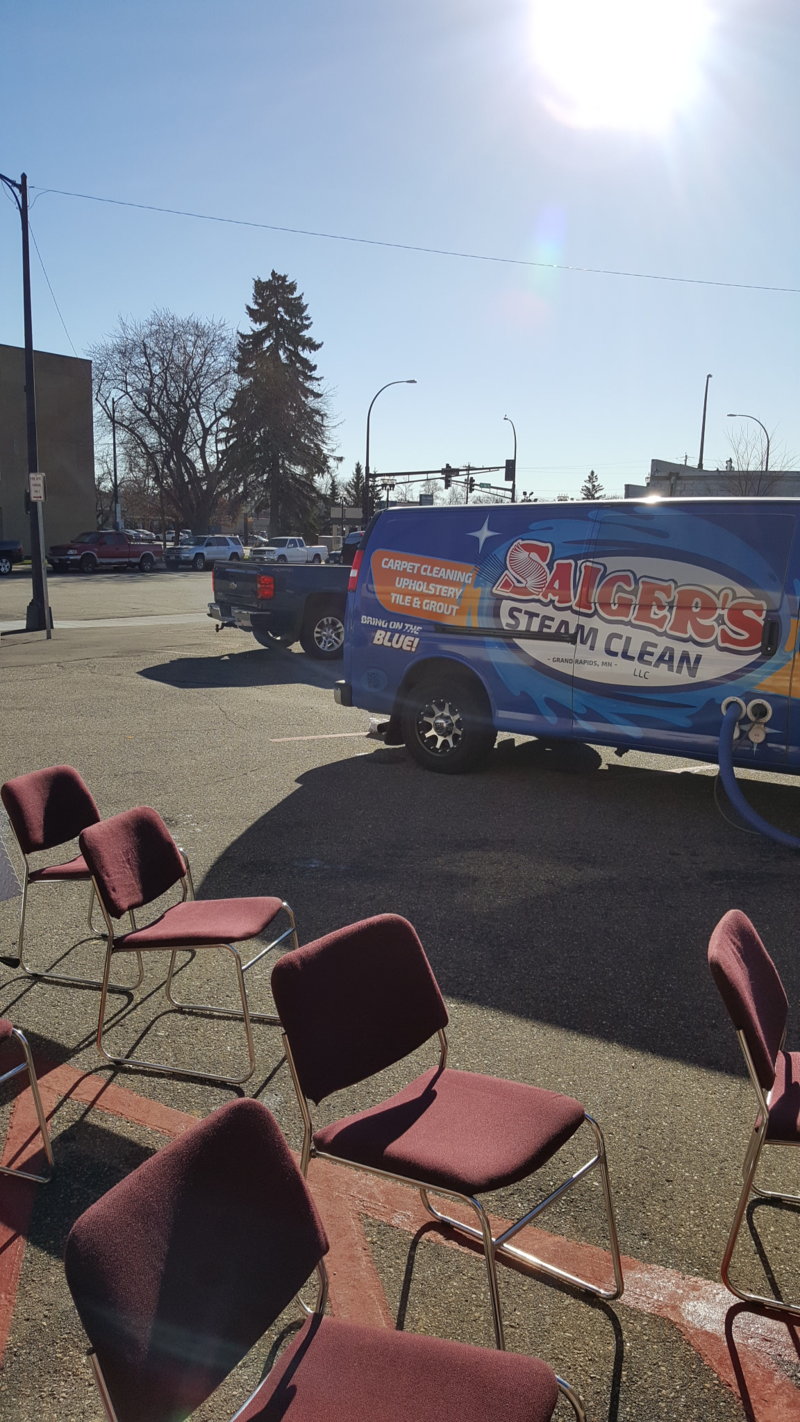

Last year we cleaned over 1600 chairs but only charged for 1400-- we negotiated that 200 were redo chairs and that we wouldn't charge the customer.
The fabric on the chairs in the photo you posted should be easier then the chairs we cleaned last year. About 25 years ago I cleaned same type chairs and fabric in your photo. I used a truck mount, while cleaning them in open garage and I used a swivel stair tool. I cut a lot of corners as didn't do most backs-- but at 50 cents a chair they didn't care. I could do Max 80 chairs an hour by myself..
We cleaned the chairs last year for $5 each and lost money. It took a combined 4 people to clean 80 chairs an hour max. We were using two portables and cleaned them inside.
When we were done, both portables, and 2 staff members needed repairs. We didn't get paid for about 4 months because the manager who hired us had been transferred... but the check arrived during a very slow time and was welcomed.
