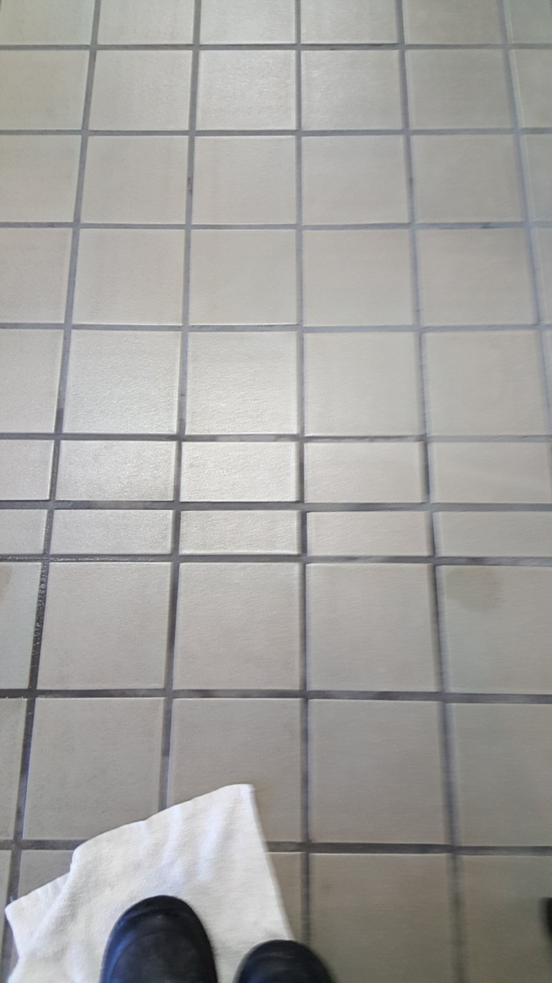

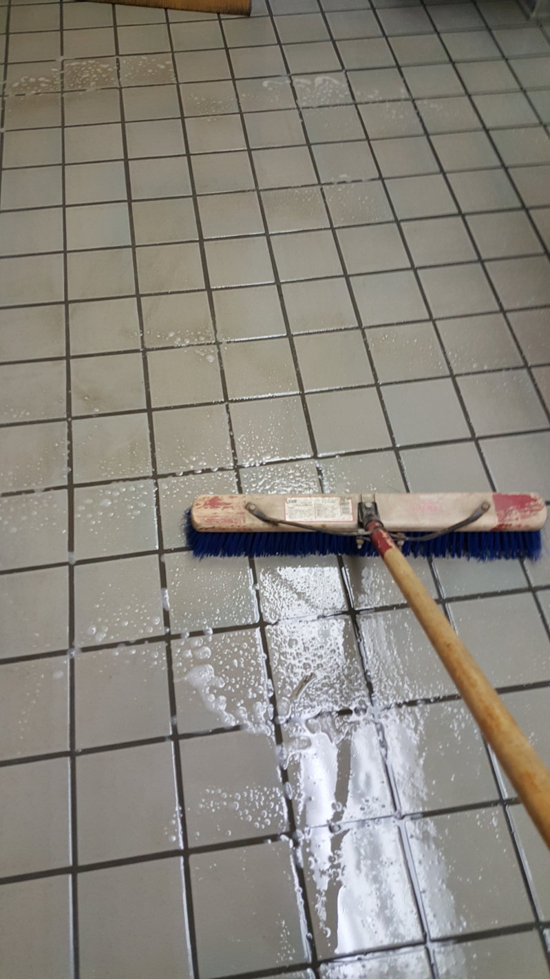

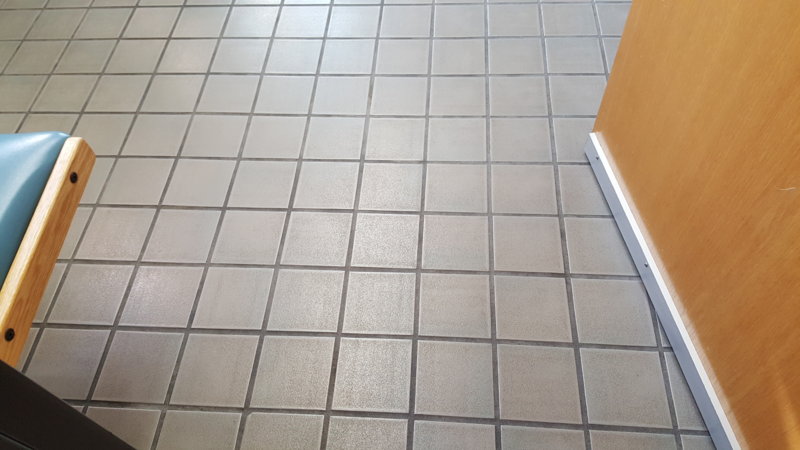

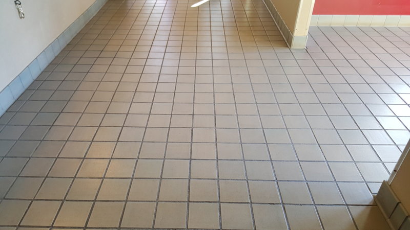

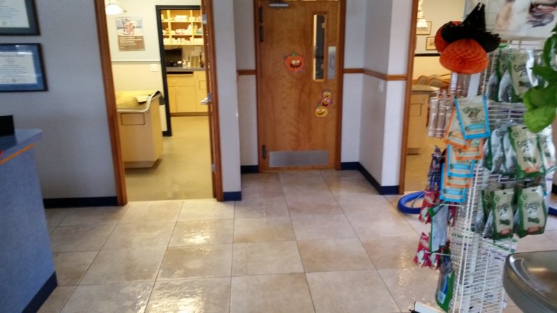

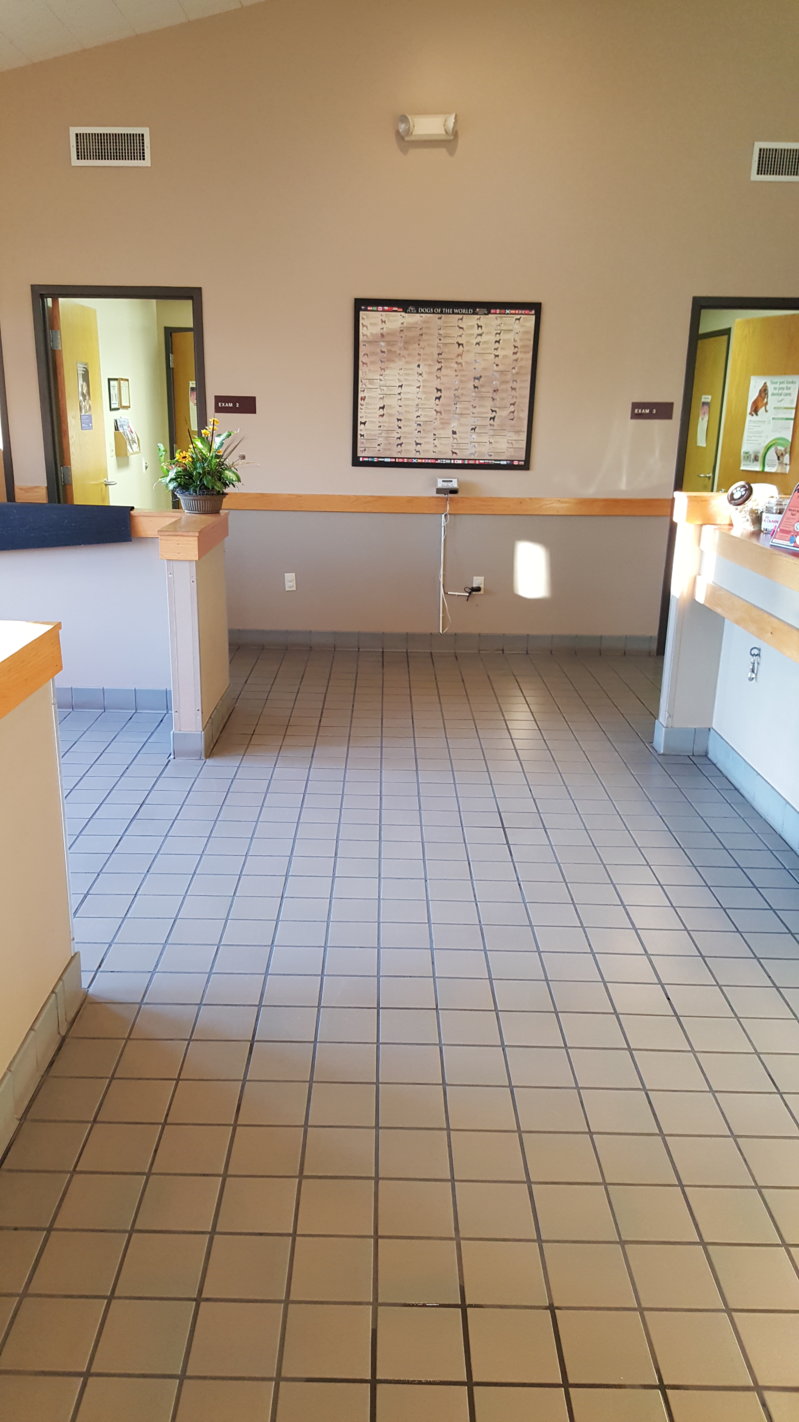

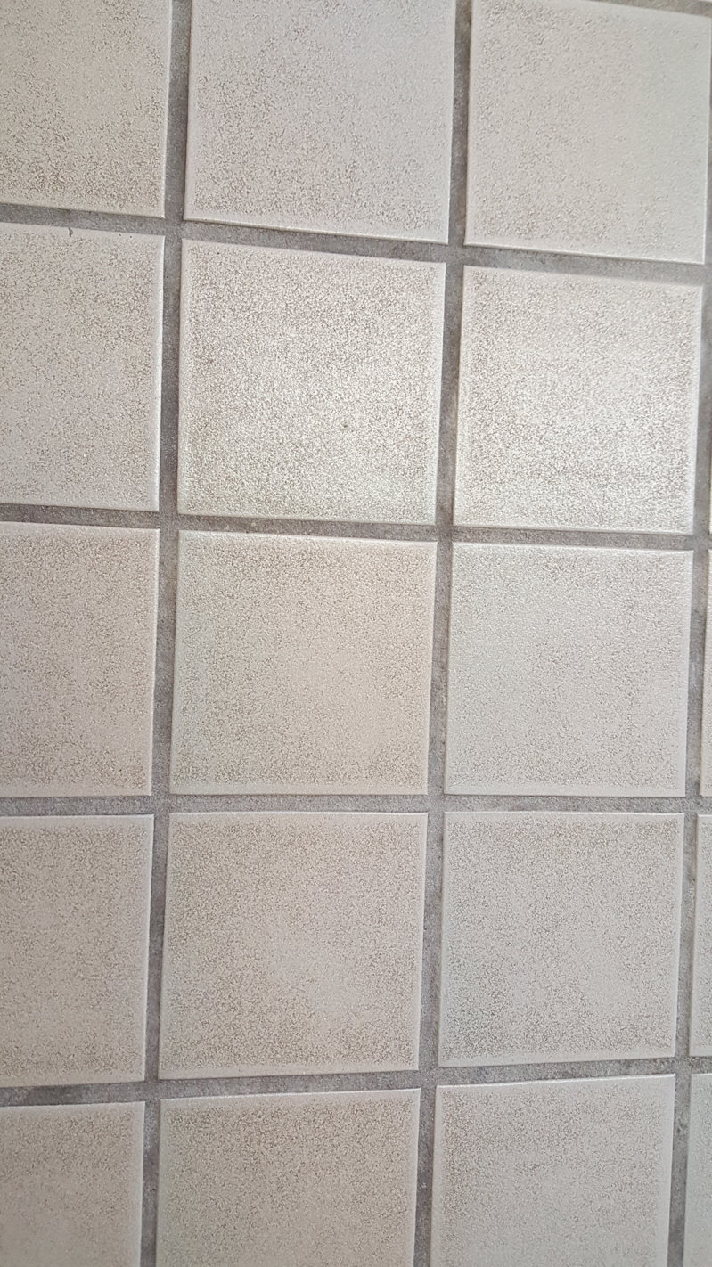

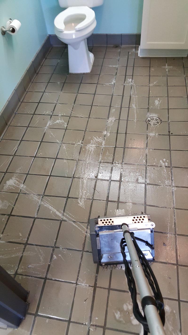

Mark Saiger
Veterinary office....

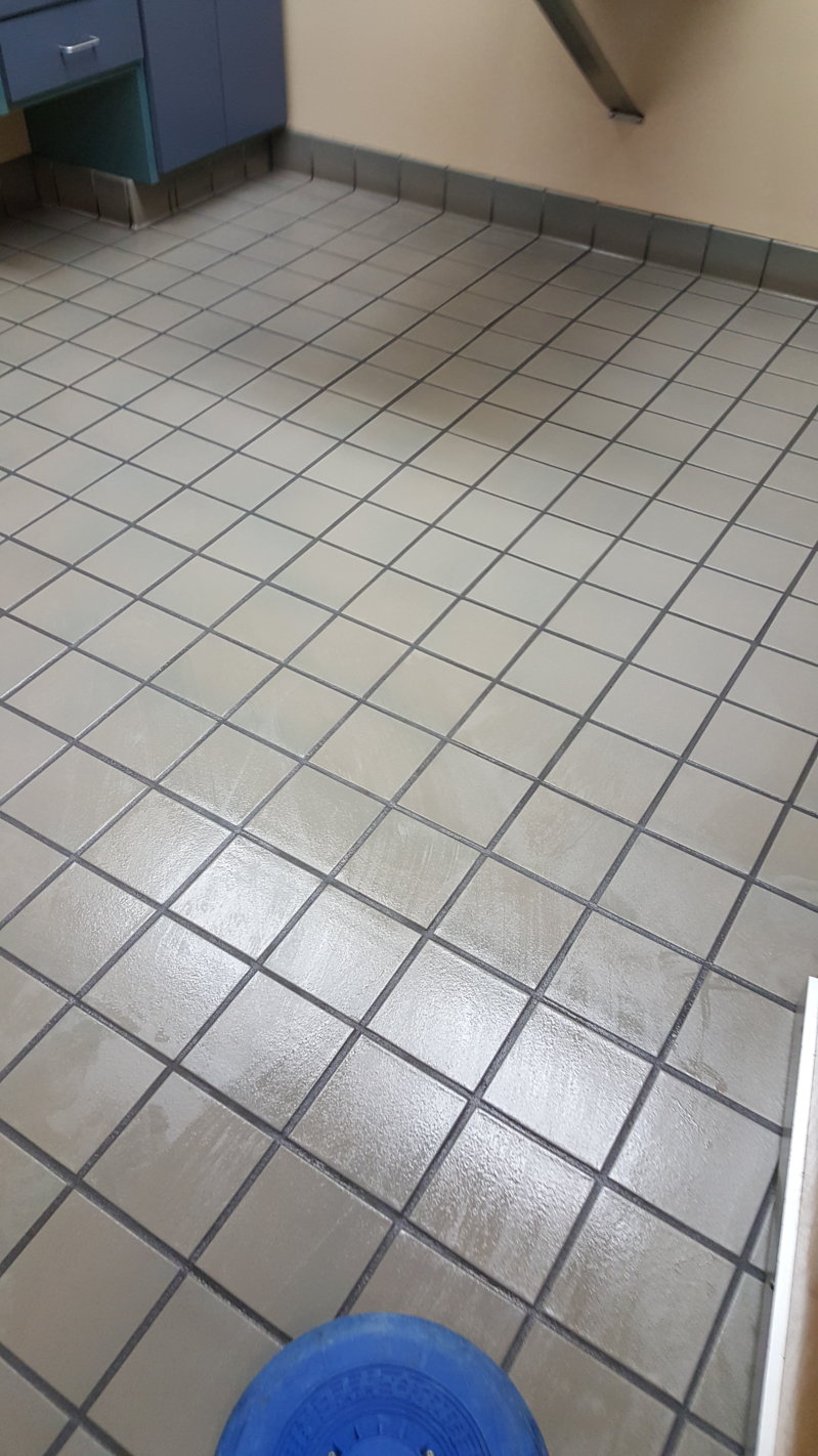

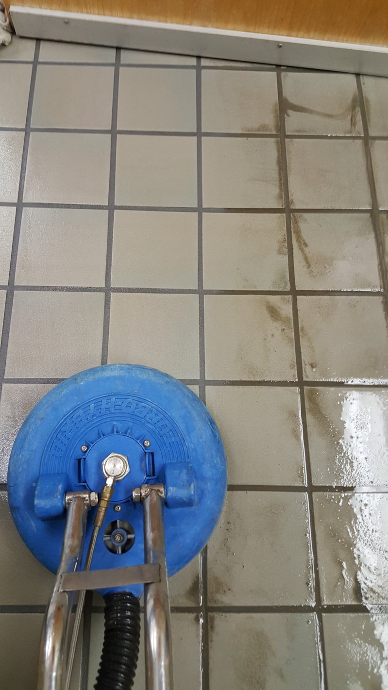

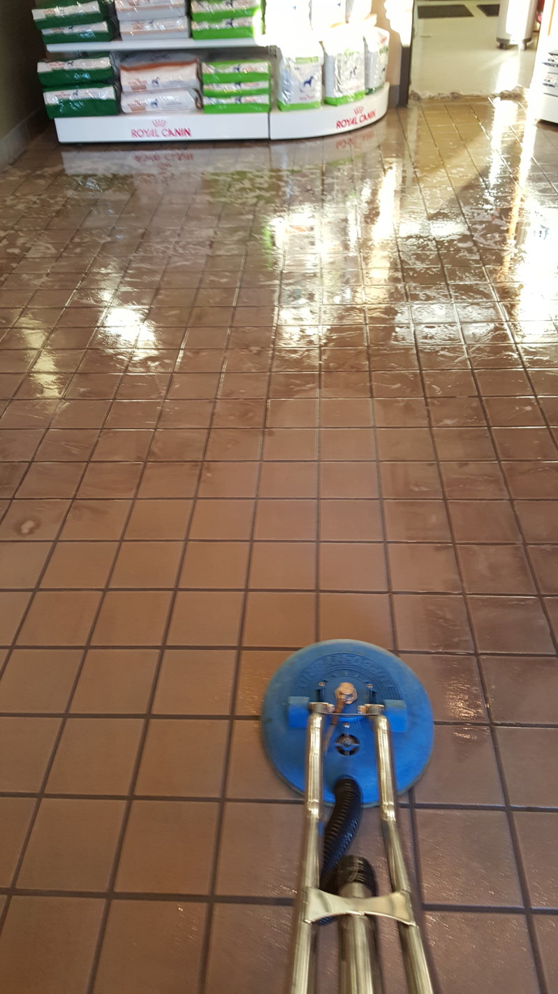

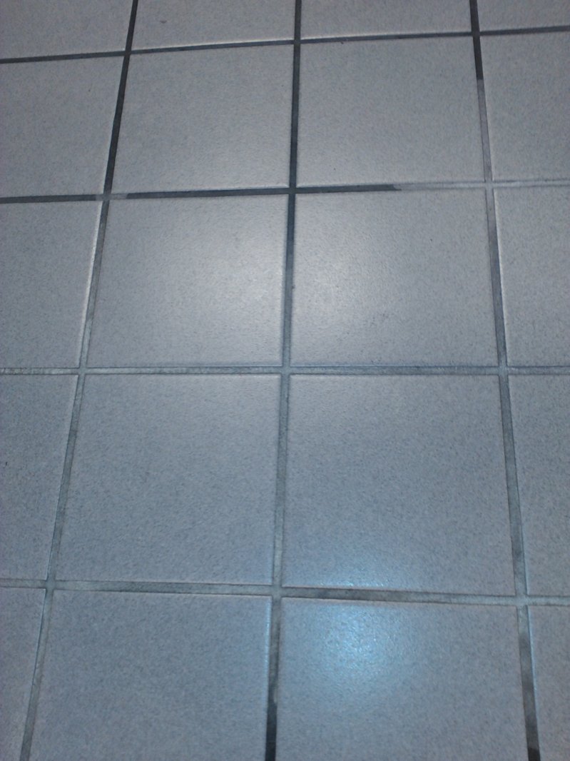

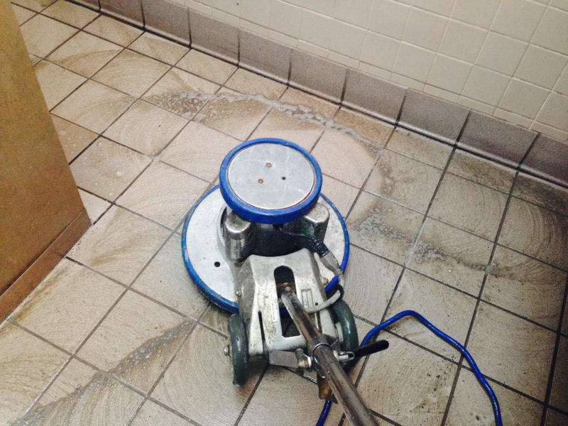

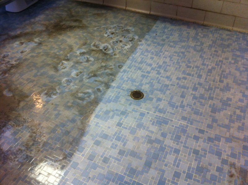

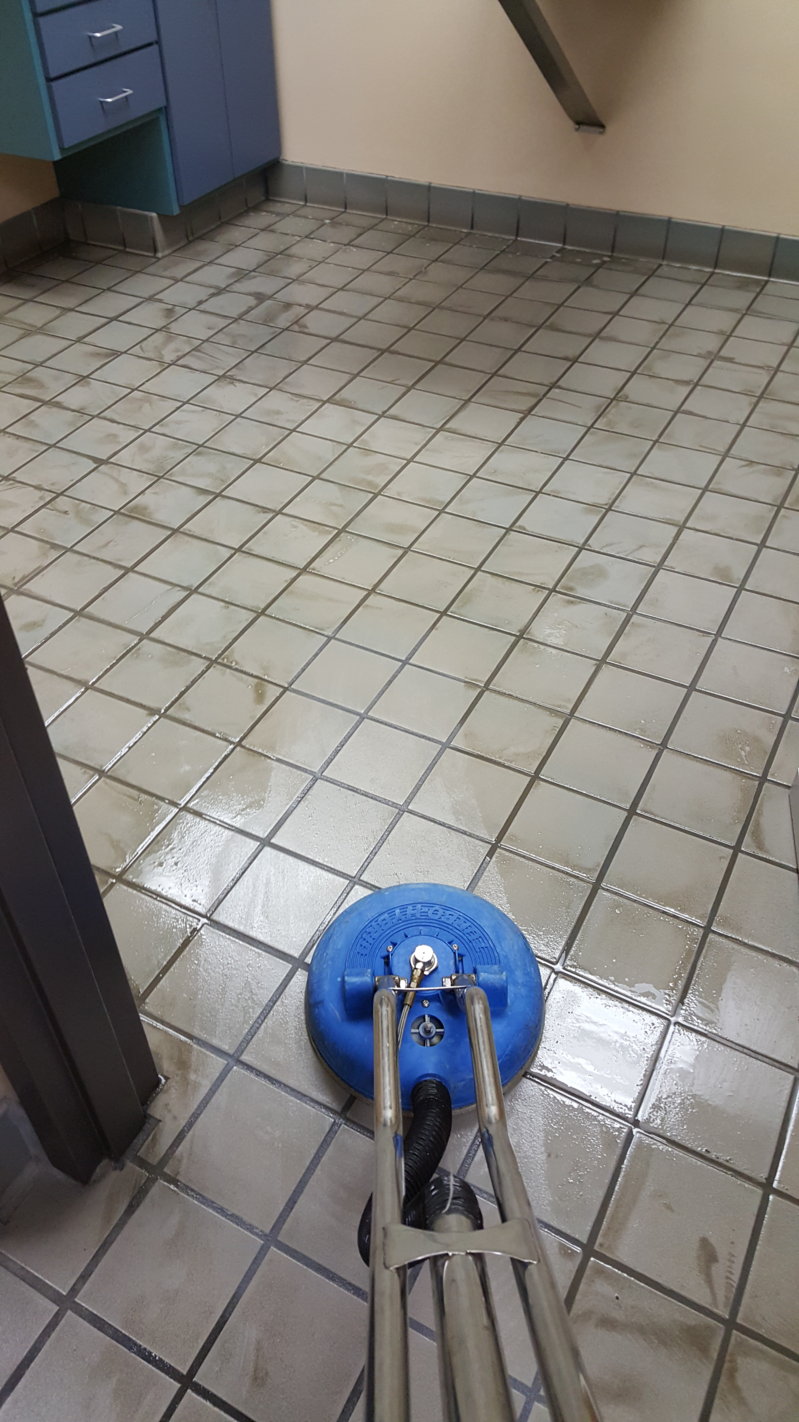

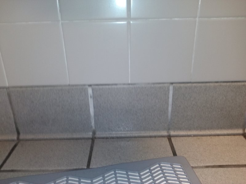

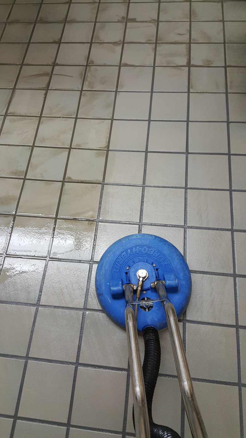

About 30 years old...never professionally cleaned.
Cleaning people using the same mop water going from the VCT to the Tile and Grout and getting wax transfer....
Actually went pretty good....
Interlink Supply Stainless Steel Grout Brush, Some Wax stripper, Saiger Sauce Boosted with the Powdered Citra Zov, my little 7 year old 10 inch CRB....and a good old push broom (I forgot my microfiber mop :hopeless:)
All worked out and got by with 800 psi on the spinner (which worked good with the Zipper SS Super Spinner too)
Dirty part close to my feet....cleaner part to the North...Last 3 pics were what it looked like before starting....

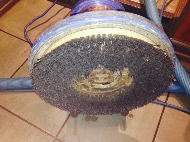

We use a grit brush on a 175. We do add 1/2 the amount of stripper that we use to strip VCT. We empty waste tank before starting such job, then empty at end of day and wash out all filters and inside of tank completely.
What grit do you like for a general grit brush 180? Thanks.

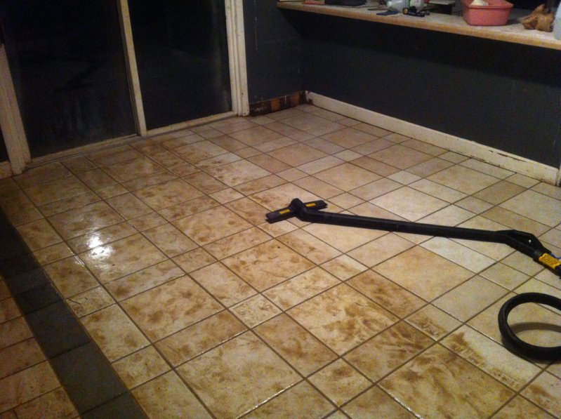

Stephanie Barber
Mark Saiger
Mr Happy!
Dec 26, 2006
11,199
Grand Rapids, MN
Mark Saiger

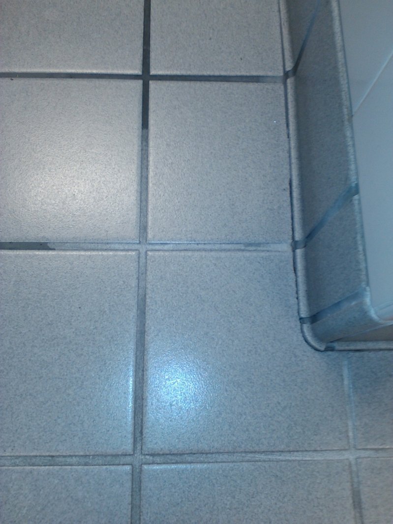

Hey there Stephanie,
Looking at the pics, it looks like there is mainly a lot of embedded soils in the grout.
Not sure what you are cleaning with right now, but it will take a good alkaline based cleaner and some scrubbing to maybe be able to get the soils out of the grout lines.
It might take some wax remover such as the Zep wax stripper mentioned...but you also see that wax stripper could be hard on certain equipment and precautions maybe needed to be taken.
Do you or the company y0u are doing the work at (this work place) supplying equipment and chems?
What are you using now for your cleaning? Are you also doing carpet cleaning there too?
Maybe with these questions answered, we might be able to help a bit more with some equipment and cleaning recommendations.
Those tile and grout squares look pretty similar to what I just cleaned.
With the correct products and tool, a bathroom might not take too long and you could probably make it work out to clean them up.
The Bleach you mentioned they insist on using is maybe to do a sanitize type cleaning, but with those soils still in the grout....there is still not much total sanitizing being accomplished, but it probably just makes them think it is sanitized....and that is their "feel good" feeling.
Removing the soils will help accomplish more of that clean and sanitized moment.
