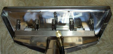

Question ? if a 13.5" Ti. wands needs 7 jets why is Cobb using 4 jets on a 14 wand? I remember Cobb suggesting 5 jets with a 14 wand. Now using 4??

Magician;
We have both a 14" 4-Jet and a 2" Tube 5-Jet (shown wo GG):
You can have it your way !
Both of them have more uniform angle-jet spacing than the Titanium.
Larry

um.....guys, one of the reasons I made the checkvalve/jet extenders was to correct the center gap issue, that in combination with 110 degree jets helps a lot, but don't think for a second on a filthy carpet you won't see a less than clean area dead center, it's a gap that simply does not get the same water flow, heat, and pressure as the rest of the wand. You will also see it on a commercial job where you come across a gum spot, human nature is to hit the spot dead center with the wand and melt it away, but you are actually better off with the Ti to hit it off center for maximum heat and pressure from the three jets on one side or the other...with a Greenhorn it loves a dead center gum spot.
