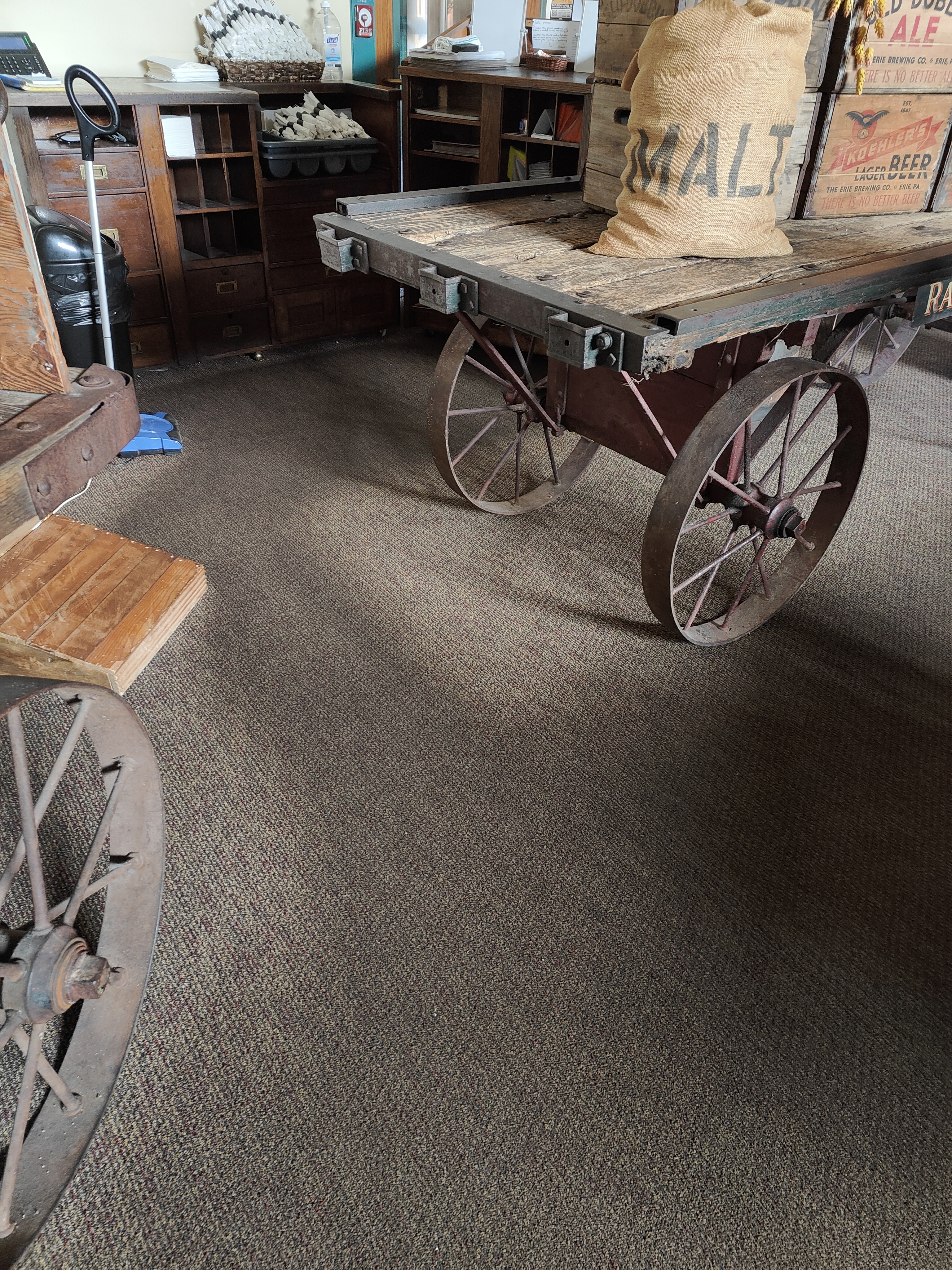

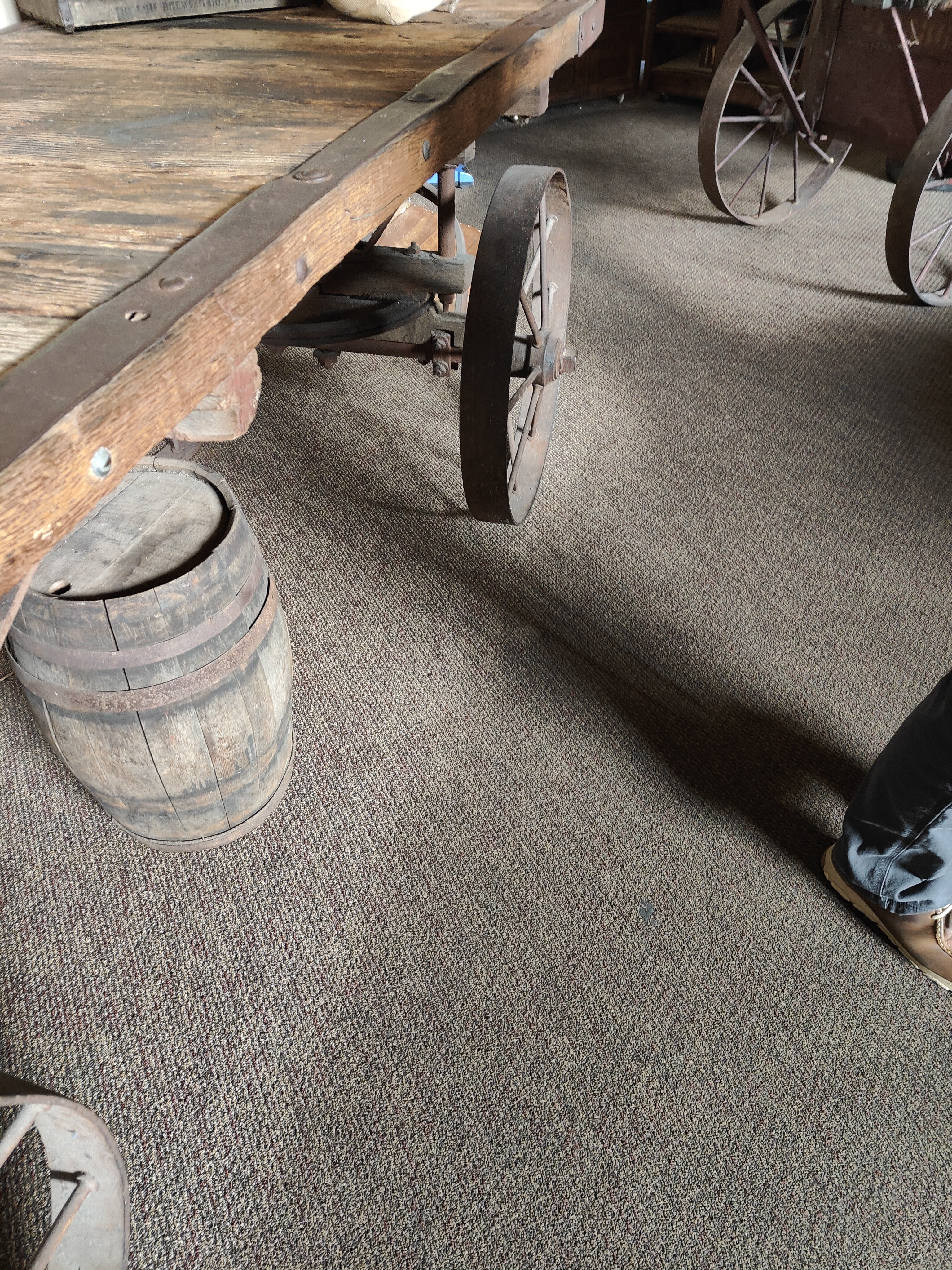

I usually do this large carpeted room every 6 months to a year, but during Covid they replaced just about the entire carpeted area's.
This is only 1.5 years old,
My TM and Zipper will take 3X longer and a lot of water.
Check out the pics, you can see how it's not even touched under a table and cart.
View attachment 121908 View attachment 121909
Cimex will do a great job as will a Phoenix or similar.

You should be fine hitting that carpet with your Cimex. I'd suggest Encap-Clean DS2 and FiberPlus Max pads.
You could also apply Encap-Punch as a pre-spray before you run over it with the Cimex.

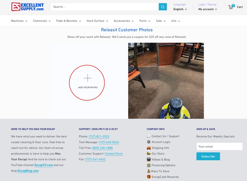

Be sure to take some before and after pictures.
You can submit pics on the bottom of the Excellent Supply website and get a $25 discount on Releasit.
