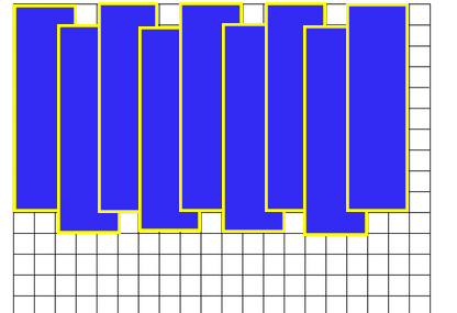

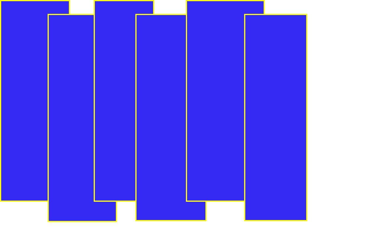

So that way assuming jets are all the same you double rinse two strips of 4" and leave a single rinsed 4" strip in the centre. Now that could make for a nice pattern, with uneven drying and wick'back:headscratch:

That doesn't make any sense at all. If we overlap by a third, the carpet gets flushed 3 times.
