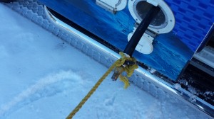

5) Tow strap….heavy rated…just in case someone can help you get out, or vice versa!

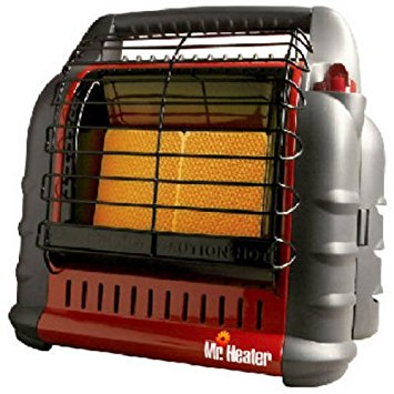

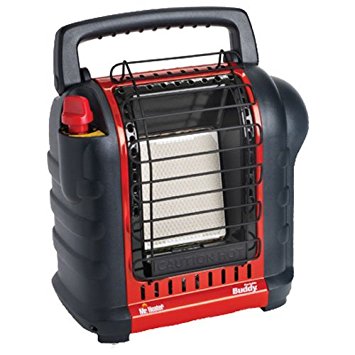

8) Portable heater that operates off small bottled propane containers….you never know. It might save you and your equipment. Cube vans, you have a big challenge so you might need more than one, two, three….units. Keep in mind that these units will require oxygen to operate, so you will need to have a bit of venting.

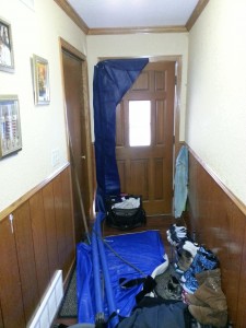

1) Get a door drape to keep the cold out and the heat in. People love that you are going the extra mile to protect their home.
A door drape in action
2) Floor tarps or coverings. We use canvas tarps with a poly coated tarp on top. Great moment of truth when you tarp your entire way into the cleaning areas. PS: Use them all the time and watch how people talk about how much care you took in their homes….and don’t forget the corner guards! Here is a link for some tarps you might look at:

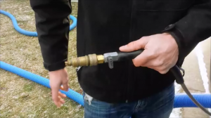

4) Build a spray connector for you high pressure hose to heat the hose before going into the home. Also have a female or male connector in your possession to keep water flowing in case you have to stop cleaning for a length of time.

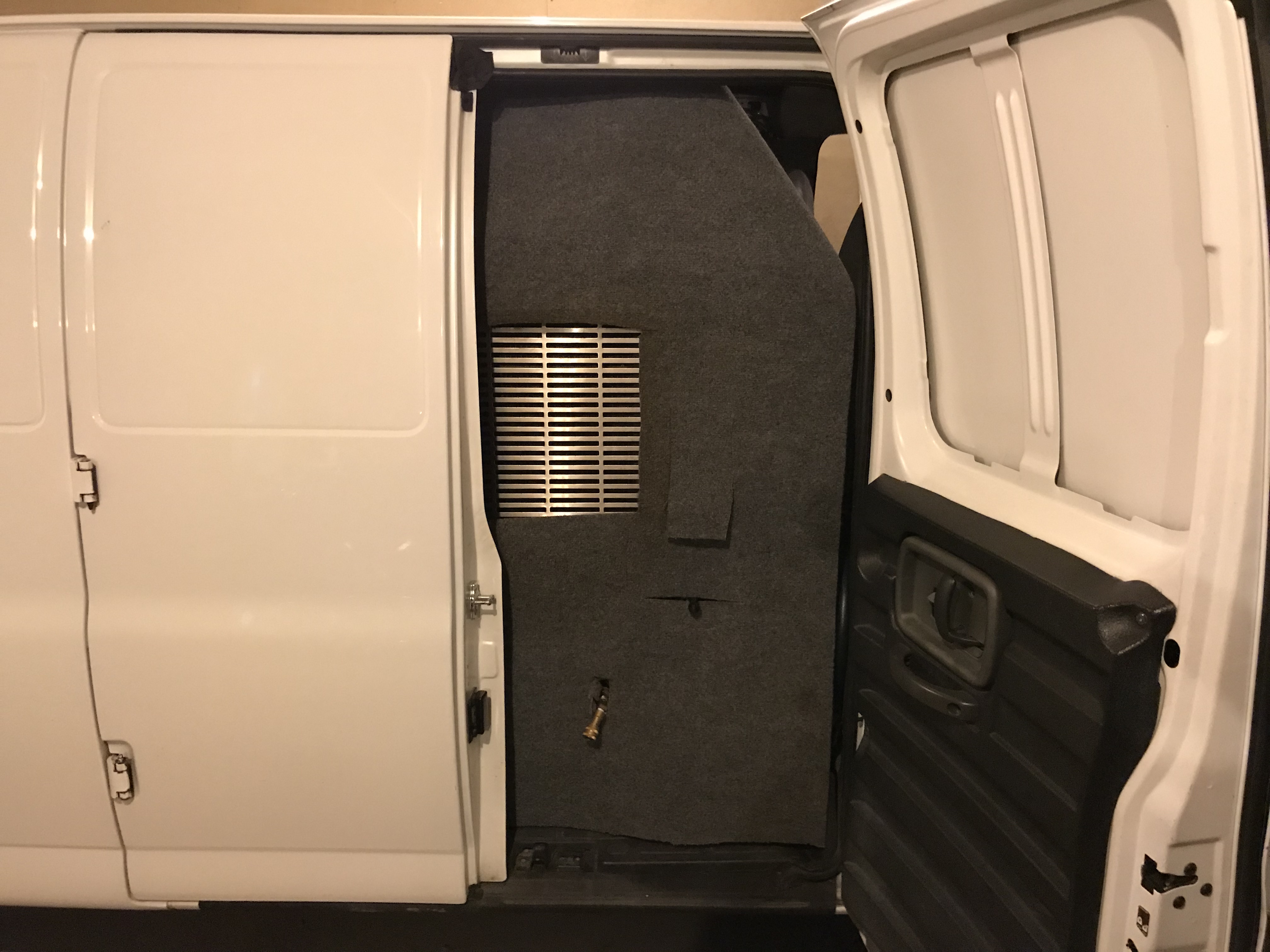

9) If you have a direct drive and have a protective cover lid such as our Butler Systems, we lift the lid so the cab can be heated by the heat exchanger. Those of you with slide ins, will also be able to take advantage of the running items in the cab to help heat. Direct drives can have a bit of advantage in cold weather cleaning. With a slide in, you need air to be able to help run the motor. Plan your venting via a window or roof vent with the least amount of heat loss is very important. I have cleaned with both types of units (direct drive and slide ins). I have found the direct drives easier, but again…figure out HOW TO THRIVE in what mother nature is presenting too you.

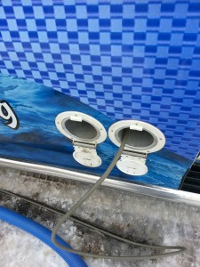

10) Add access port holes to your van so doors can remain closed and hoses can get to the job. If you are running lager hose such as 2.5 inch, you will need to access holes. There are other options for hose ports, but here is a link to the Butler units which I am most familiar with and really pleased with. http://www.butlersystem.com/pop_second-hose-guide-and-security-door.html

11) HEAT UP THAT HIGH PRESSURE LINE and run to the door. Get hooked up for prespraying or to begin cleaning. If you are cleaning alone and feel that your high pressure hose could freeze up while agitating or moving furniture, put a male or female end (depending on your particular set up) on the high pressure hose, get some water flowing while it is stuffed into the vac hose. In most cases, you will not need this unless you are cleaning in -50 degrees below zero (and yes I have cleaned in this!)
Sprayer end for high pressure hose​

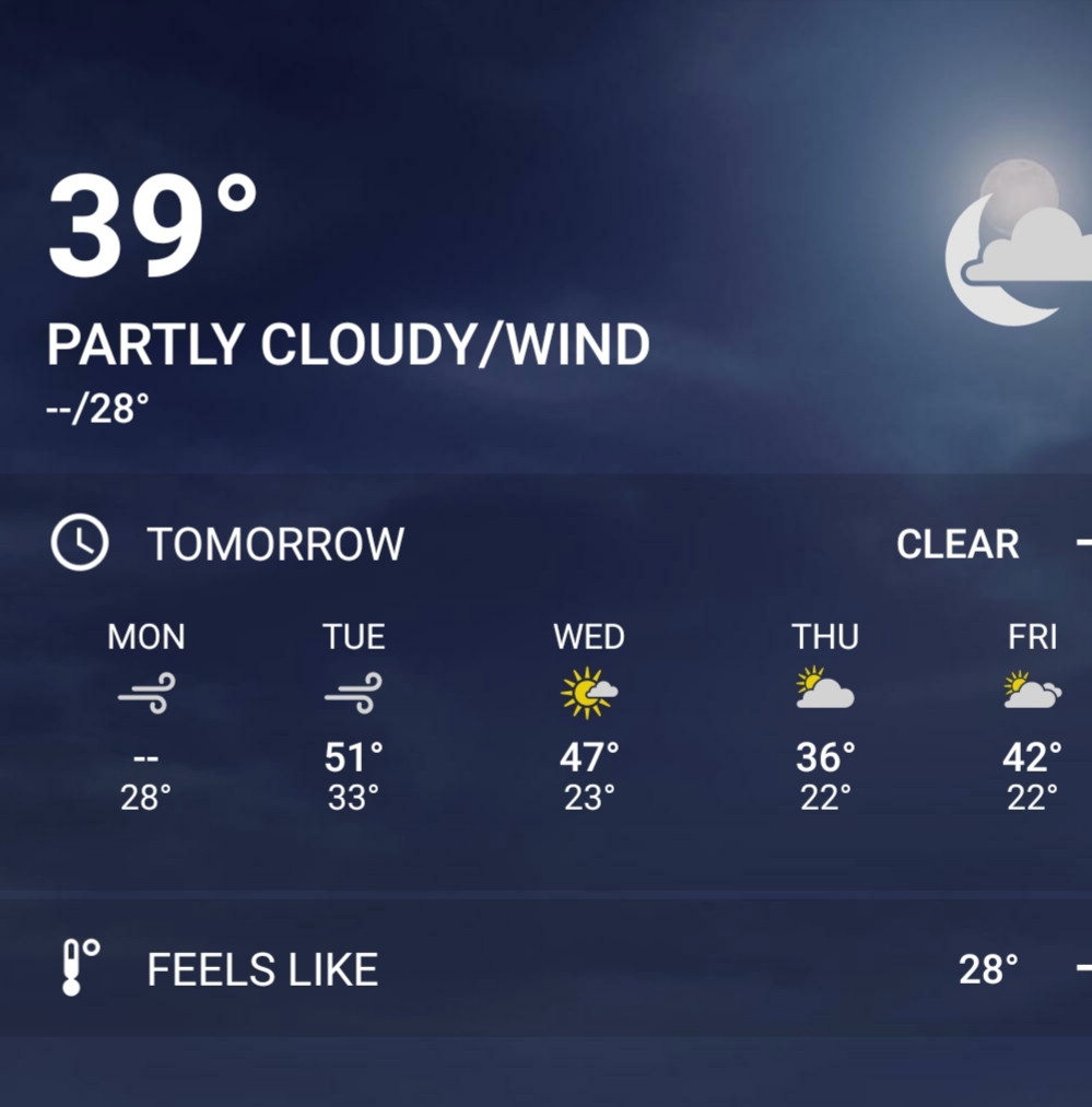

9 degrees above zero here this morning....
It rained yesterday and thunder snow....been a longtime since I have heard or seen that ...
We were supposed to get a bunch of snow....just got cold and wet....and WIND!

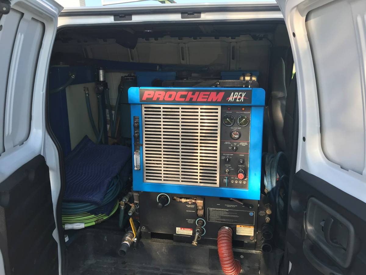

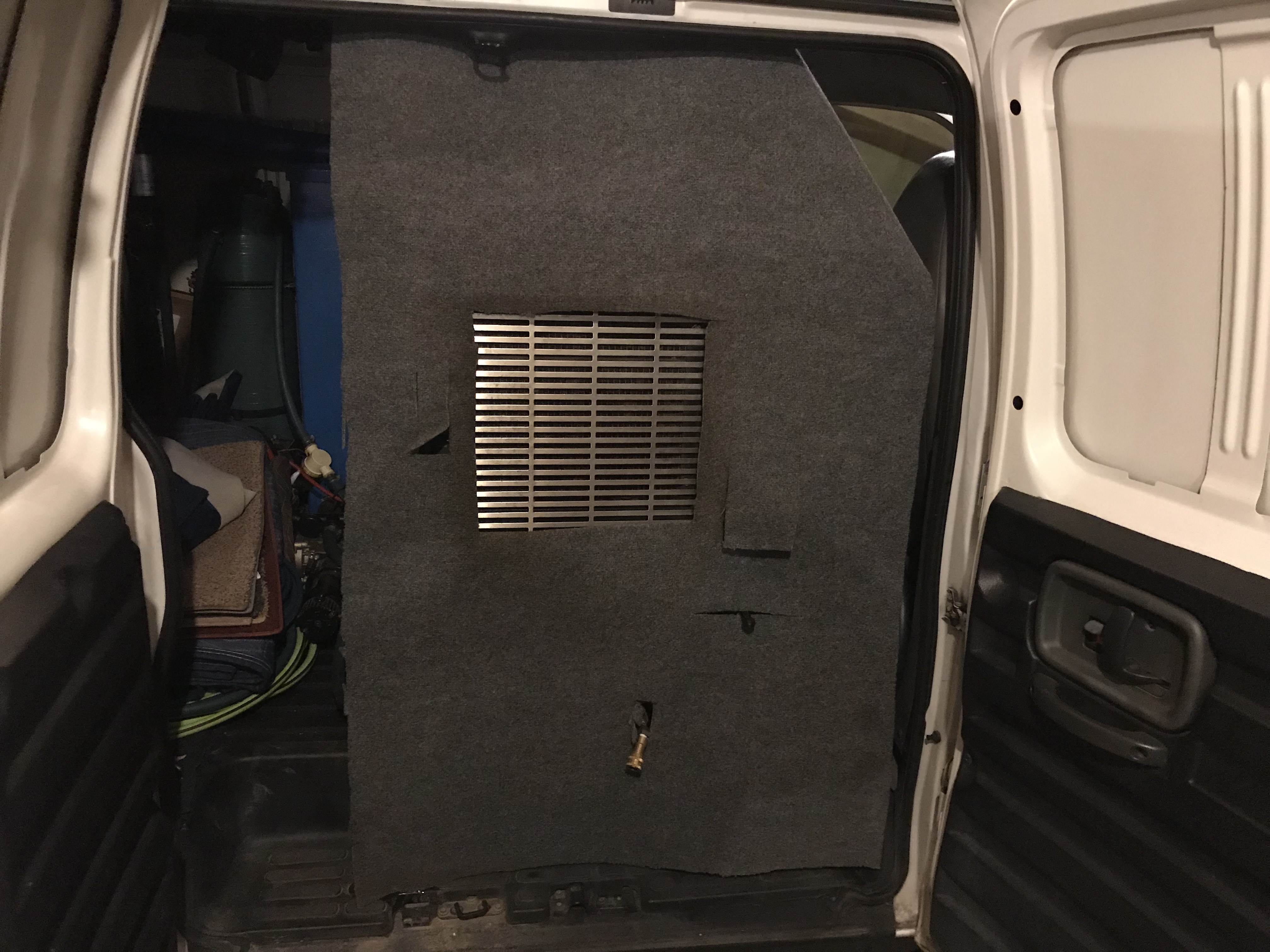

this was the door drape I used on my Apex. Still have to make one for my new Titan 575. Covers everything except radiator. cuts are made for easy access to panels. Van stays toasty warm. Never needed an ice scraper. Never insulated a van either. Only dont go out if its 10 below zero or under or if schools are closed.00q0q_6vAgTj3RPxf_1200x900.jpgIMG_0778.jpgIMG_0780.jpg
