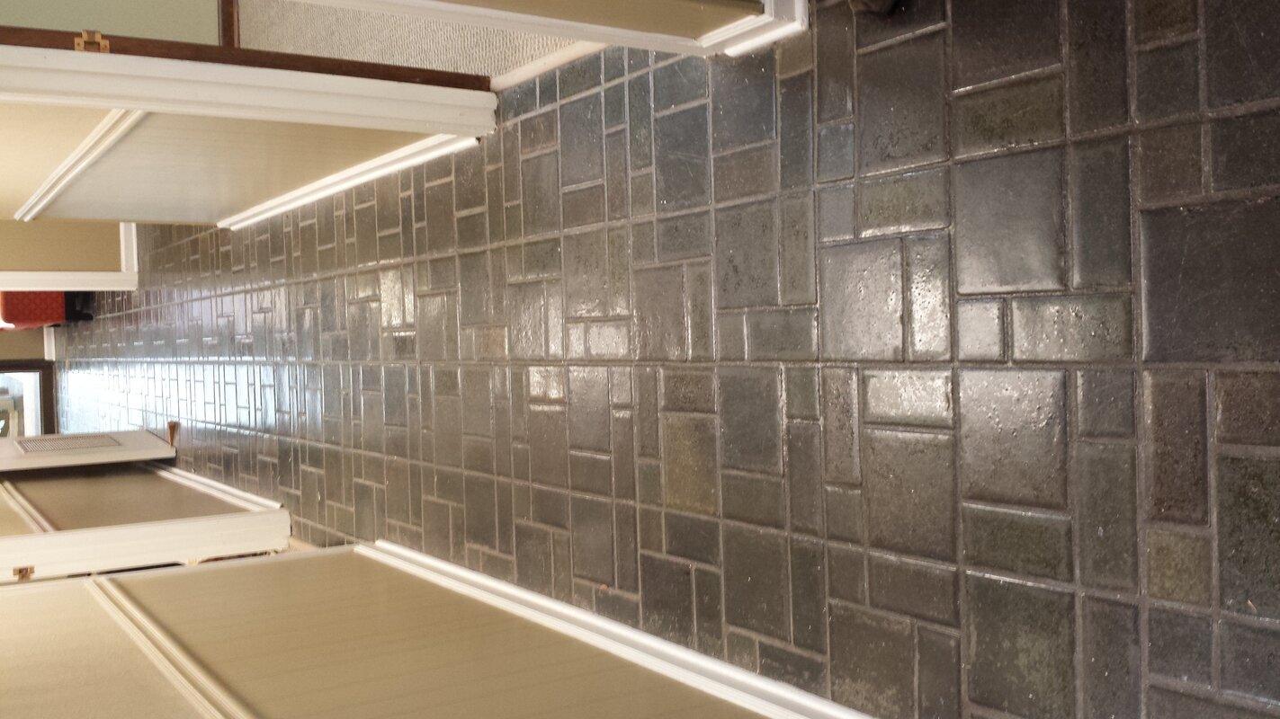

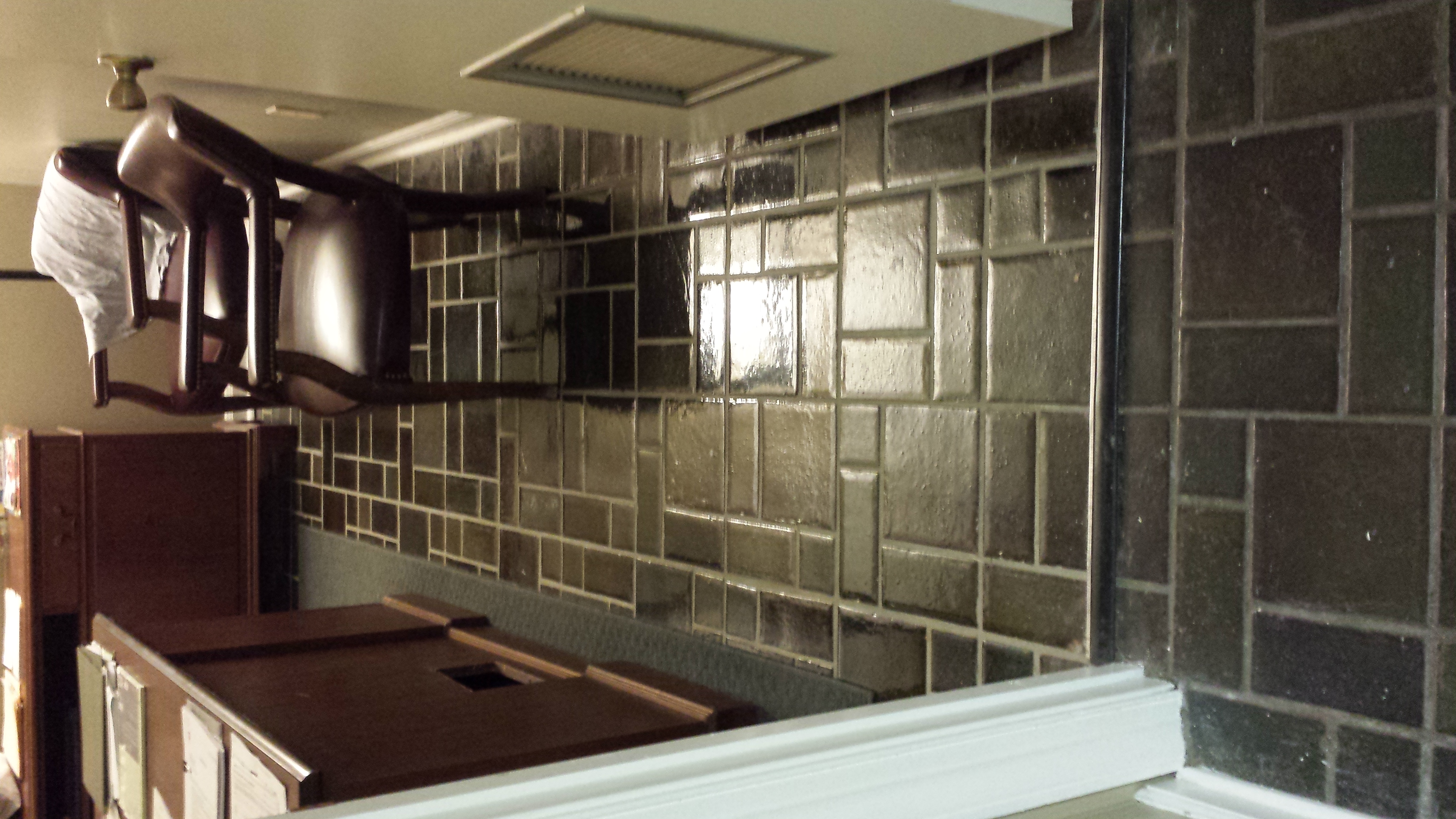

I guess I didn't do something right but that is the floor. As you can tell the floor has a lot of buildup and a hacked out attempt at stripping it years ago with finish applied to the top
The fact that you are talking about Enhancers for that floor tell me you should pass.
Go fishing instead.

Can't tell in the photos but the grout is shiny, right?
Any chance that is Glaze and Seal or it's equivalent on those tiles? Sure is lumpy and full of crud.
is it that slow there right now? is this your parents house? part of a much bigger job? hot home owner?
What testing have you done so far?
Sep 7, 2008
3,797
Yes but very spotty. It looks like it was stripped but poorly done years ago and then finish mopped on. In the first pic the office had carpet over it for years so it is in great shape. When they pulled the carpet up they mopped finish on it. Looks awesome with the finish on it. I haven't done any testing, but I can test clean. I am going to do a small area and see what happens. My opinion is the floor will be hard to strip. I guess that is why I need to do a test clean.

That's a job. Comes of the tile with the 175 and grit brush. The grout is a whole different story. I will no longer put coatings on tile other than vct. They just blame you later when it looks like crap and is scratched up. If they want shiny then buy shiny tile or get out your visa and buy some stone. Don't fall for it. Go fishing like mike said.

Thats ceramic or porcelain tile. Not made for gloss shine sealer.

Its a brick floor....and is VERY porus. which holds the shit like crazy And will be a bitch to strip....and thats putting it nicely...
Odds are it has either LOTS of coats of finish or a urethane or both..... It will make a aweful sloppy mess, and take about 5 days to do
Looking at the pic of the hall...it appears what ever was put on top, is not bonding with the bottom coat.....
which means 1 of 2 things
Crappy strip job and rinse, like you said
or
different products used for sealer.....and not bonding....
just walk

I would just grab a spray bottle, brush and go test a couple sqr's out.
Sometimes finish comes right off, usually it is a hard job but ya never know.

Doug it's not brick. I offered to do a test clean for 300 dollars in the entry way about 125 sq ft. My supplier was right on without even looking at the floor saying cost should be around 5 dollars per sq ft. I won't be doing the job though at least not anytime soon. I think the owner is going to attempt to do it himself with a mop bucket and a floor buffer. I know it will never look like the room that was covered in carpet for years unless they put a lot of man hours in the job themselves or pay a decent price to get it done.
