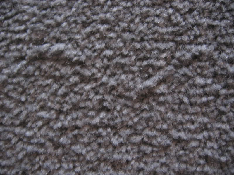

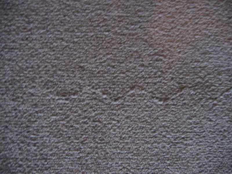

Cleaned a house last week and came across this strange squiggly line in a bedroom carpet. Can't offer to much detail other than its obviously a cut pile and appeared to repeat itself about 6' away. Had really poor lighting in the room so I couldn't see if it went wall to wall.
Anyone know the meaning of it? Aliens? Kinda makes me think of crop circles.

Sounds like a question for a carpet inspector? Sorry I can't be of more assistance other than to say call Dale Collins... If he says it's aliens I'll refer you to Dwayne Oxley...
joe harper
Oct 21, 2008
4,993
florida
joe harper
Looks to me ....that the installer used a serpentine straight edge...
Did the pattern...span the length of the room..?
What was the size of the room..?
Possibly a tufting defect from the mill..?
Hard to tell from the photo.....was there a room partition divider ...leaving a depression..?
TERRIBLE.."blossoming" of the fibers...was is a poly or olefin..!!

Hard to tell from photo...BUT..It looks to be a cheap "Berber"..not a cut pile..?
Looks to be a worn..olefin...many installer used the "Serpentine" to hide the seams
the rows were so far off in some goods..it was impossible to hide the seam.. :roll:

not a serpentine straight edge too sharp of angles mine is much more rounded edge
i think its a flaw from mill looks familiar i think ive seen it before machine may have skipped some
i used to use a serpentine with blotchy sculptered carpet like we used to put in trailers alot the blotches didnt have a pattern so if you straight edged a seam and a black blotch came against a white -ouch! so we had to serpentine

Guys...."Blow-Up"..the photo...That is a continuous filament olefin yarn...It is a BERBER..!
Surely...someone did NOT...remove the salvage edge...prior to installing... :shock:
Looks like a tufting issue... :!:

Jim, that's a high line and you can probably confirm it by seeing if the line is in the lengthwise direction.
This occurs when one tufting needle has been improperly set & comes up too high. It can be sheared down to make it look just fine.
Sometimes this can also occur when a repair is done at the mill with a tufting gun.
Here is an example of one that I saw on an Inspection.

Thanks Tony, just about looks like the same piece of carpet. The rest of the guys seemed to be running in the crop circle direction :)

I belive Harry has nailed this one. A high line was also my first thought. Many tufting machines use a step-over or zig-zag pattern. So, a single needle inserting a single yarn moves back and forth in that pattern.

The technical term for that defect is chicken tracks. All of the above are correct on how it occured. I have also been an inspector since 95

This mill defect is corrected in about 10 min with hand shears, and "the mIll has a right to repair". I've clipped many of them. Why not tell the consumer to send the mill a picture, and make a settlment. No Inspector needed, and $$.

Just to clarify, this is a manufacturing flaw. The cutting machine at the retailer didn't the cause the problem, and the store isn't required to inspect carpet.

I' with Joe, looks to me like a factory edje. Self installed.
